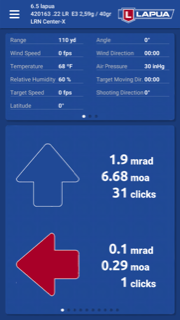

Oh, ok.. That is not a go to for me. It is really clunky to use. But I download it for my 22LR Center X, but only out to 100 with mil. I never payed attention to the "clicks" But it only looks correct in mrad.
Mrad
What I see is something like this "if" I switch the unites to Under <Sight Correction> to "in/100yd".
Inches

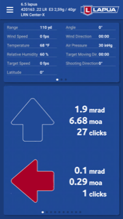

Mind you I am not sure what you are seeing, weirdly the app will show 27 clicks for the MOA setting and 31 for the inches. 31 X .25" per click 1/4"@100 = 7.75 conversely, 27 x .26175" per click (MOA)@100 = 7.06725 but this is if I have .25 MOA selected in rifle..
MOA
Again, I hardly ever use this app, because it has a very weird interface, but something looks wrong as you mentioned.. Long story short either we have an input jacked, misunderstanding the out put or it is messed up.
So I too am am waiting for the smarter guys to figure out what was did wrong..

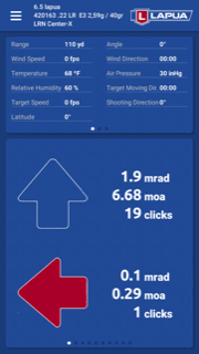

Divers pix I think has the answer your looking for.
Between moa and inches screen the clicks seem appropriate.
What has not changed is the moa drop.
The app is giving the mrad and moa as a reference and calculated the clicks of your scope.
Doesn't matter just dial in the clicks and squeeze.
If your scope is 1/4” per click, set your app Settings to “in/100yd” for Elevation and Windage.
Additionally, edit your Rifle/Cartridge data and enter “0.25” for Elevation and Windage click value. While entering data on click value confirm this screen shows grayed out units are set to “in/100yd.”
Your app should now show how many mils, MOA, and number of clicks needed to make the correction using your indicated scope system (in your case, number of 1/4” clicks).
