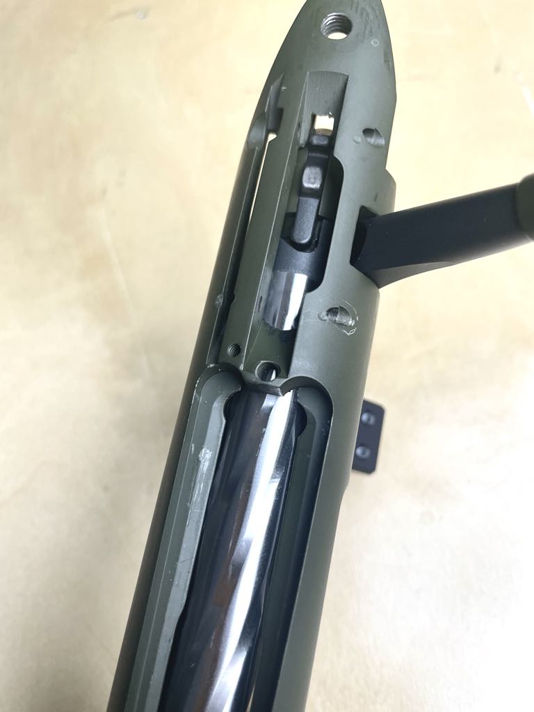

Can you share pictures of specifically what needs to be machined to accept the hunter DBM?
I’d rather know exactly what I’m getting into before purchasing one.

There is a small bump at the rear of some actions. This is a R700 that has had it removed and cerakoted. If the bottom and or magazine hangs up in the rear, this is normally the area. Not a big issue to have it removed.

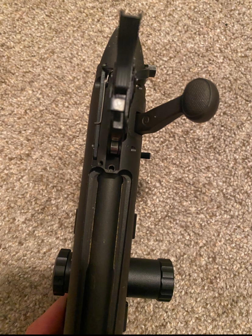

Here’s a picture of my 700ADL 30-06 action. It looks the same as the one you showed.
Looks to be the same, and wouldn’t need any machining, correct?
