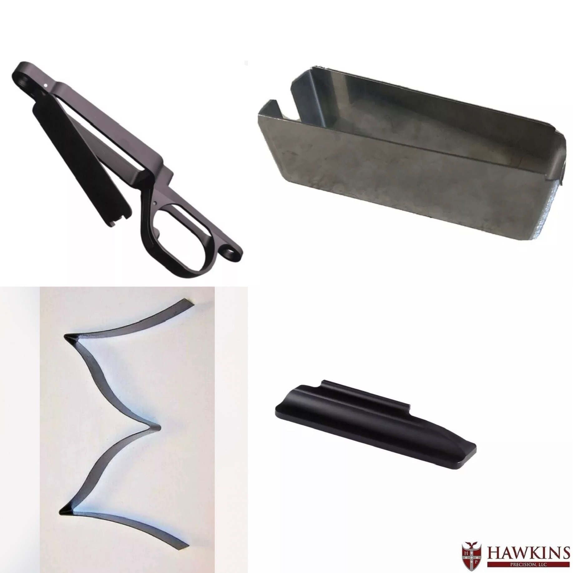

Hawkins Precision is proud to announce the release of our Long Action Hunter DBM and Long Action Flush Hunter Magazine.
The Hunter Detachable Box Magazine (DBM) bottom metal is designed for shooters that are looking for a flush bottom metal that will accept flush magazines. The bottom metal features a patented cantilever spring mag release system that will not open under heavy recoil. The magazine release is also adjustable, sleek and all but impossible to actuate accidentally.
https://hawkinsprecision.com/pro.../hunter-dbm-bottom-metal/
The flush magazines are specifically designed to be used in our LA Hunter DBM and give shooters additional space for a longer COAL of 3.770".
https://hawkinsprecision.com/product/hunter-magazine/
The first two magazines available are for the 300 PRC/28 Nosler, and 300NM / 338 Lapua. Hawkins Flush Hunter DBM will not work with CIP length AICS, MDT, or Accurate magazines, so be sure to pair it with a flush magazine!
Dealers and Individuals - Contact [email protected] for more information about ordering. Hunter DBMs and Magazines are available now through several dealers as well!

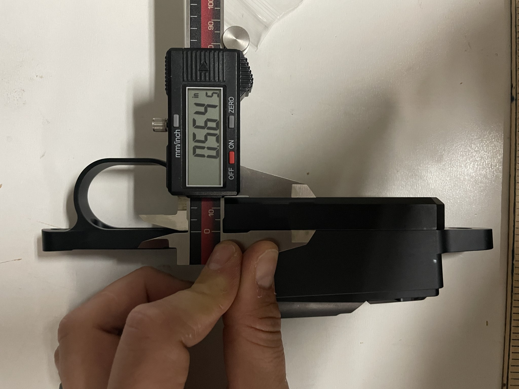

I have been begging Hawkins for years for these it seems like. I received a half dozen in the first production. Yesterday was the first chance I got to sit down and really evaluate them.
The bottom line is these are phenomenal.
Bottom Metal + Magazine weighs 6.5 ounces. Hawkins BDL + Wyatt's Mag/Follower/Spring weighs 5.0 ounces. Hawkins M5 + CIP length Accurate Mag 5 rd mag weighs 13.5 ounces.
There is ZERO rattling with the magazine. The fit to the bottom metal is really solid.
At first, I was disappointed that an AICS pattern magazine wouldn't fit. After inspecting these magazines I've decided I'm really glad they don't. The reason why is because the 300 PRC magazine sits about 1/4" or less low of the stock. This, along with zero noise/rattling is way more important for the majority of my applications than the ability to run an AICS magazine. The 300 norma magazine sits about a 1/2" low.
I tested the 300 PRC magazine in a non-barreled action & stock with a variety of calibers. 28 Nosler has plenty of room for 28 Nosler seating 195's near the lands. I had perhaps .150" or so of magazine room left.
A factory 300 WSM cartridge feeds great out of these mags. This is gonna be really nice for those SAUM/WSM rifle in long actions with long heavy bullets.
Belted cartridge of any size will not work.
Standard base diamter size cartridges, like 270 or 6.5-284 can fit 4 in the mag- but will experience feed issues without modifications to the feed lips on the mag. Not sure how the end user would do this, but I may play with a few things.
Extremely happy with these. And if I or a customer wants to run an AICS mag, simply swapping out bottom metal is easy enough to make the proprietary magazine well worth it.
These mags are the best of all worlds for a hunting rig, in my opinion. You get a center feed design so the absolute best for reliability & feeding, less moving parts than a BDL magazine system and far less tuning, which can be a pain at times with the ultra mag size cartridges out of a BDL box magazine, particularly if the feed lips aren't quite right. Plus, there is very little increase in weight over the BDL system.
The one tuning item end user may want to do would be to relieve some spring pressure. Do this by taking the mag apart & grinding off a small corner at each of the 3 bends of the spring. A little bit goes a long ways. 1/16th of an inch made the magazine a little easier to load & doesn't apply quite as much pressure on the case body during feeding. I wonder if you could accomplish a similar result by leaving a mag loaded for extended duration. I will test that out.
Either way, thank you guys very much. Very happy with the M5 Hunter system here.

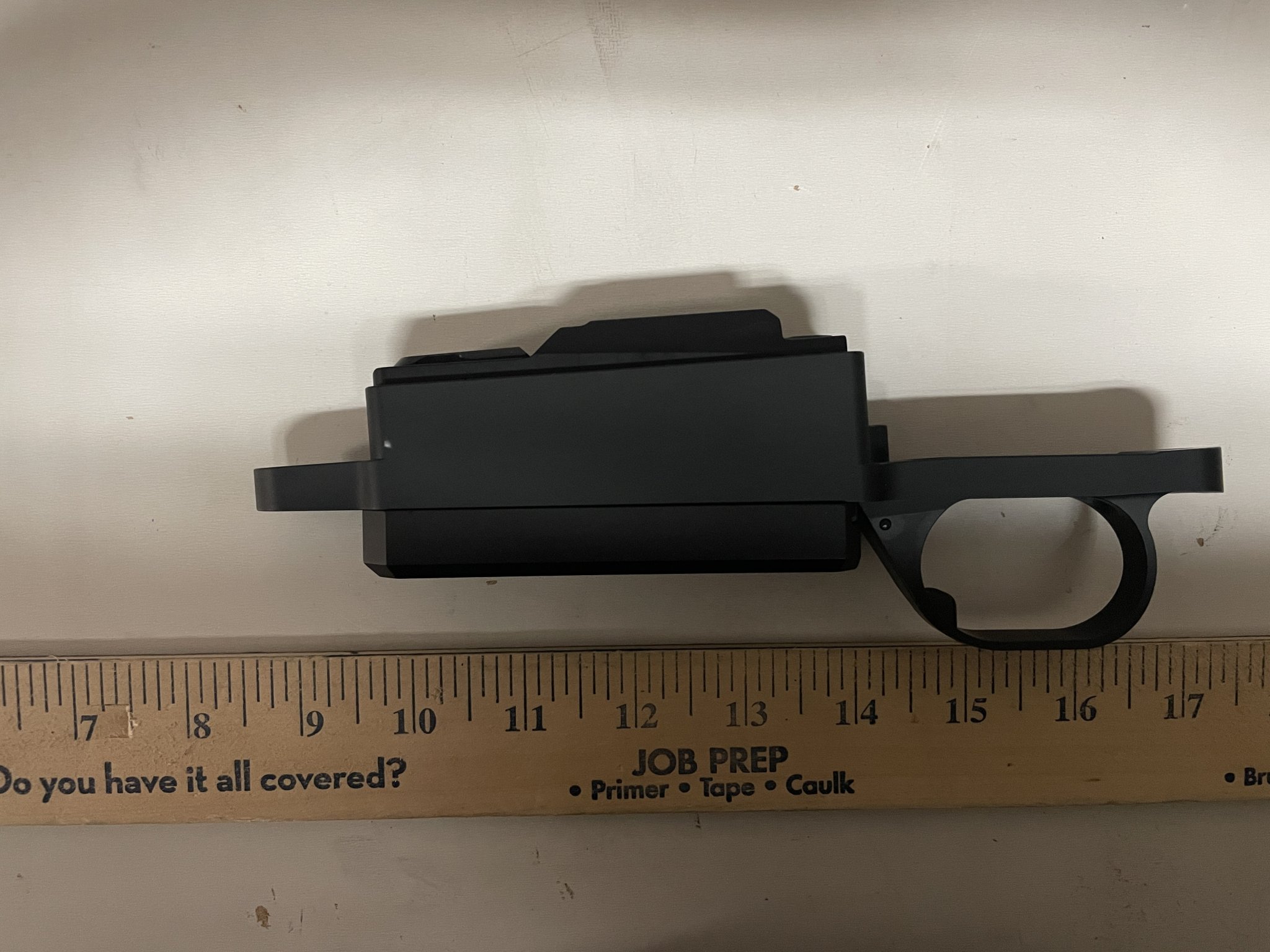

First batch is coming off machines. Medium length Hunter DBM, Flush Mags, M5 DBM and M5 Oberndorfs. Look for a more official announcement with specs soon.
That’s awesome news! I can’t wait for specifications/details on the mag lengths. Hopefully these magazines will support the various cartridges such as SAUMs/PRCs/etc.

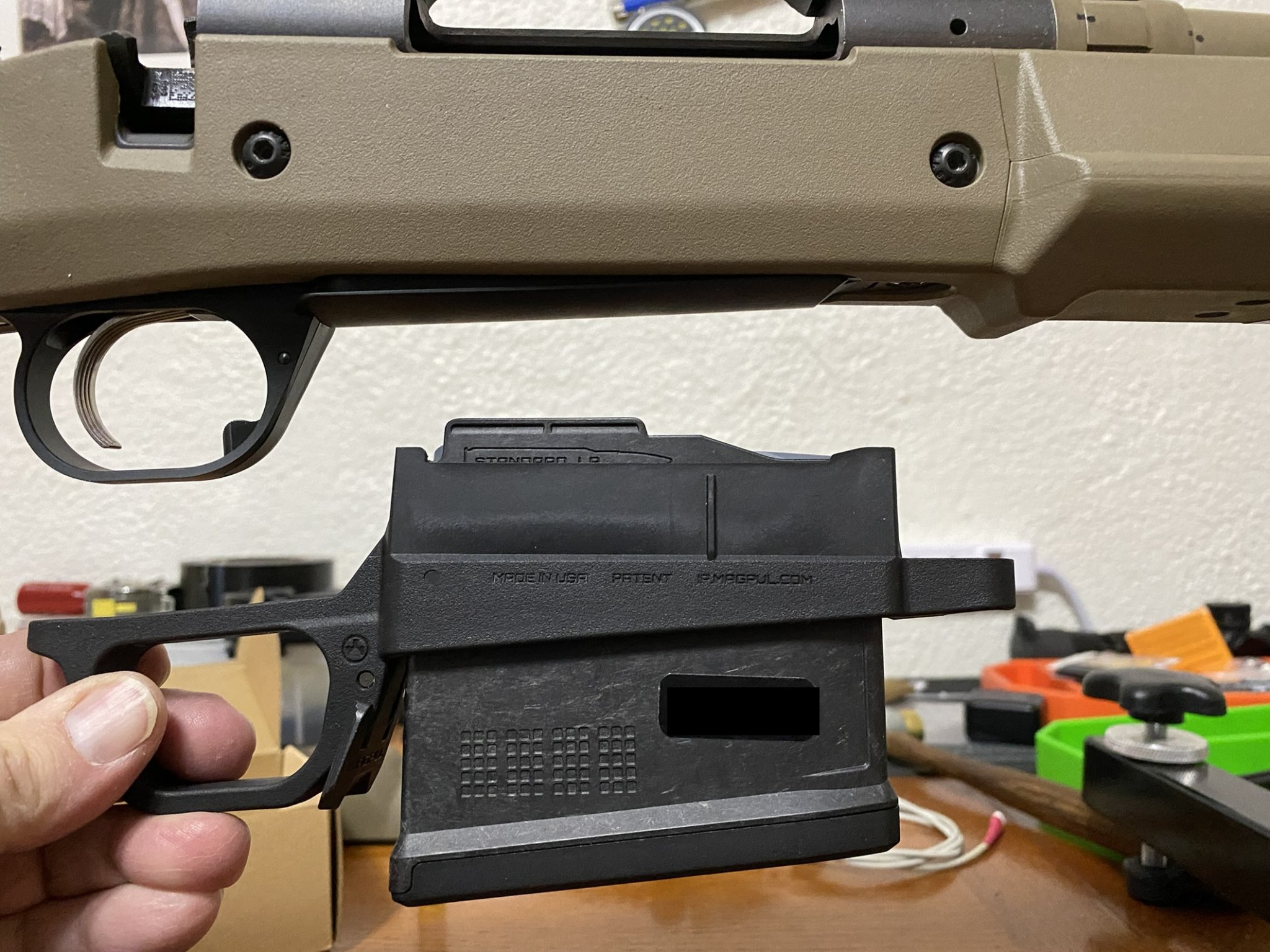

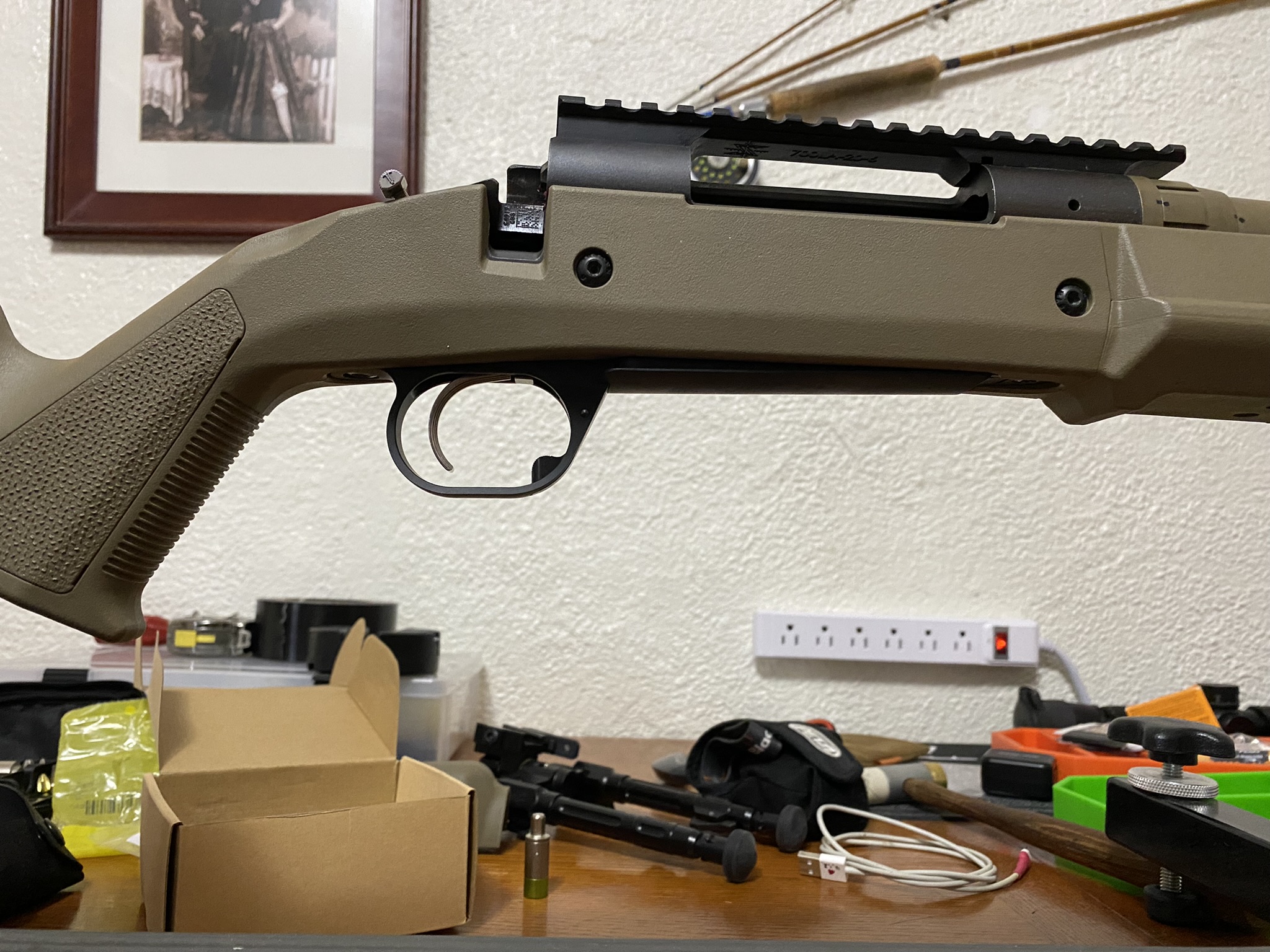

Just got my Bottom Metal and 300NM Hunter Magazine. While they are certainly top notch and high quality, as you said they are certainly not a “flush fit” magazine. The edges are much nicer to hold than that of an AICS mag and the additional 20 tho of bullet seating is great, so I’ll stick with them. But if someone wants something actually “flush” in long action, should stick with the Hawkins BDL.
Reactions: st1650
Pics?
Or the MDT plastic 3 round aics for SA. Its absolutely flush and 100$ cheaper.
Honestly had I known what I know now I would have saved my money and went with the MDT. Had nothing but issues with my Hawkins SA 4rnd AICS hunter. And it was with 6.5 creed ... hardly a cartridge difficult to feed...

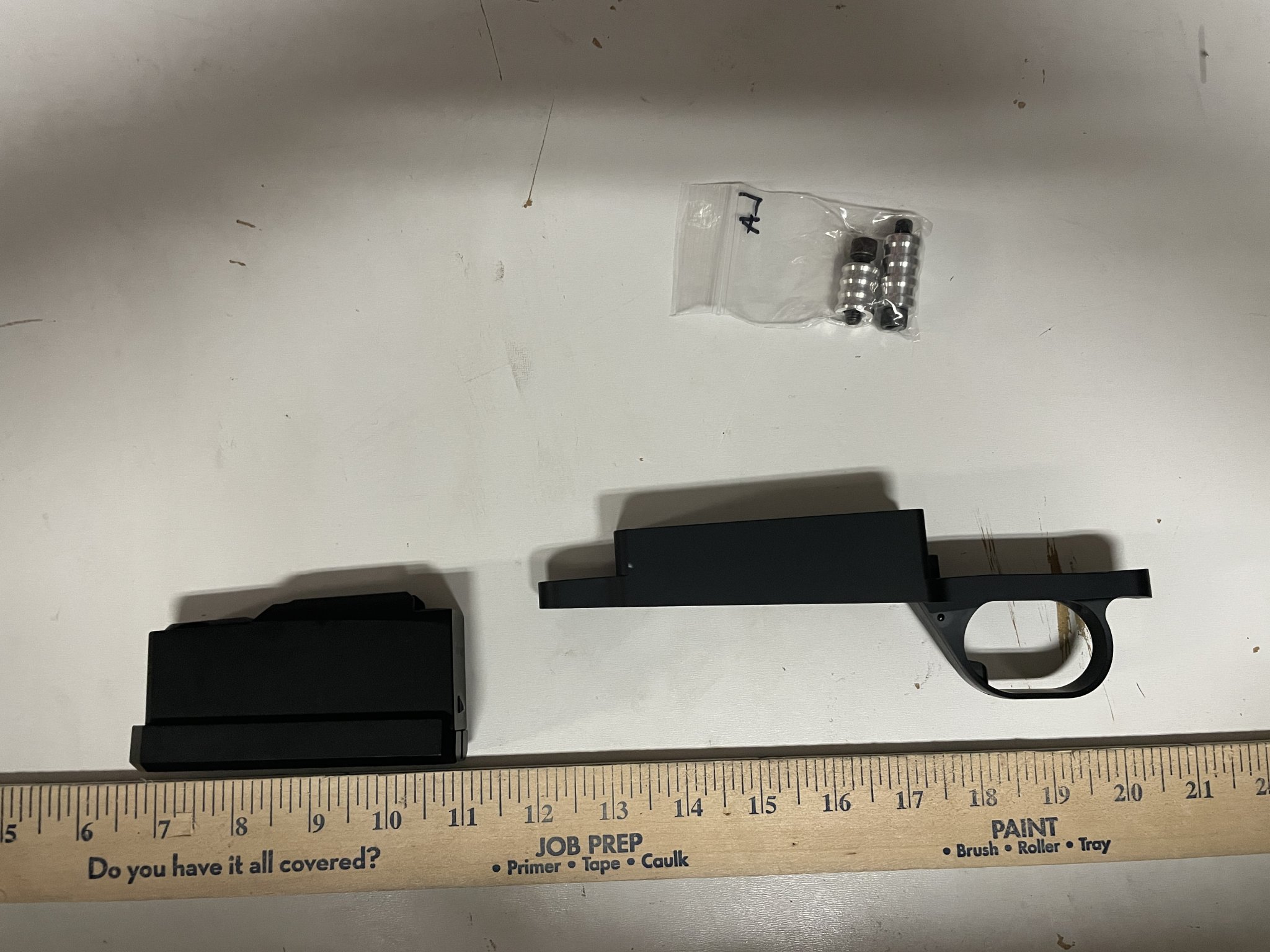

The MDT both metal 10 rounds and plastic 3 round feeds like butter.
The Hawkins mag, the feed lips were way too wide (and just felt geometrically wrong) causing the cartridge to be way too high and the rim would get caught on the the back of the mags or nose down and the bolt would pass over.
The feed lips are also way forward compared to the MDT which causes the round to hang and just not feed smoothly. I had to use a vice, files, emery paper, sand paper and polish which isn’t any thing I really like to do on a 130$ magazine. I might drop them at the smith sometime next week and see if he can work some magic but ultimately not something I expected for the cost of the magazine. It does feed now but very stiff and not smooth at all yet if I open up the feed lips it’ll cause the other issues.
Reactions: Desert Demon
Arc Nuke 2.0.
Hunter M5 DBM
Foundation stock
Goes to show the action matters - with the AntiX I had, the MDT magazine feedlips were too short, causing me all kinds of problems with the rounds popping up and bouncing off the top of the receiver before the nose was in the chamber far enough to feed without wedging at an angle. Accurate AICS had longer feedlips and didn't have this problem, so head's up on that magazine, too. Thanks for the input, that's very helpful!
Yeah for a “CRF” action like the Nuke, shorter feed lips might be better.
I also had better luck with Accurate mags with my AnTI as opposed to MDT.
So all in all, it depends.
Reactions: ormandj
Y
Yea, but MDT only makes those for SA—and only .308 family. Maybe with enough feedback they will eventually make them for LA. But then you have the feed lip issue on a polymer mag—can’t adjust.
For long action—this seems like a good solution.

Sorry to hear you're having issues with the magazines. The geometry of the feed lips and the height of the magazines has been optimized to work in as many platforms as possible. Generally when folks have this sort of problem it's a pillar height issue, but you should not be having that with a Foundation. It may be something to do with the Nucleus, we'd really have to see to diagnose for you.
Y

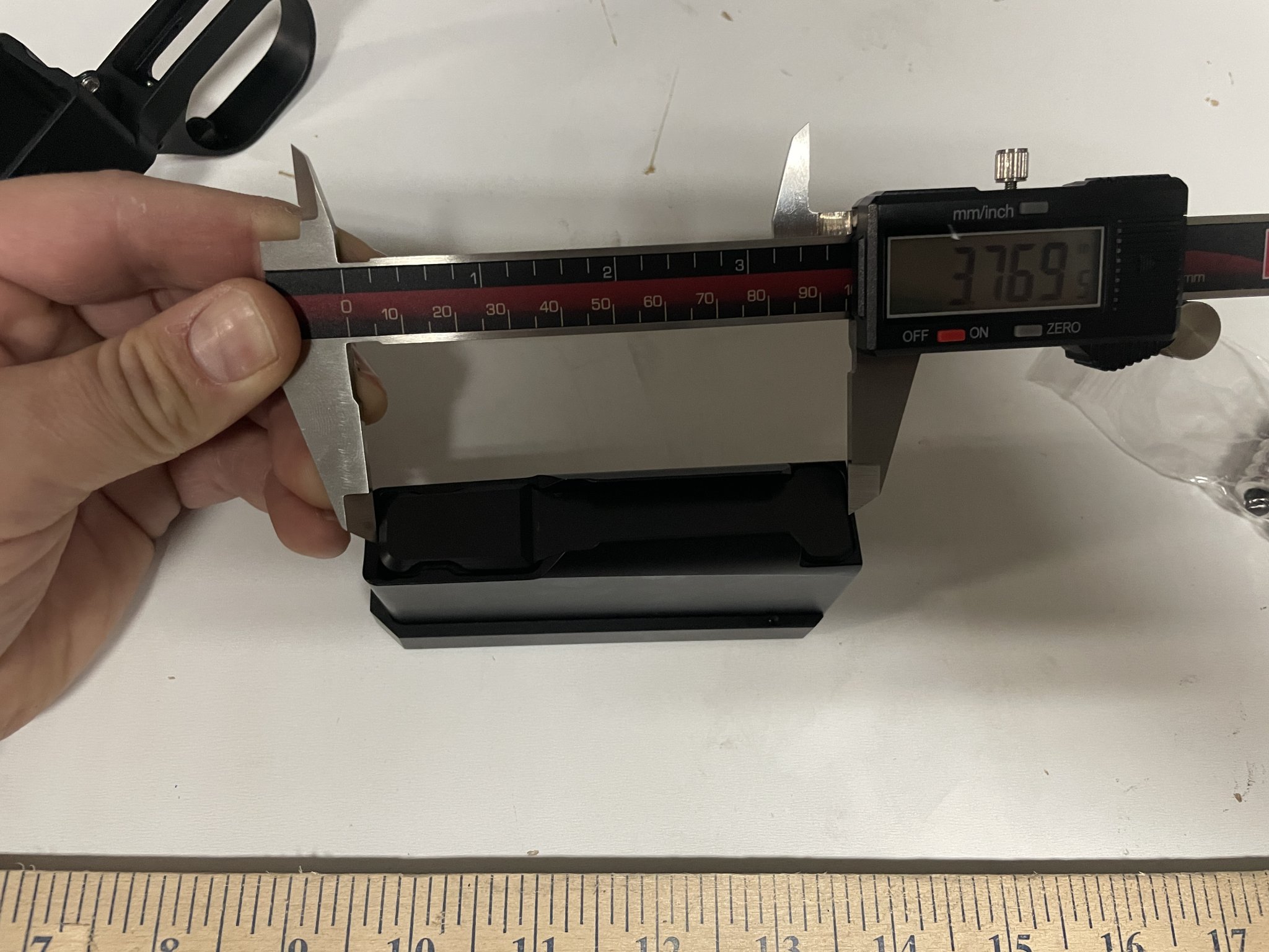

It’s also short COAL since it’s polymer. I do wish they made them steel in a binderless magazine length, and also offered it for SAUM style cartridges.
@HawkinsPrecision will your flush hunter magazines work in any AICS magazine compatible system, or only your bottom metal? They look like a great option for lightweight chassis-built rifles, if so.
Has anyone gotten one of these LA options to work well with a 6.5-284?
I like it on my 300 NM. I don’t want to mess with that mag out of fear of messing up what isn’t broke. But considering getting another set to use for a 6.5-284. I assume you need to adjust the feed lips?
The flush magazines will not work in any AICS mag well. The mag well needs to be flush on the bottom since the magazines are short and the base pad hits the bottom of the magazine well. We can only guarantee they work in ours, but we've had many reports they work well in Waypoint 2020 rifles as well, as an example.
We are working on LA, standard bolt face magazines now too. 280 AI / 284 WIN, etc.
