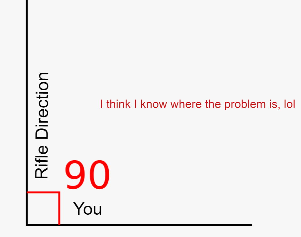

If I am 90° behind the rifle and i "turn" my head. I am no longer looking through the scope 😁. But hey, maybe that's just me?🙆
100% agree on you other statement 👍
Hi,
90deg behind the rifle?????????
Sincerely,
Theis

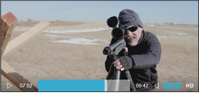

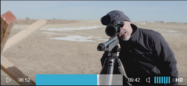

Alright....so let's clarify terms here when we are talking about rolling the head.
These shots are from Frank's vid on placing the stock.
This (below) is NOT what we are saying and this IS what Frank is using as an example of what NOT to do. Note the acute roll of he head resulting in this case from putting the butt in the shoulder pocket (way to far outside, right?).
Now, this (below) IS what we (I guess @308pirate and I, at least) are talking about and this IS what Frank is using as a what TO do example...that is, keep the butt inboard and reduce head roll. Please note that the degree of roll...probably best evaluated by looking at the top line of his sunglasses...is far, far less acute. But there still is some there because Frank's eye isn't on the side of his head next to his ear. haha

Now, I ain't telling Frank a fucking thing about how to shoot a scoped rifle. Matter of face, I'm in his clinic in late Sep and intend to listen and apply everything that Frank and Marc tell us. But, it does occur to me that if he turned his nose into the gun just a bit, it would reduce the amount of roll needed to get into the eye box. I'm sure that there is a damn good reason to not do this with rifles vs shotguns, but I can't imagine what it would be. The amount of nose turning I'm talking about is small...just enough to feel your eye tooth touch up against the stock. This is enough to move your eye inboard just a bit.
Alternatively, if you have a stock/chassis that allows the comb to be adjusted laterally as well as up/down, you can work with that also to keep your head up straight and still be in the eye box.
Also, a lot of this seems to be dependent on proper comb height to get into the eye box. Too low and you either have to be looking up thru your eyebrows, roll your head, or both to get behind the center line of the scope.
I hope my inexpert musings have been somewhat helpful to you.
