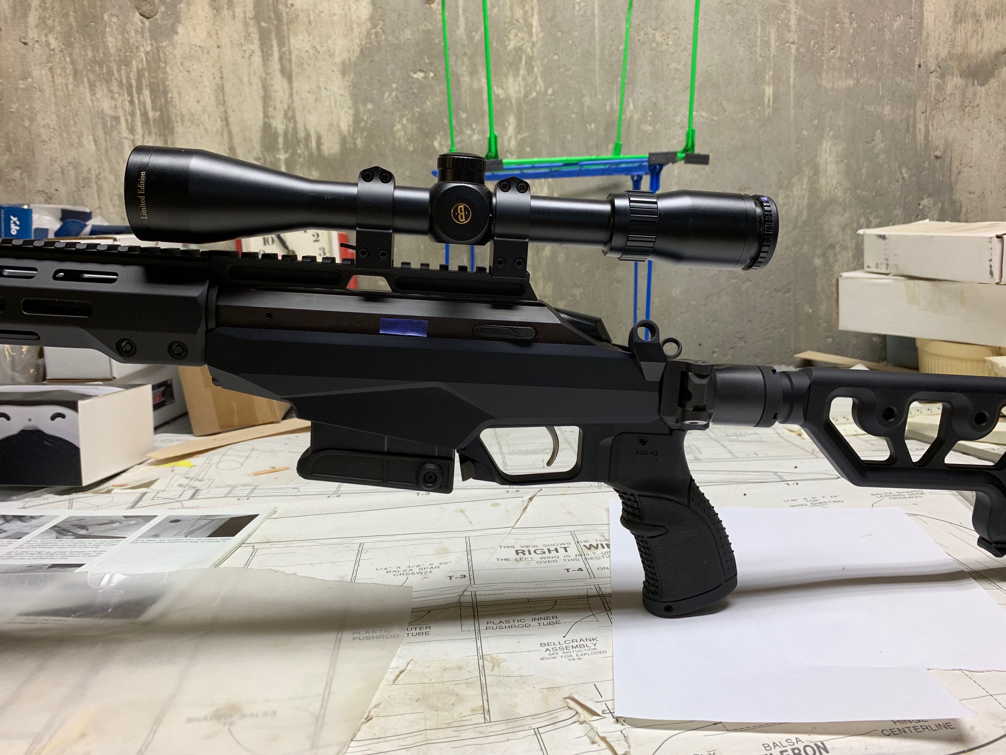

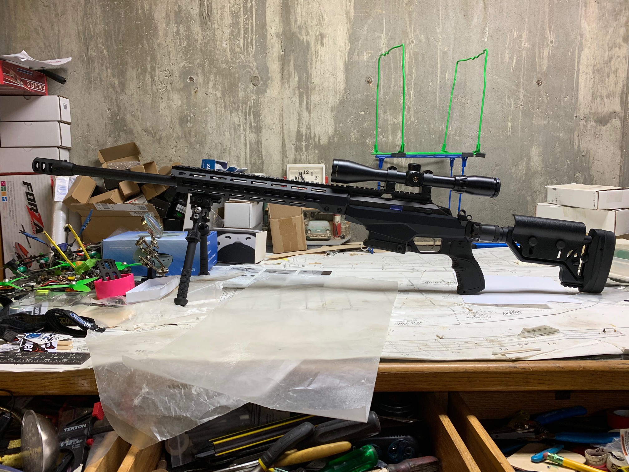

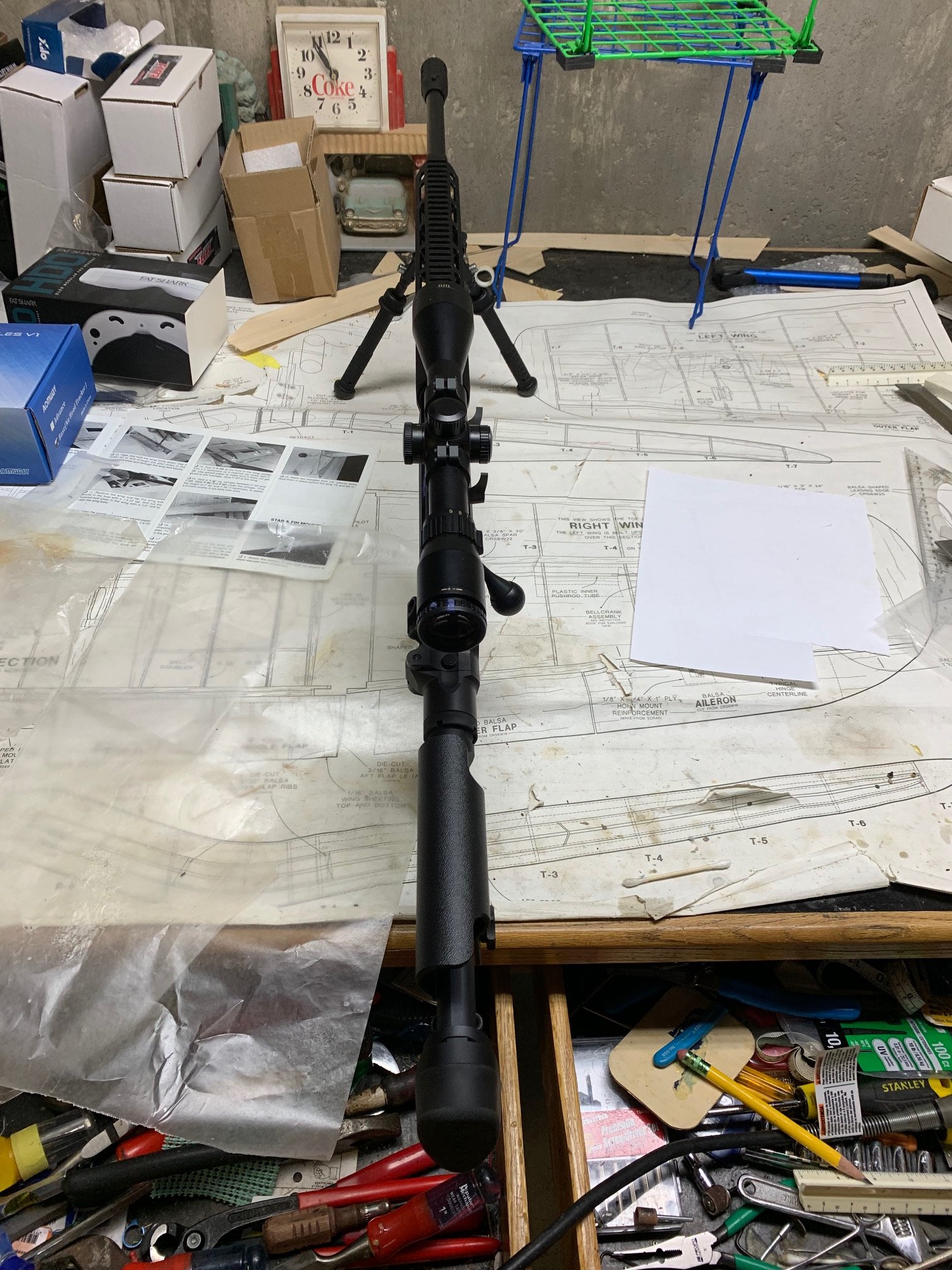

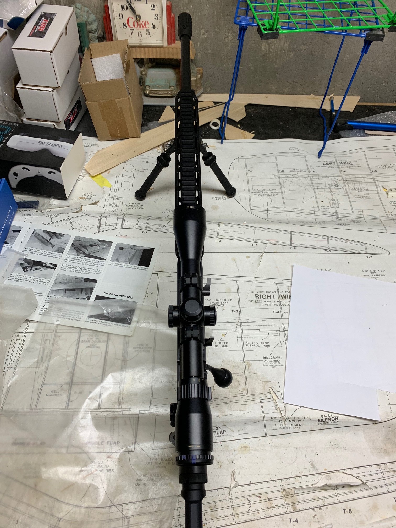

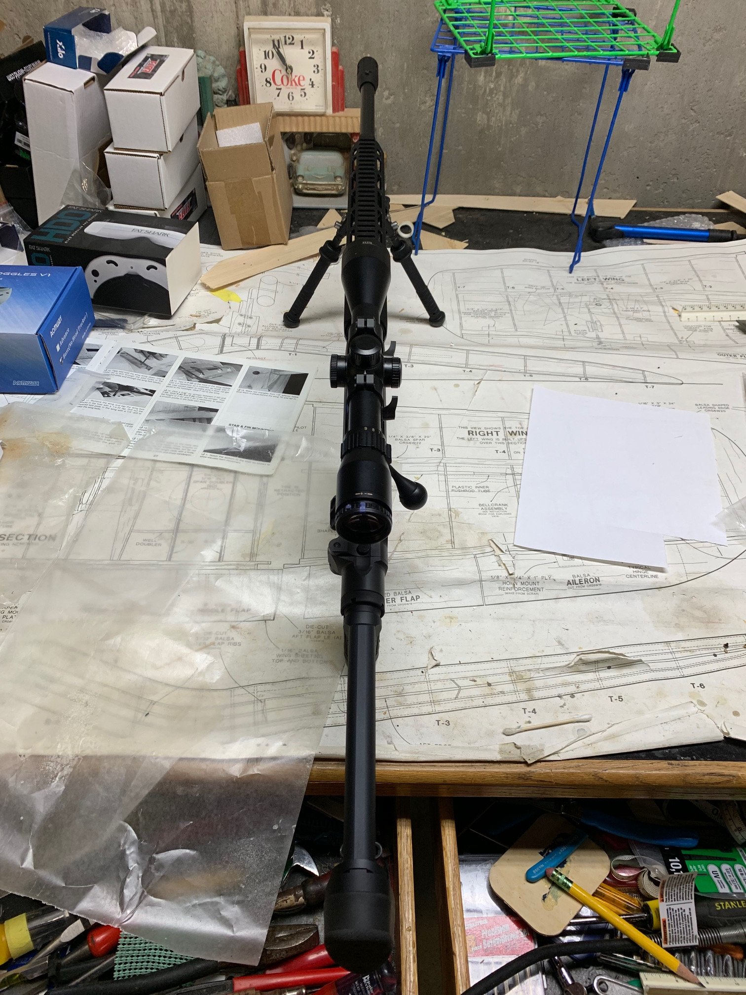

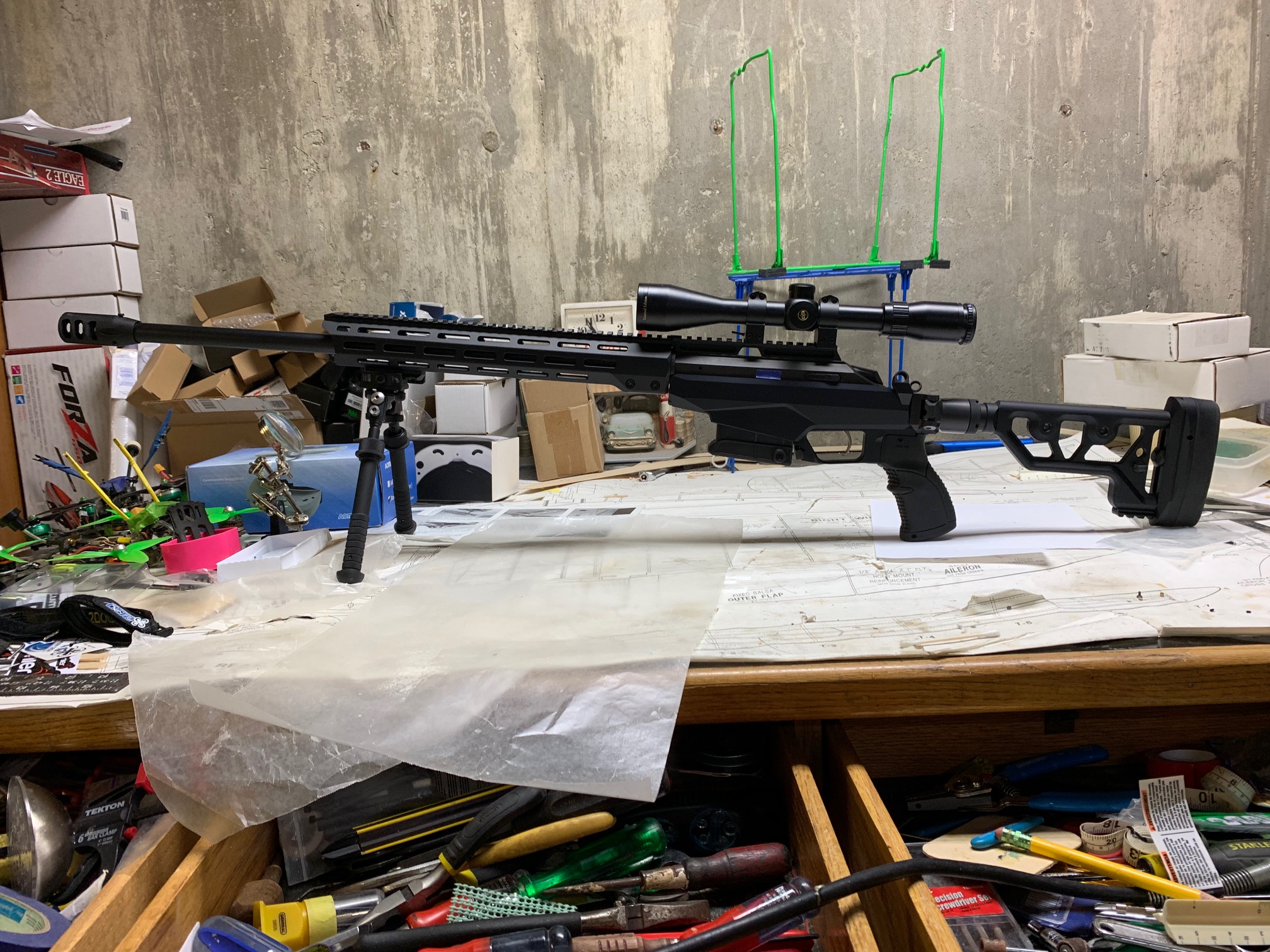

Pictures may help others here who know way more than me, but if you need to remove the cheek rest to get low enough to get proper alignment you may need rings that move your scope higher over bore.
so I took out bolts holding comb. I slide comb all the way down so it was resting on bare skeleton stock. I held it in place and slid chin down comb, it still would push my jaw to the left and i would have to tilt my head to get sight picture in scope. my head is more rectangular than round which I would think would help me. With out comb I can get head straight and sight picture but get chinish weld not cheek weld. Wondering if a cheek pad would help be stay straight yet give me a cheek weld?
Just pasting in your pictures. Any of you on the gun with good sight picture?
From my limited knowledge it looks like plenty of height of scope over bore and room for a proper setup. I would suggest getting someone with good fundamentals to watch you setup on the rifle and evaluate your NPA.
