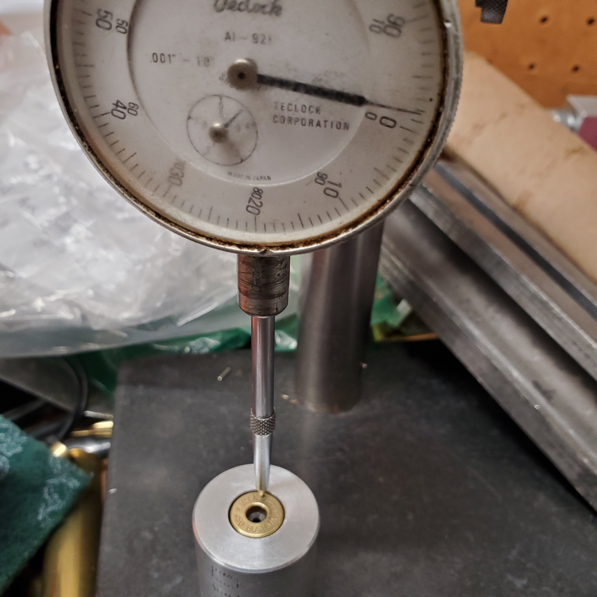

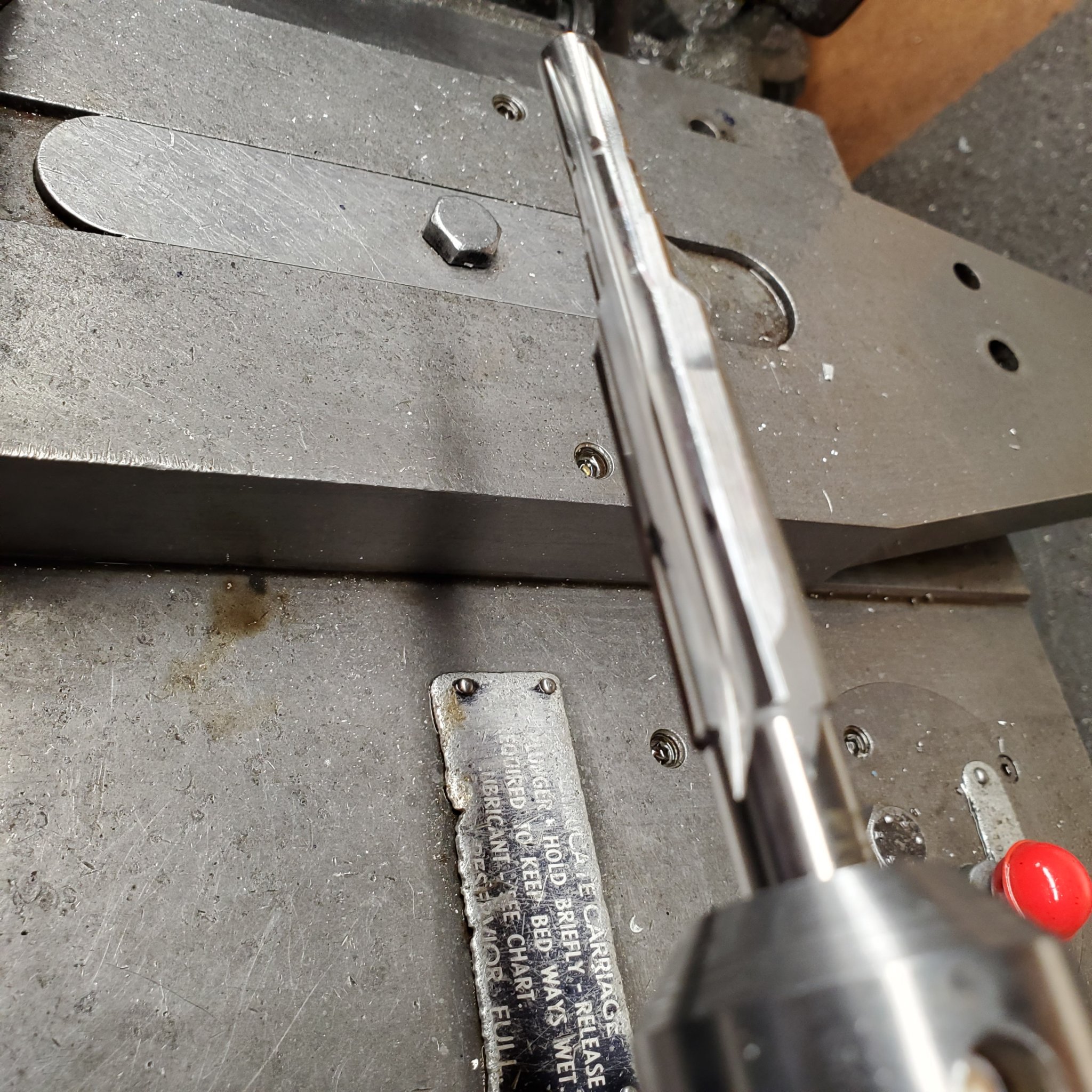

When there are no gauges for your standard, obsolete, or wildcat... don't use them, and are not needed. Use your finish reamer and die to form a brass cartridge gauge to set your chamber depth to... as this is what you are actually firing brass cases with .001" to .002"clearence to datum line ...not gauges.
