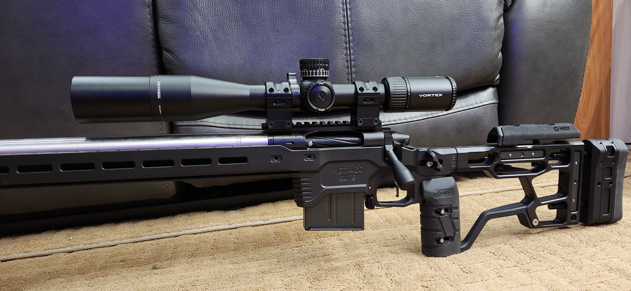

My proof research SS 6.5 creedmoor zermatt origin action prefit barrel gave me a headspace/datum line measurement of 1.534" on fireformed brass yet my brand new alpha brass had a measurement of 1.5345" and im not sure if this is usual? this is my first bolt gun and new brass typically has a much shorter headspace measurement than once fired. After installing the barrel i checked the go which it closed on and no go which is failed to close on so the barrel passed them but it just seems a little strange that my once fired has the same datum line measurement as brand new brass thats usually on the shorter side of datum line measuremens. Can anyone explain if this is normal. If not is it bad? I contacted proof and they basically said it's fine but idk it feels strange to me. What is usually what ppl experience in fireformed brass datum line headspacing growth from new brass?
(Picture is of my rifle)

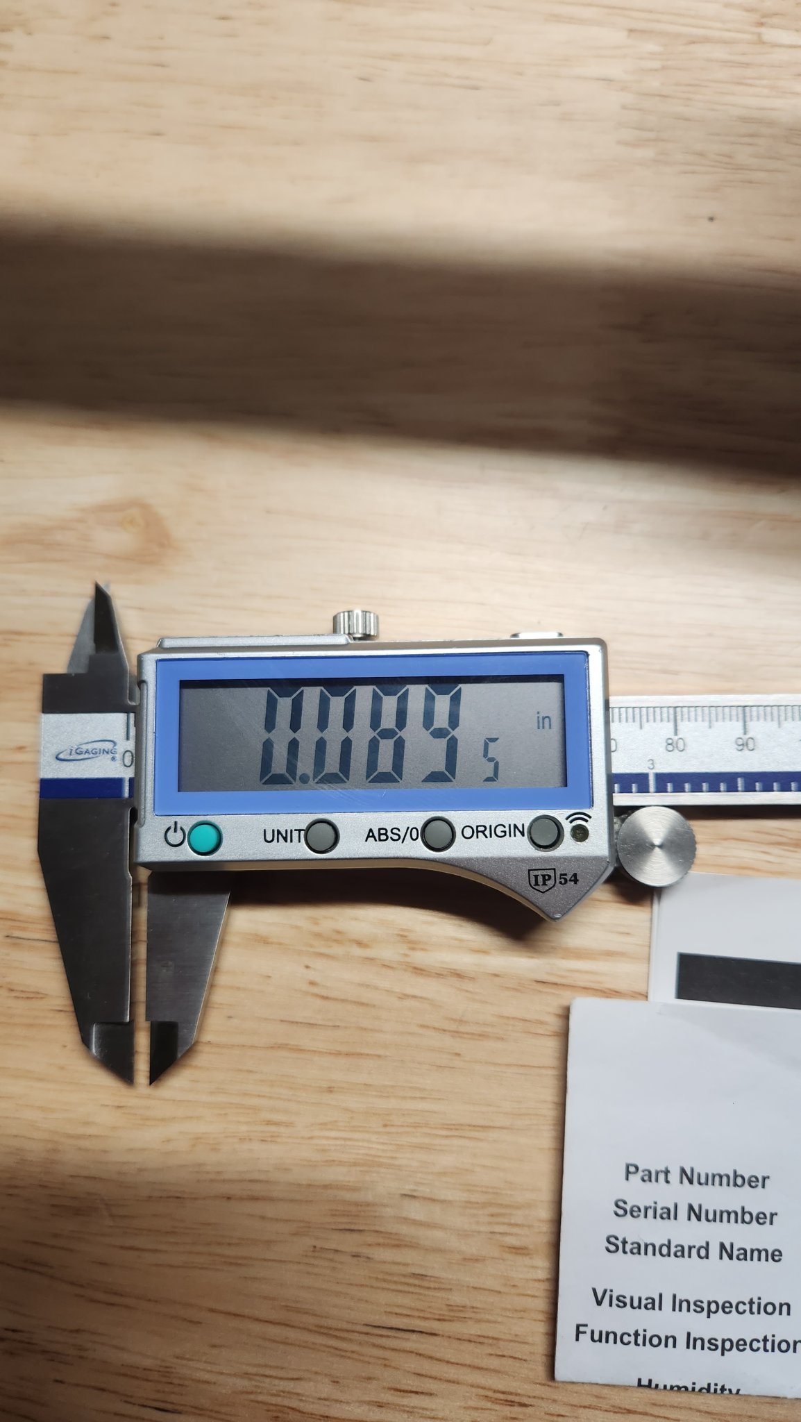

How did your calipers gain an extra decimal space?
As a DIY gunsmiff myself I recommend more 5 axis dremmel for the fix.

Eat that lol. I dont fckn know I didn't know where to put it. I reload so I figured it had to do with resizing and reloading fireformed brass.....I asked bc they didn't go into details and thought and see if some turd burglars on the interwebs could expound on the subject.

I was joking. As a machinist, calipers are only trusted down to a thou(.001), even with my half thou Mitutoyo pair. Anything under that and you need a micrometer. I definitely wouldn’t trust that Chinese pair you’re using.

So you used trash tools, called the manufacturer, got an answer you didn’t like so you asked the internet.
And you posted up $40 pair of calipers and tell ME to eat it. 😂🤣

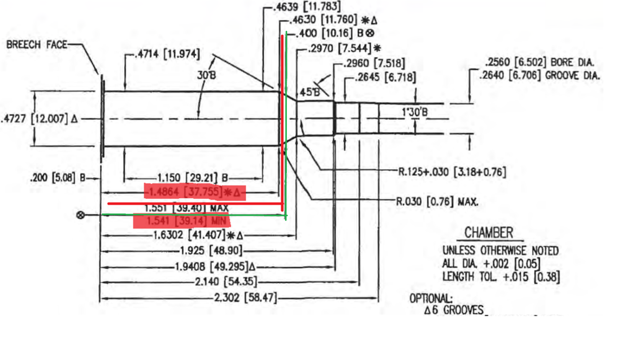

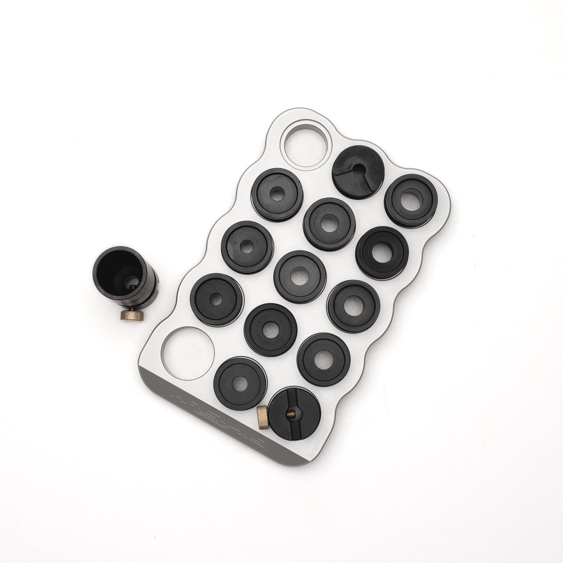

None it closed like it does without but what's confusing me us the Saami spec min is 1.541 and my fired brass is at 1.534. Isn't that smaller than it should be by a shit ton? Fuck me I'm so confused lol. I knew I should have finished college.
That's because a headspace comparator generally doesn't measure the headspace in the exact spot that's indicated in the SAAMI print.
Use your headspace comparator, measure your headspace gauges (both go and no-go gauge) and tell us your results. Then compare it with your brass measurements.
Edit - Your headspace comparator is referencing a spot that's in between the two highlighted dimensions.
So my forster no-go on my forster dual datum comparator is 1.539" and my forster go guage on it is 1.534". So that doesn't really leave me the ability to bump the shoulder back bc it'll be under the go guage aka min. headspace correct? Is that that a barrel chamber thing only or can the action play a role in that?
Absolutely incorrect. If you wanted to bump the shoulder 2 thou for example, you take your comparator, adjust your die until your brass case measured (with the comparator) measures 1.532"
This is a comparator measurement thing. Comparators are made to be mostly universal (within a range of cartridges per bushing) Your headspace 99.99% within SAAMI spec. Your comparator is not measuring the exact SAAMI specified point for 6.5 creedmoor.
Refer to the picture for a visual representation (the red line) where your comparator is sitting (which is 1.534" based on your actual measurement of both the headspace gauge and brass).
In order for your comparator to measure the same spot as a SAAMI print, you would need a custom bushing (specifically for a cartridge, in your case 6.5 creedmoor) that would have to rest on the green line.
Basically, you're not doing anything wrong other than interpreting the measurements you've obtained incorrectly.
In order for your comparator to measure the same spot as a SAAMI print, you would need a custom bushing (specifically for whatever cartridge, in your case 6.5 creedmoor) that would have to rest on the green line.

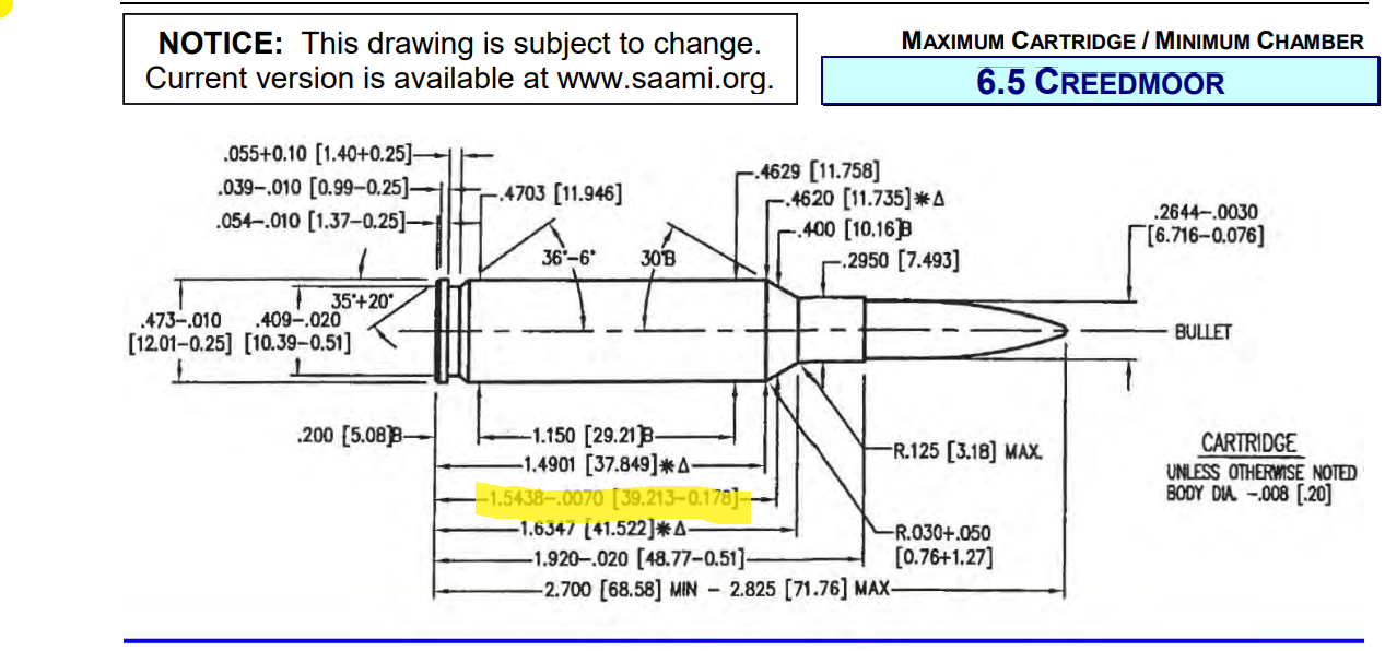

I guess I'm not understand the point of the go guage being the min and to no go being the max and it being ok to be shorter than the go but not bigger than the no go?. Aren't you supposed to be between the go and no-go guage comparator measurements? Not necessarily, your comparator doesn't rest on the exact spot that the blueprint calls for, which is why I told you to go measure your Go-Gauge with the comparator to see what the difference is. Sorry if im making it feel like pulling teeth lol. So if I bump the shoulder say 2 thou I would be out of the go/no go guage range right? Yes Wouldn't that be a bad thing since that's what they are used for? Not really as long as it's above SAAMI cartridge minimum spec. Fuck brother I'm sorry this is probably making you bald prematurely lol LOL, of all the things I deal with, if this causes me to go bald, I'm quitting the internet after doing research on hair transplant surgery.
Headspace gauges - Go Gauge is supposed to be made to SAAMI or CIP specified minimum chamber blueprint specifications. No-Go is some arbitrary number usually in the middle between blueprint minimum and maximum spec. A field gauge should be at blueprint maximum spec. The SAAMI specs is to establish safety dimensions for factory rifles with factory ammunition in a mass production scale, so for a cartridge, there is both the SAAMI cartridge and SAAMI chamber spec.
When you're sizing your cases, you want it to be smaller than your chamber (but not excessively smaller) in order for you to be able to chamber the round smoothly without issue. This would be under your chamber size. So if your chamber is at min spec, then your loaded cartridge needs to be smaller than chamber min but not smaller than SAAMI cartridge min spec.
The SAAMI cartridge specifications are designed so that the minimum sized cartridge spec will fire safely in a maximum SAAMI sized chamber without blowing up. Cartridge spec normally has a max spec that will still feed reliably in a min chamber even with a tiny bit of fouling. 6.5cm cartridge headspace is 1.5438 (max) and 1.5368" SAAMI min cartridge headspace.
Based on your comparator measurements of the 6.5cm headspace gauges, your comparator bushing is giving you a relative measurement of the headspace that is around 0.007" lower. When you're trying to compare SAAMI spec to what you measured with your comparator, you need to subtract 0.007" from the SAAMI blueprint numbers.
Use -0.007 and apply it to SAAMI min cartridge spec to obtain relative measurement (what you should see with your comparator). So for 6.5cm, 1.5368 (SAAMI cartridge min) - 0.007 = 1.5298"
1.5298" is the dimension for min limit sized ammo (measured using your comparator) that is still safe to fire in a SAAMI max chamber.
As a handloader, you don't have to follow SAAMI cartridge spec exactly since you can load to a specific barrel chamber. Since you have a min SAAMI chamber, you can even go below SAAMI cartridge min as long as you never shoot that handload in a chamber larger than SAAMI min.
SAAMI Max chamber (1.551) minus SAAMI min cartridge (1.5368) = 0.0142" difference. You use this number to maintain the same relationship with min chamber spec.
1.534" (your headspace gauge/chamber spec using comparator) - 0.0142" = 1.5198" is the shortest your case should measure with that comparator otherwise you blow up. In other words, plenty of room to bump the shoulder back without issue.

It’s a tolerance stacking thing. The chamber is plus/minus as are the bolt face, your sizing die, etc. The case lube also affects how much your die bumps the shoulder. It’s not an issue unless you are having problems closing the bolt on factory ammo. Your brass will live longer.
Reactions: JRBullock1987
DUDE.....God bless you!!! Thank you for taking the time to explain this... I'm seeing what you're putting down. Is there a comparator set out there that isn't way off like my forster is? Or are they all, all over the place? I need to get some new bullet comparator anyways and might as well find a good set of both. My bullet comparator in 6.5mm has a very sharp edge and when I use it to get my cbto it leaves a pretty deep ring cut around the bullet even with the lightest of pressure. The .223 one isn't too bad but I can't use the 6.5mm one..sucks but might as well find a set that is closer to actual measurements
They're all off because they measure relative headspace. They'll never be exact unless you just happen to get lucky. I like the Derraco Headspace comparator set, lots of bushing and bullet inserts for around $50.

For sure. Do you know ow if when using something like a coax that does have the ability built in to have a cam over but you have to screw the sizing die down far enough that it cams over a little bit. Would that fuck up the brass holder shell clampy thingymajigger. It's not super hard but there's def a little cam over
It's on the expensive side, but I have really enjoyed the Area 419 bullet and headspace comparator set, paired with their stand for it (but it requires you use Mitutoyo calipers - which would be a great idea for you to do anyway.
The Area 419 set isn't going to give you an exact industry-standard measurement (neither are any of the other brands), BUT they did design them so they are very consistent from set to set, so that if someone else across the country has the same set, the measurements you compare will be consistent with each other. Most sets don't maintain that consistency set to set, at least I'm not aware of any other set that is made this way, which is why its often hard to compare measurements with each other.
The stand they make for the unit is REALLY cool, because it allows you to measure in a stable manner (almost one-handed) and use gravity as a consistent pressure for every measurement you make. Set the case or cartridge in, allow gravity to close the calipers on the shoulder or bullet ogive, then give the case a slight wiggle until the numbers stop getting smaller. The force applied (by gravity) is the same every time. It is especially helpful when measuring bullet seating depth, as it keeps the edge of the comparator from being forced against the ogive with a different pressure each time, keeping the measurements more consistent.
It won’t. Those jaws are super hard. I use a shell holder conversion on mine and have the die adjusted to act as a hard stop for the mechanism. Just have to screw the die in deeper, way past the cam over point.
I was actually looking at their sets earlier this morning but got a little confused on the angle stuff for the caps. Are you supposed to use the 30° angle comparator bushings for 6.5cm?
I've seen those conversations. How do you like using the regular shell holder compared to the coax jaws? The reg shell holders can't self center like the jaws huh?
Not sure about the 30 deg angle you referenced. The 6.5CM uses the .400" dia. bushing according to the chart on their product page (scroll down to it):
Damn you weren't kidding that's awesome looking. Smart how they stick a flat platform for the base instead of having to index of the calipers small shelf

Resolution doesn't indicate accuracy ( + or - 0.0001) Next question ?
