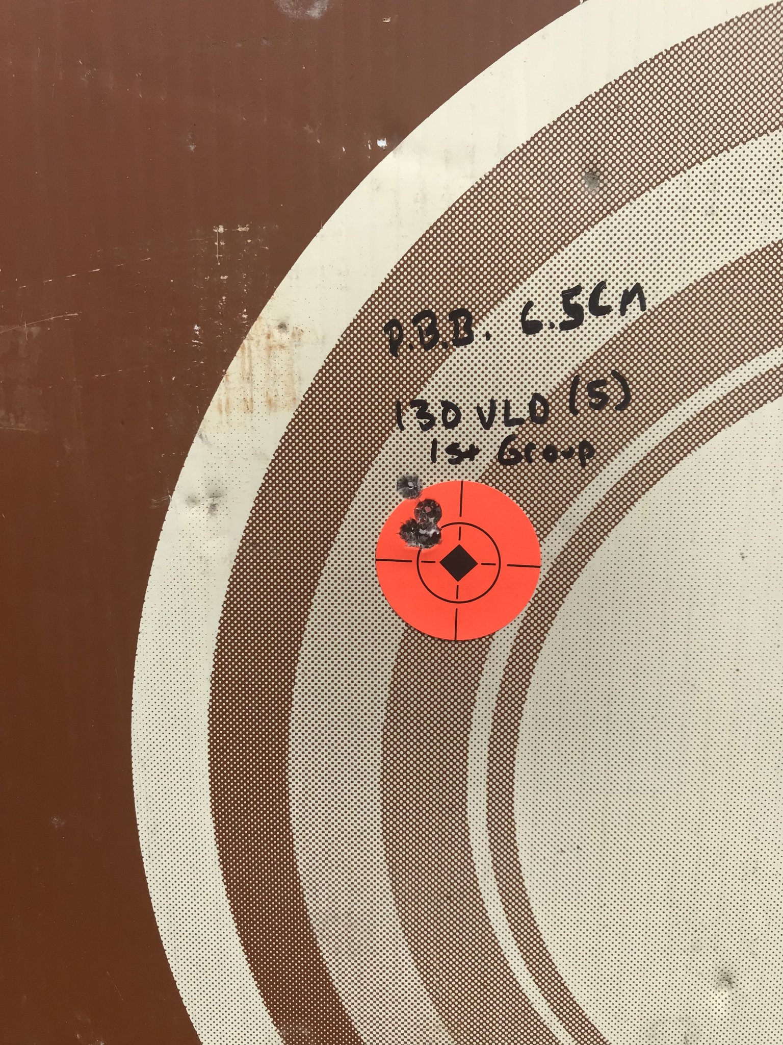

I recently assembled a pre-fit on my Bighorn Origin in 6.5 CM.
It threaded on smoothly no problems there, very little slop, torqued it to 75lbs. It will not close on the No Go. It will not close on the GO. It will close on a piece of virgin Lapua brass with no resistance. (The gauges are Clymer)
I will only be reloading for this rifle and my initial thought is run it as is and adjust my sizing die accordingly.
The manufacturer has agreed to adjust it, but would need my action and I would rather avoid that, if it's safe to shoot as is?

Yep, slipped them under the extractor. I checked it when "hand tight" to begin with and it would barely close on the GO.
After torquing it would not close.
Thanks for the replies fellas, think I will shoot it and see about the re-sizing process. Like ya'll said, worst case I grind a touch off the shell holder or die.

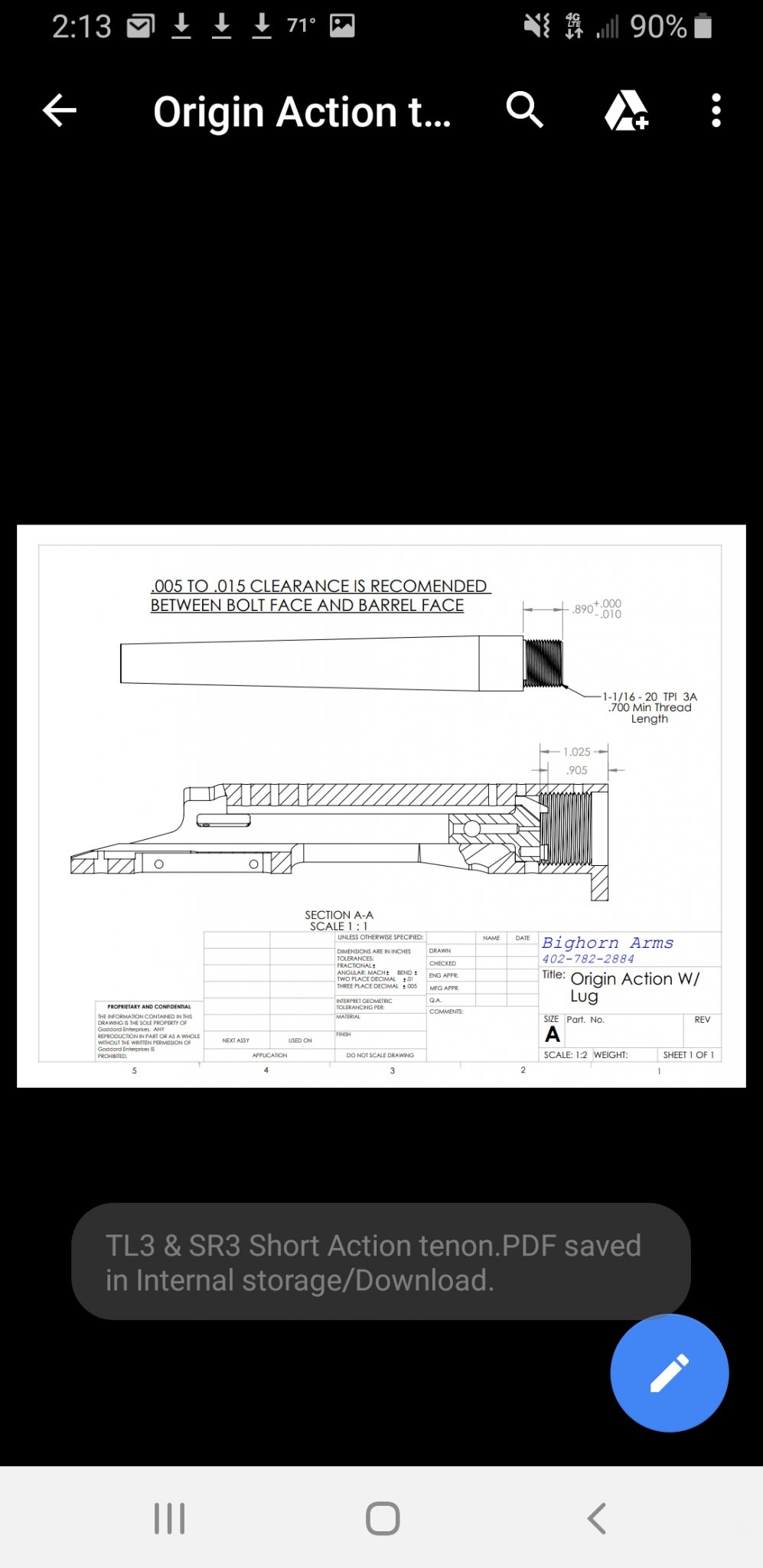

Unless I missed it somewhere, this is a standard pre-fit, not a shouldered prefit?
Heres the blue prints directly from bighorn on the origin. This should help you figure out where the tolerances are out.
Reactions: santee116
