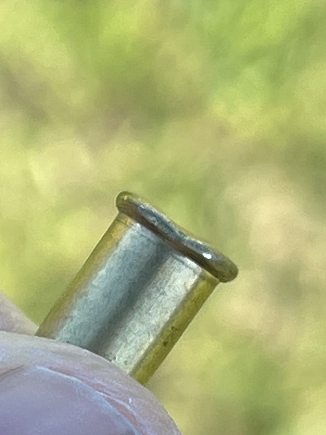

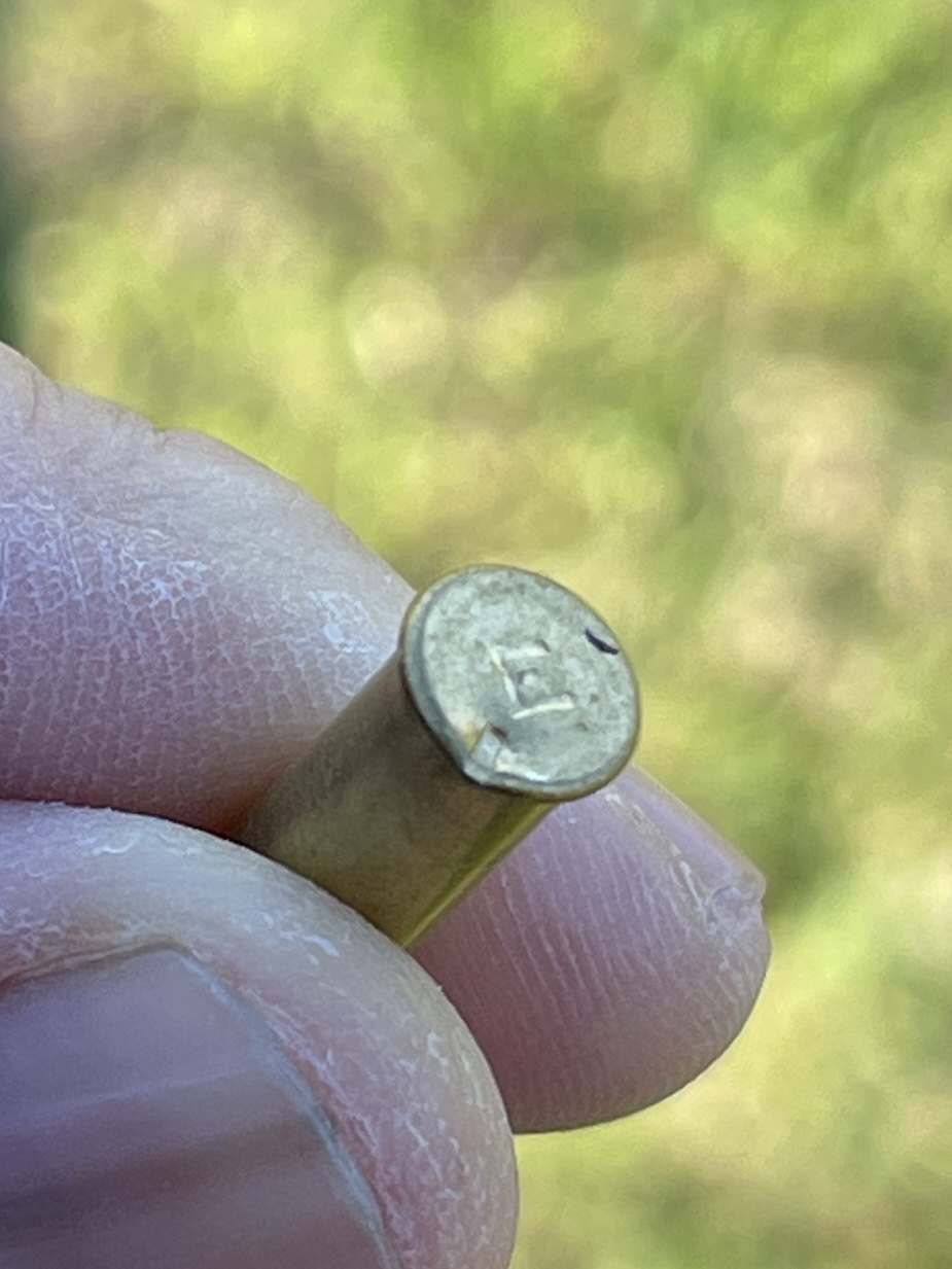

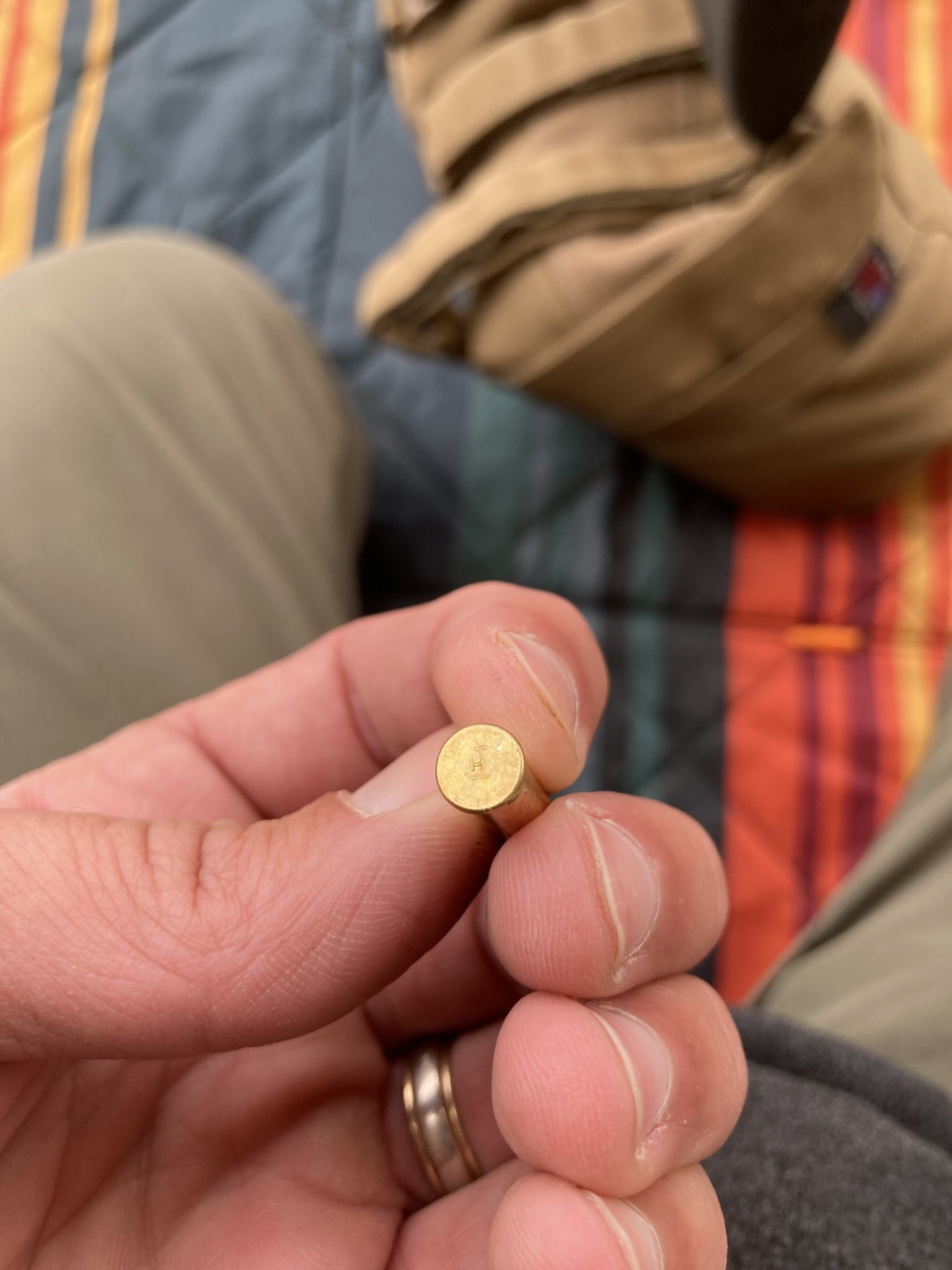

My custom 22 is giving me light primer strikes. I’ve tried a different trigger, sent the bolt back to the manufacturer and tried different ammo. Same story, light primer strikes. I’m now thinking it’s a headspace issue. I tried the tape method of checking headspace. Put 1, 2, and 3 layers on the back of a live round and it closed with ease and no resistance. Didn’t want to keep adding more because I don’t want to stress the extractor. I measured the layered tape and it was .014 inches. Does that sound right with it being a headspace issue? Also, is it unreasonable to ask the gunsmith who spun the barrel to pay for the shipping to get this fixed?
Gun is a Curtis Custom Valor 22lr conversion in a KRG Whiskey 3, with a trigger tech 2 stage special trigger.

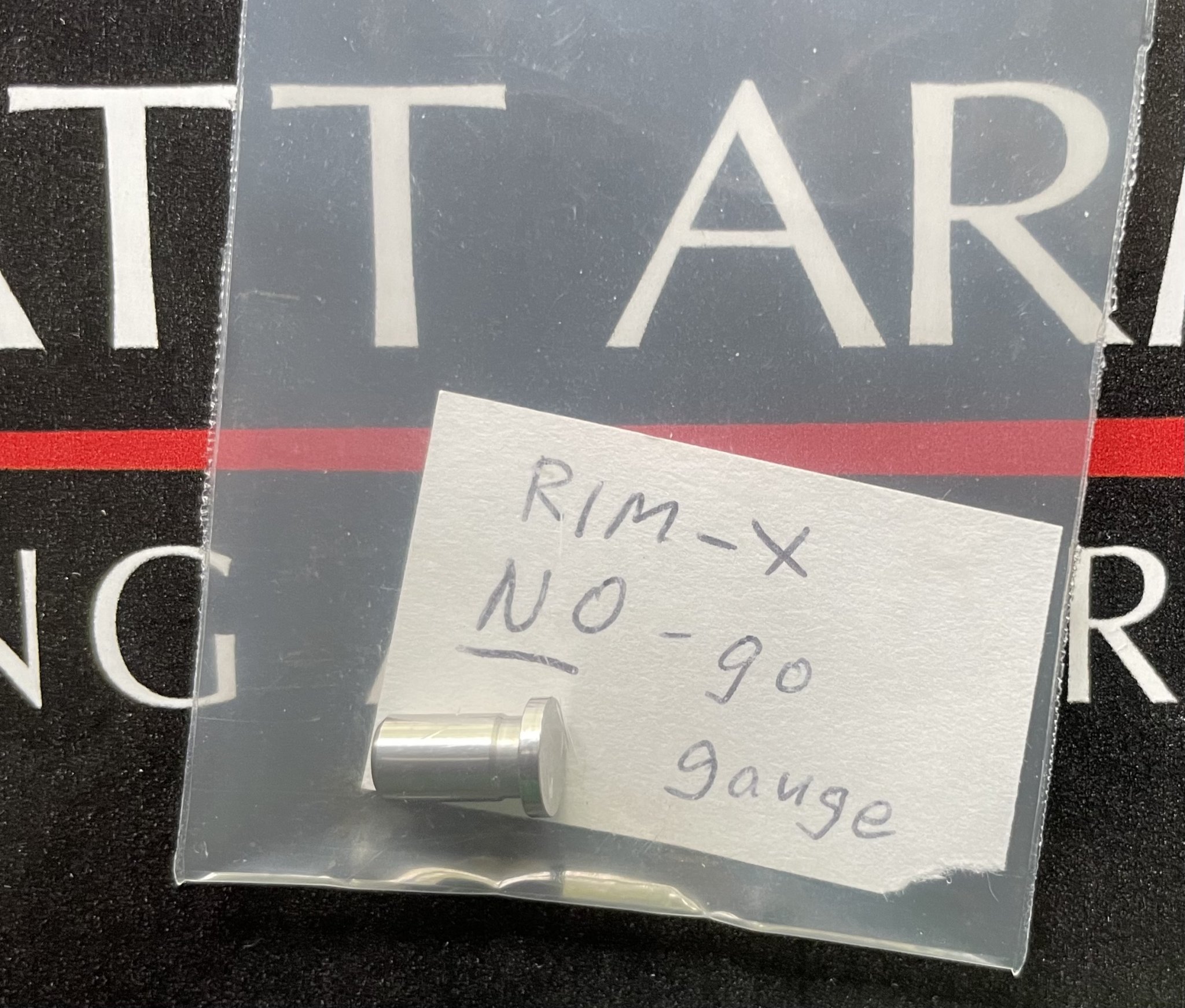

SAAMI spec for .22LR chamber headspace is 0.043-0.051" min/max. Spec for the cartridge rim is 0.043-0.050" 0.036-0.043". Fwiw, the "rim thickness" of my Rim-X no-go gauge is exactly 0.050 inches.
If the cartridge rim is within SAAMI spec, the round should fire. Period. You need to confirm correct headspace. Without that confirmation, discussion of rim thickness is useless noise.
If I don't like the indentation "signature" of some brand/SKU of ammo in my Vudoo or Rim-X, I change the ammo - not the rifle*.
I suppose, in absence of a go or no-go gauge, if you measure a specific round's rim thickness, stack tape until the bolt won't close, and measure the depth of the stack, maybe you can get a rough idea as to whether excess headspace (> 0.050") exists - layers of tape being soft and not especially precise.
