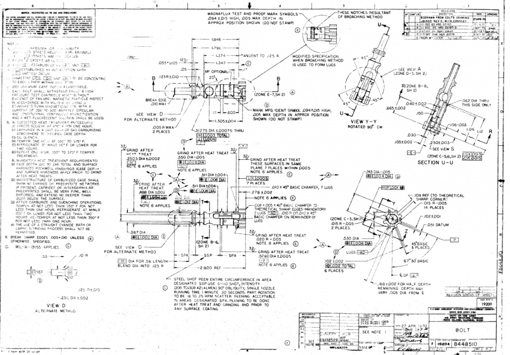

    Take a set of calipers and measure the distance from the front face of your bolts to the rear of the lugs. Normally about 0.278" but dwg 8448510 says .278 +/- .002". I have found this dimension to be held pretty well. Now measure the distance from the front face to the face where the firing pin hole is ( I have found this dimension to vary up to 0.005" but is around 0.123") and subtract it from the first dimension. The face where the firing pin hole is dimension is based on the center of the bolt cam pin hole and has a +/-0.004" tolerance. The drawing has the dimension from the back of the lug to the face where the firing pin hole is 0.156-.003". This is where headspace can be affected by the bolt.
    I would trust some of the higher end bolt manufacturers to hold the tolerance that actually sets headspace in an assembled rifle a bit tighter than .003" but when I have swapped bolts in a rifle before, I have measured to ensure I stayed within a couple thousandth's. But I will also verify with a GO gauge and some .001" shim stock.
