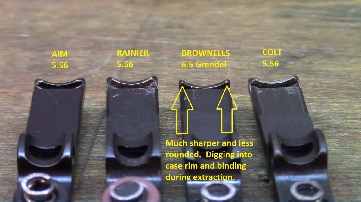

Is the 260 broke in enough ? ( How many rounds through it ? )... if less then 100 rds.. fire more to break in.
Does the extractor have pointy ends or rounded ?... Pointy ends tend to "grab" the case rim and not readily let go of the case.
Pic from the internet...
I would make sure the extractor is not pointy... then try a heavier recoil spring and heavier buffer weight.
Given it not locking back every time... it does sound like it is cycling fast.
It only takes a few milliseconds of slowing the cyclic speed to help with "over-gassed" symptoms.
Given your added pressure from being suppressed, I would tend to think slowing the cyclic speed would help.
Currently, how many clicks from closed is your SLR adjusted to ?... mine all run at 6 clicks open from closed ( with heavy buffers and the Tubbs ) unsuppressed.
