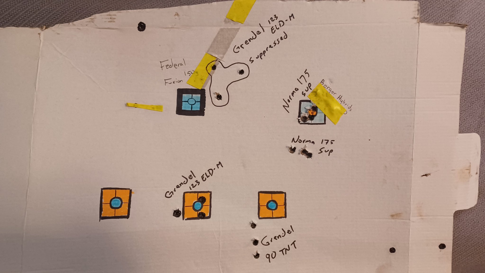

    Here are the results
    I went out today after removing the little spot of bedding material contacting the barrel and putting her back together.
    I set up where I thought would be close enough to borescope and just get on paper. After ranging, that turned out to be 77 yards. I said fuck it and rolled with the punches.
    First shot was very high and left. My aiming point was the middle of the 3 orange boxes on the bottom. First shot is not labeled but is visible on picture.
    I made one correction basing of the POI using my reticle. Aimed back at the same target and voila! I got the impact inside the orange square just on the bottom. Second shot was just outside to the left and third on the top right quadrant.
    Since this is a hunting gun for my dad, I didn't care about having a rifle that shoots 1/3 moa. After all, he will be shooting deer inside 200 yards.
    I decided to try Federal 90 grain TNT just to get to know the rifle better and see if it prefers one ammo over another. I didn't like the group.
    Next up was going back to the original ammo tested, which is hornady black loaded with a 123 ELDM. Aiming point was top left blue square with the thick bold outline. Group definitely opened up and suppressor shifted the POI. Wasn't really too happy. Suppressor is a TBAC Domius.
    I brought out my FN SPR to see if I could eliminate myself as the culprit. I shot the top right blue square and had the 3 impacts just low of my aiming point. I made one correction and I was good with the result. I shot my FN SPR with the suppressor both times using Norma ammo loaded with a 175 grain golden target.
    At this point, this is a huge improvement over last time I took the rifle out. However, I Shot steel out to 300 yards and could never get any consistency on a 8.5" plate. I made first shot impact almost dead center using the suppressor (which at this point is already cool to the touch) and guesstimated a 1.4 mil solution. I let dad rip a few more since I was already on target. He missed both. So now I get back on the rifle to see if it's him or the rifle. I wasn't able to figure it out. I held over and under many times as well as dead center. I tried with and without suppressor.
    At this point I'm a bit frustrated so I get the 308 out to see what's up. I guesstimate again a 1.1 mil solution and sure enough I get consistent hits, my dad gets hits, and a guest we had also had consistent hits. He even had a blast shooting the SPR.
    I guess we're back to square one at this point. I'm not comfortable letting my dad hunt with this rifle yet. If you've read this far on my range report, congrats lol!

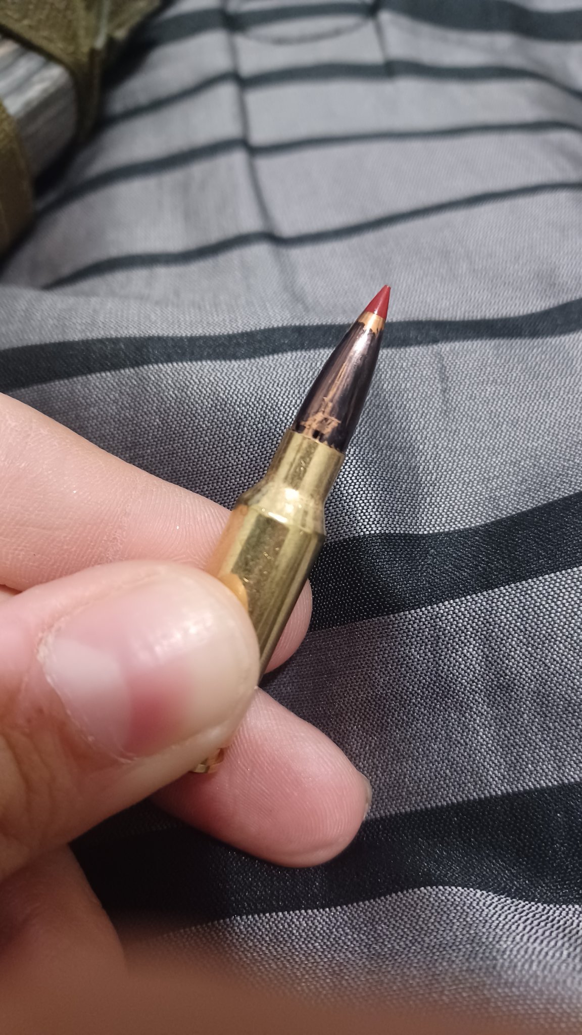

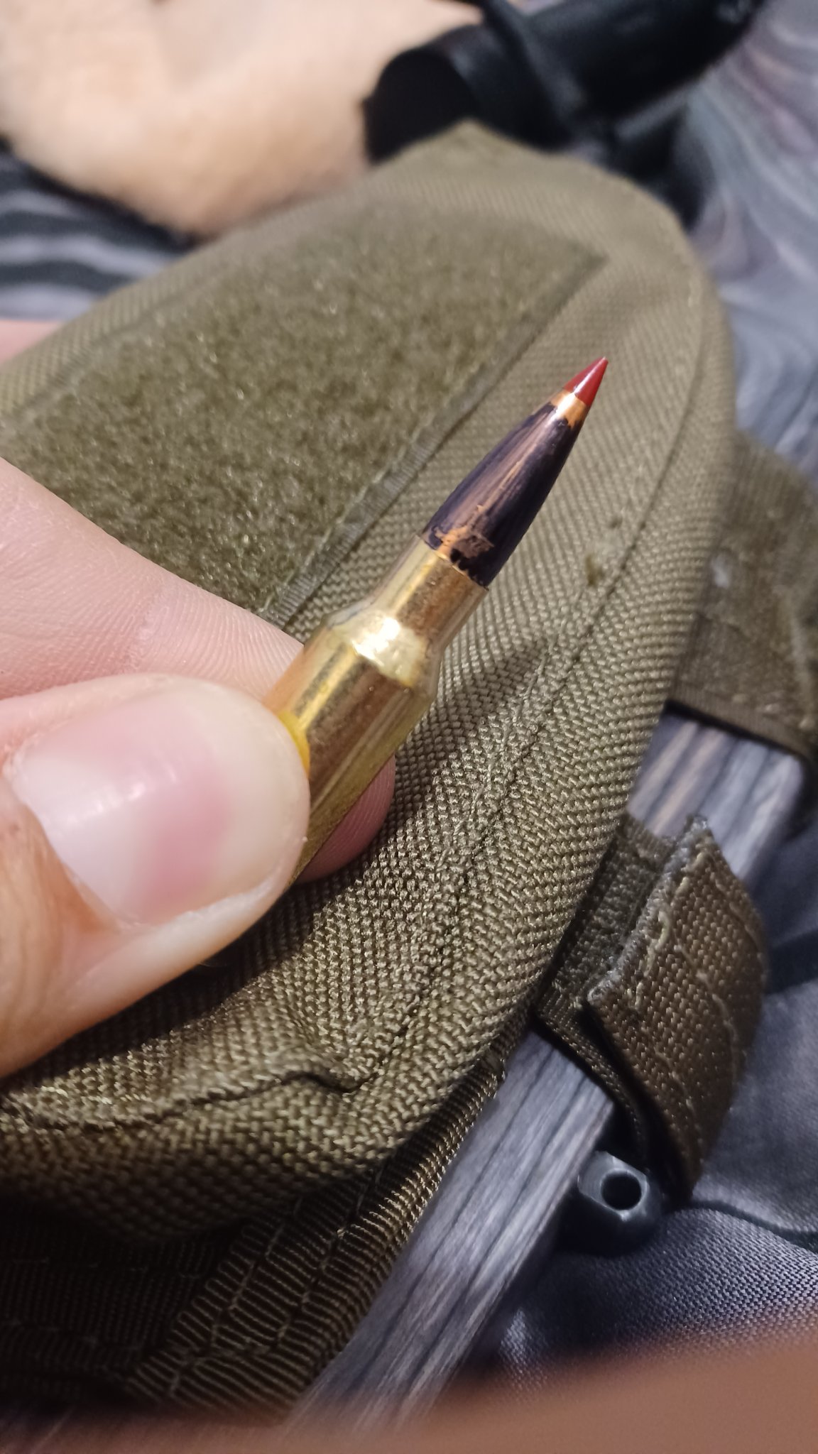

    Ok, so here it goes...
    All 3 factory loadings that I have on hand load into the gun and chamber almost identical. That is, I push the round forward into the chamber with the bolt and when I try to close down the bolt, it's hard. It's hard because it seems as if the ammo is long because once I push the bolt forward into the chamber, it moves a slight bit forward then I am able to come down very smoothly and with ease. This is with all 3 loadings that I currently have.
    Hornady Black 123 ELDM
    Hornady black 123 BTHP
    Federal American Eagle 90 TNT
    Ok, now that that's outta the way...
    I loaded one of each with a bullet coated with black sharpie. The two Hornady loadings appear to maybe be just barely jamming into the lands. You guys be the judge.
    If that is indeed a land mark, there is only one land (or just one marking) making contact with the bullet, not multiple.

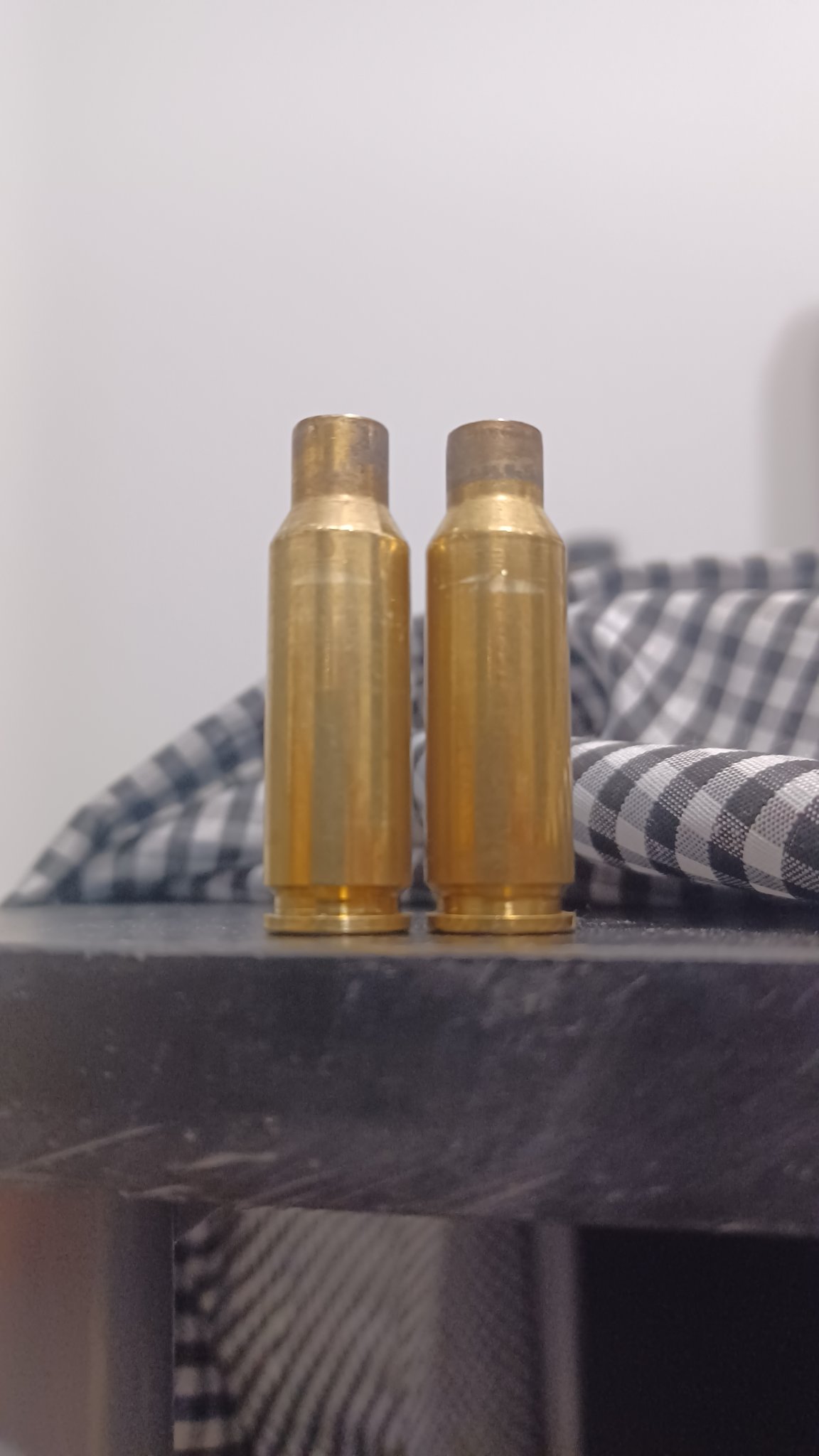

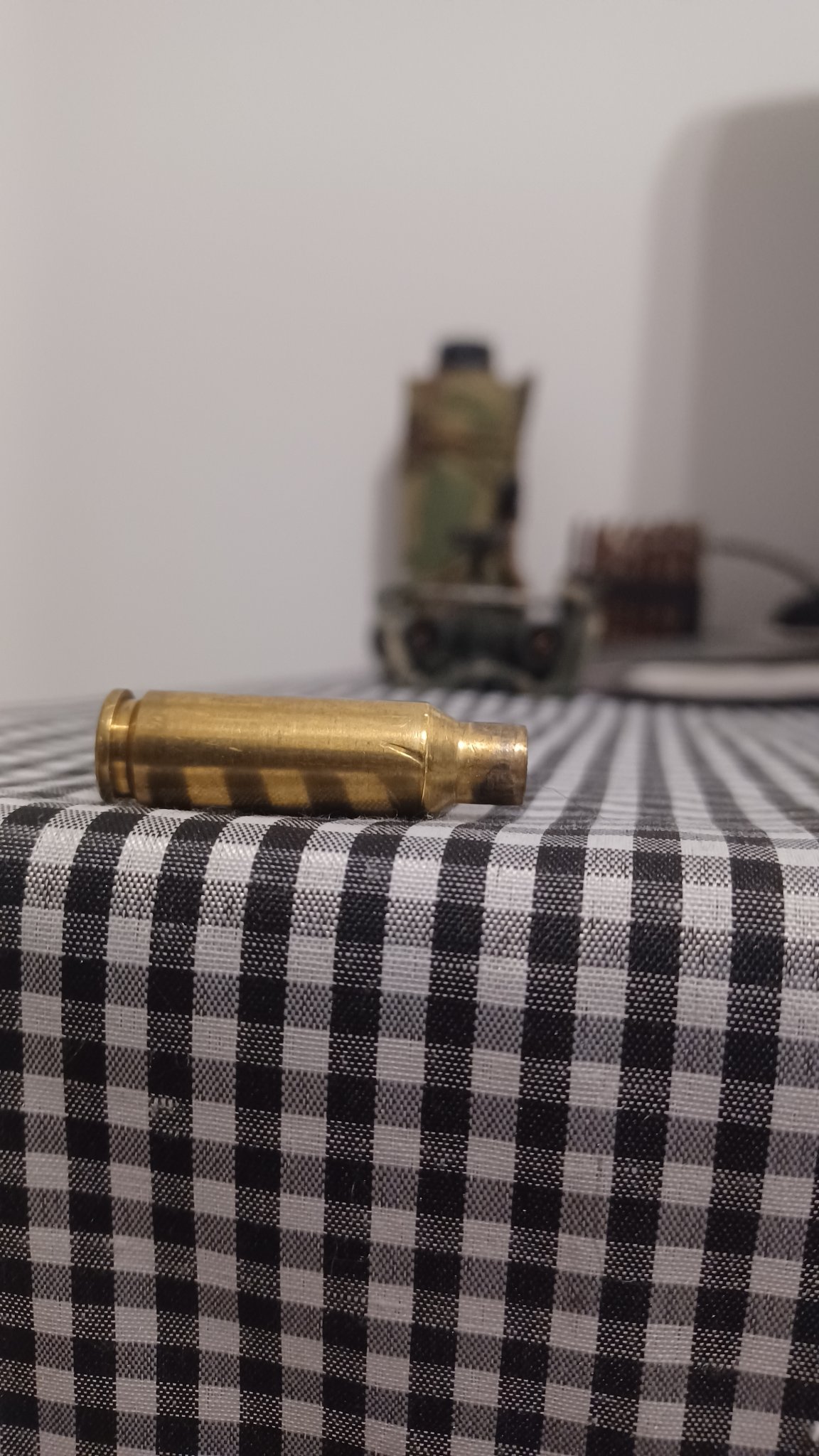

    Now let's move on to fired pieces of brass...
    The two loadings that I've fired are 123 ELDM & 90 TNT. Both types feel significantly heavy or difficult I should say to chamber. I still get the same feeling as if the brass is long so I have to really push the bolt forward after it "stops" in order to lock it down. Only difference is, with loaded ammo, coming down is easy. On fired brass, coming down takes considerable force.
    Another observation I made on the fired brass pieces, some have a weird mark on the neck/shoulder junction. This includes both federal and hornady brass.
    This is a federal brass but the same mark can be found on a few Hornady pieces. This is not on all fired pieces but only a few.

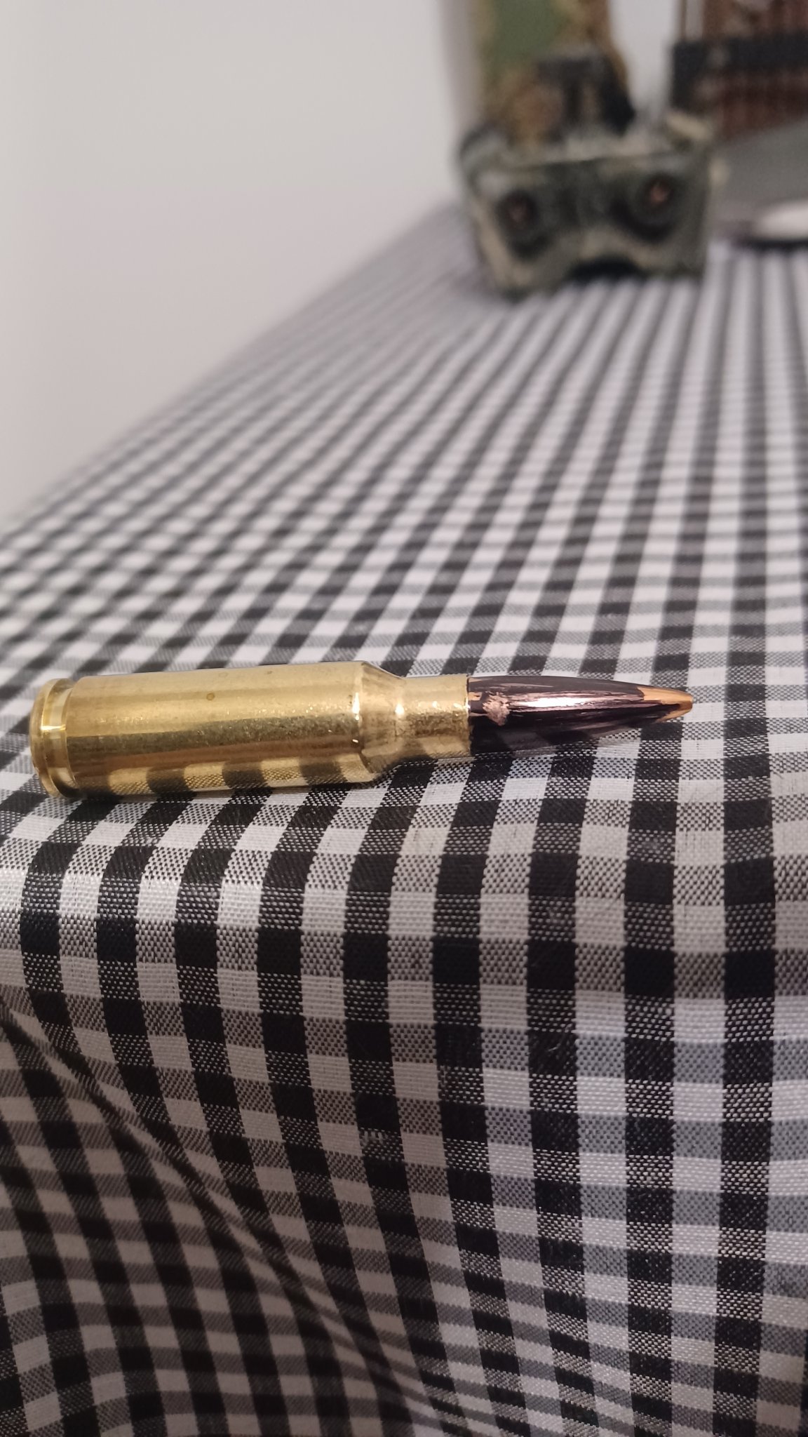

    Another observation I made...
    On the fired brass pieces, since it takes considerable force to chamber, I decided to try something. I tried chambering the brass multiple times in an attempt to see if I could get anything to mark or imprint itself on the brass. Sure enough, it seems there is one area where brass is being "scratched" maybe??
    We can see on the above pic a mark that appears only after chambering the brass many times.
    So after all, I'm guessing there is a shitty chamber job on this rifle. The chamber might be too short and possibly the throat too??
    View attachment 8241079View attachment 8241080View attachment 8241081
    View attachment 8241082View attachment 8241083

    It's hard to tell if it's a reflection from your table cloth, but is there gas wash, or signs that gas has been deposited on the brass in the location of that creasing?

    Oh and before I forget, because I'm still curious, does anyone think those marks on the sharpie bullets are from the lands touching the bullet?
    If it’s that wide and only that one spot most likely it’s rubbing there when it’s extracted and the ejectors spring pressure pushing it to slide against the chamber and action on the way out is where the mark is from. Remove the ejector and test to confirm.
