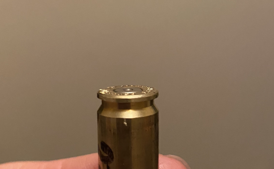

Heavy buffers & Brass
I have a 26” barrel and rifle length gas system. 6.5 Creedmoor.
Thank you
Ouch. I doubt you can fix that without a resorting to a new barrel. Your bolt is unlocking way to early and I doubt any amount of buffer weight will fix it. You can try to help out as best you can by going as heavy as you can find. Do they make 1lb buffers? 😂
Get a new barrel or cut that one down to 18-20” in length would be the correct action. You may have to enlarge the gas port if your rifle won’t cycle reliably after you cut it down. The super heavy buffers are expensive and I doubt it will solve your problem. Put that money into one of the options above.
Reactions: 232593
What else have you tried? what are your other parts of the gas system? theres almost always a way but Its going to be a trial and error tuning the whole system. buffer/spring/adjustable gas.
the way I do it is change one thing at a time either spring or buffer and then go through different gas settings to see how it functions.
and you can put a piece of the fuzzy velcro on your deflector to help reduce the denting.
I don’t get denting, but thank you for that Velcro trick. As far as I can tell it’s the extractor chewing up the base of the cartridge.
Reactions: 338dude
pics? that doesnt sound like it has anything to do with the gas system. ive seen where the little rubber O ring inside the extractor causes issues. most people just remove it.
Reactions: Plinker 73

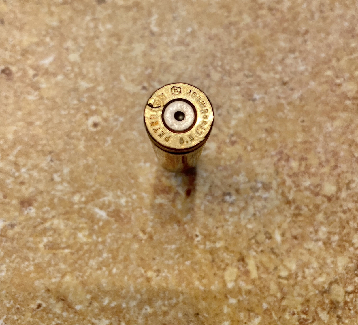

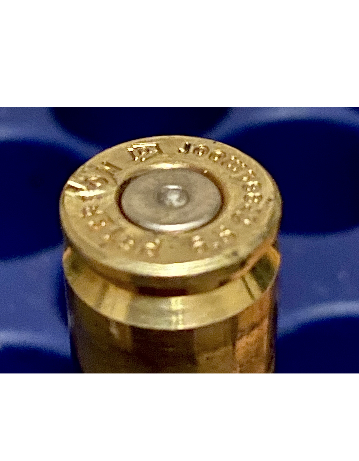

I won’t be able to post pics for a few hours. It kind of looks like a cut in the base of the case. I am two grains below max powder charge.
Its extracting far to early because of the gas system. I’m not sure the buffer can be weighted enough to fix that issue with a 26” creedmoor barrel with a rifle length port.
it's possible. but if its marks from ripping the case out like you say then it sounds like an excessive gas problem. adjustable gas block would help that.
I have a rifle length on a 6.5cm and run a low mass carrier and light SCS. gas is set at about 7/15 on an SLR.
Reactions: KYAggie
An adjustable gasblock doesn’t help timing. That’s why there are different gas port locations from carbine up to plus three. Plus 2 gas on 20” barrels is common. What length barrel do you have?
I said he could cut it to 18”-20” as well. The gas length is wrong.

Yeah we may not even be barking up the right tree marks on brass is pretty vague
Here are the pics of the brass. The damage is on the left side
Thats a gnarly ejector smear. The bolt is definitely unlocking too early. I bet that piece of brass wouldn’t fit in a shell holder without filing down the ledge. My friend has a 20” rifle length and his does that with a suppressor attached. His lower has the lighter and shorter .308 buffer that fits in carbine length receiver extensions.
Weight up the buffer and use an adjustable gas block and if that doesn’t help then read post #5.

With how minimal the "soot" is on your brass, I don't think the pressure/blowback is really not that bad on your gun
