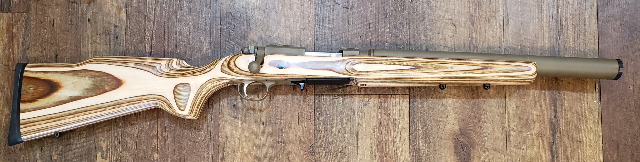

Integrally suppressed my Ruger 77/357
Since I want to shoot subsonic ammo, I am looking for a heavy bullet. I hit the speed limit of ~1000 fps, so the only way to increase energy for hunting is to increase bullet weight. I read a lot online and pretty much all of the info is for revolvers. They discuss maximum length for the cylinder length... That is less of an issue in a rifle. I have seen reload info for 200 grain, but not much heavier. 200 grain bullets are much faster than I want to go, so can lose a bit of case space (prefer not) and go to a longer OAL.
1) What is the maximum bullet weight possible (I have seen 210 grain) but hoping for a 240 grain?
2) Does anyone make a heavier bullet plated or jacketed bullet than 180grain?

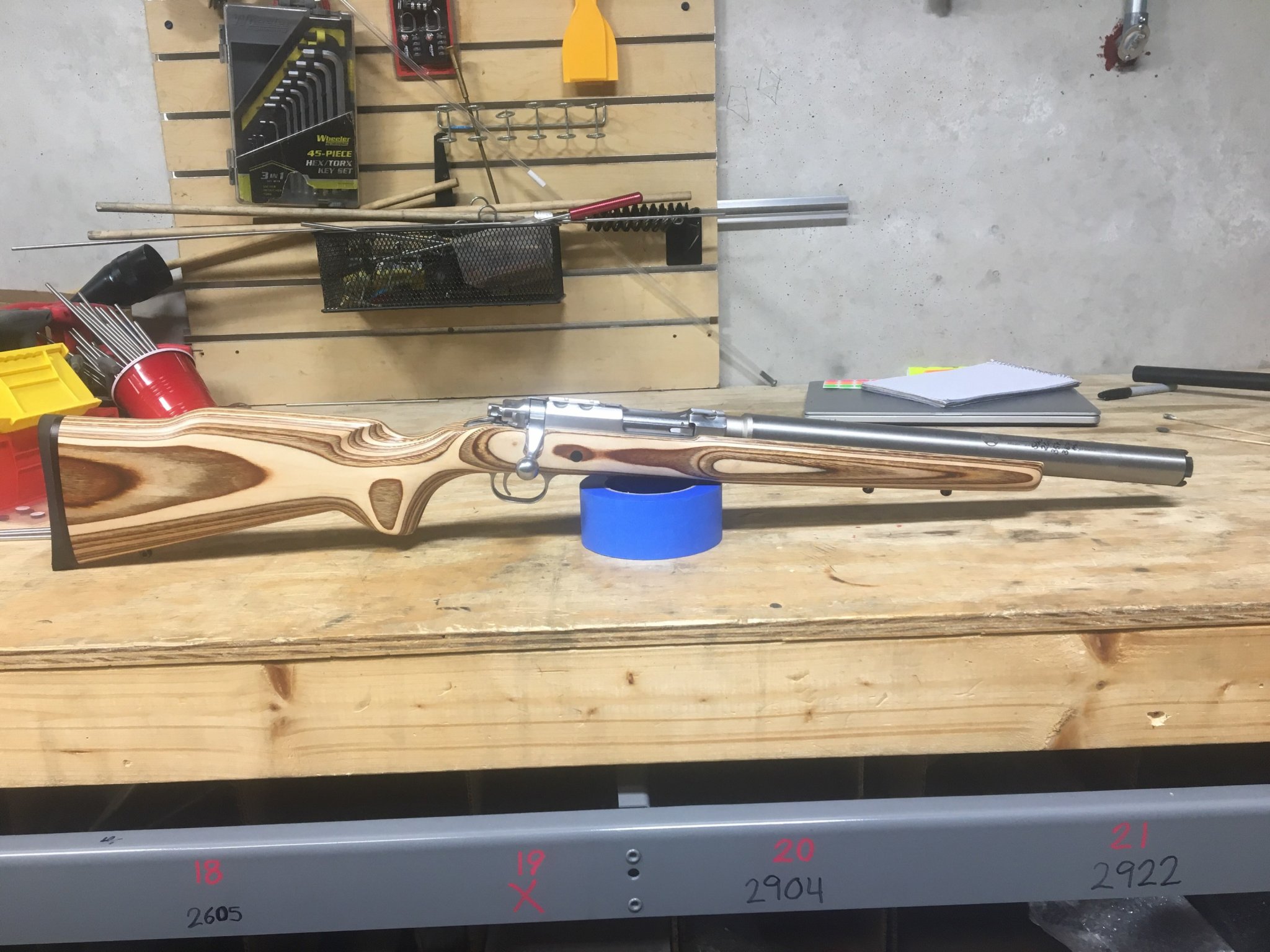

I SBR'ed a 77/357 and with a 12" barrel (yea, wish I had gone shorter but could only get about another inch w/o stock mods) 6.3-6.5 gr of Unique with a 180 gr XTP should have you about 1050. I have read feeding is an issue with longer bullets. I had problems with loading the 180XTP's to max mag length. There some 190-210 cast bullets out there, not sure if anyone is still making a 230, but I haven't tried cast.

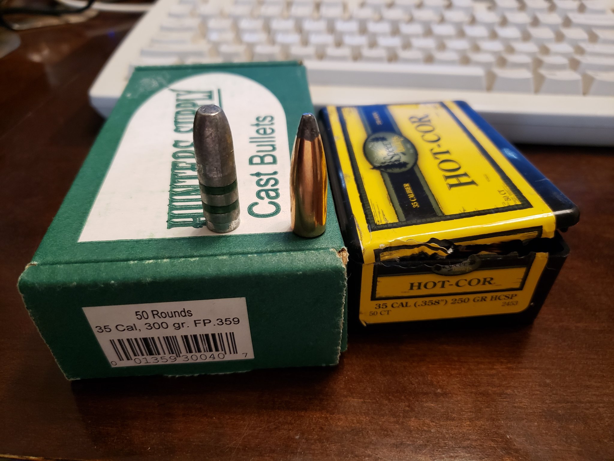

Same bullet as a solid (270gr) and hollow point (255gr) next to the .358" 200gr Hornady SP and a cartridge of my own design.

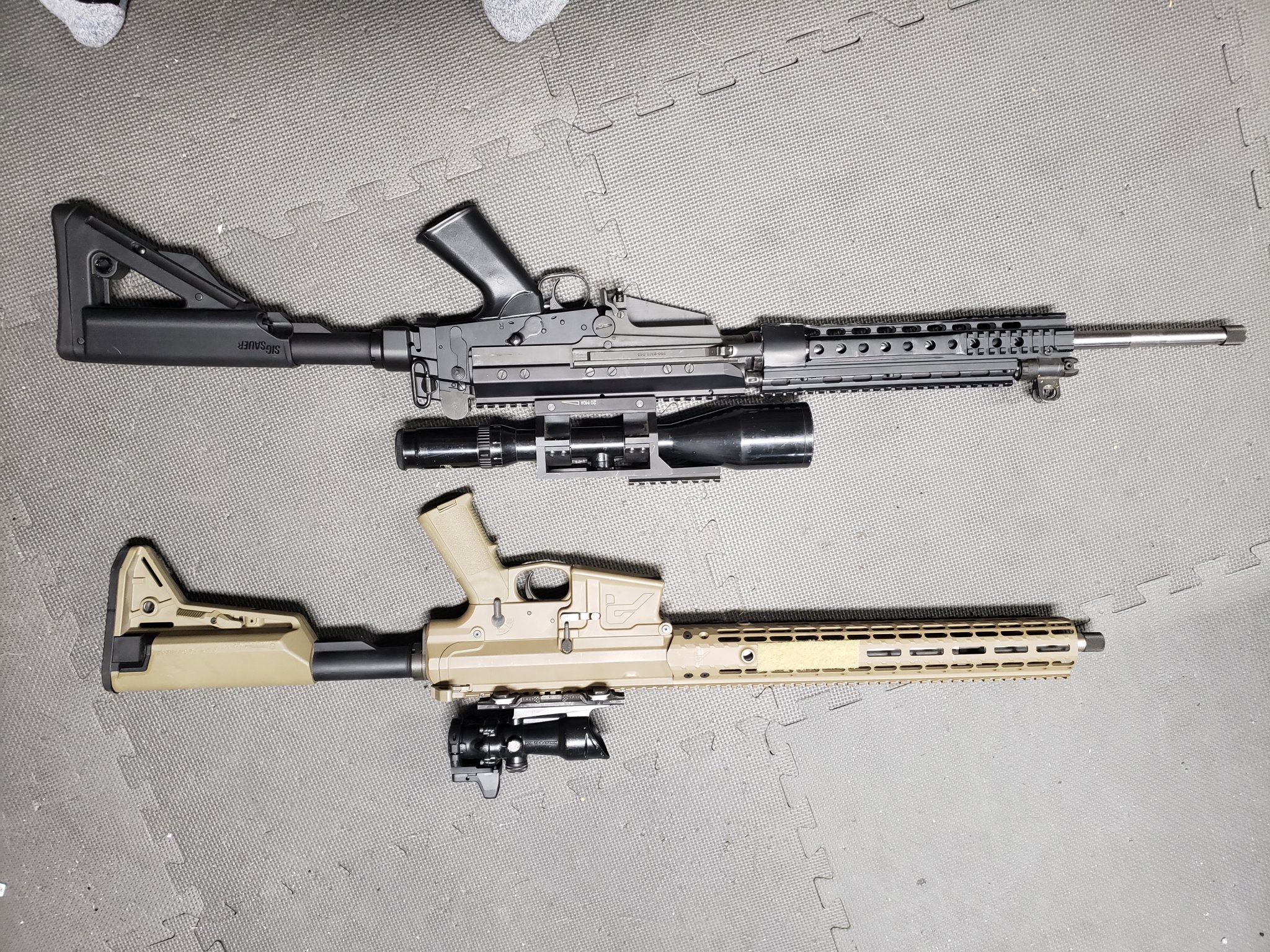

132 DB was from my .46 can on the FAL with gas on (hybrid 46). FAL actions make a lot of noise, if I turned off the gas it is much quieter (no readings). The FAL gas system is much more adjustable and reliable, so I use it more, the issue is since it is piston driven, it dumps gas at the gas block and this gas makes noise so you hear more (higher DB).
Do not have the bullets but will post some up when I go hunting in the fall, it is too hot now, (high 90s). The recovered bullets were from older hogs we body shoot. I have shot 30-40 older hogs with that load, and I do not go looking too hard for the bullets, so the ones I recovered had less penetration, so hitting something hard like bone is very possible. We head shoot the smaller ones (just behind the ear) so we do not waste meat, and the bullets usually just zip through. When I see a bunch of hogs, I head shoot the smallest one first so I have some meat, then keep shooting the bigger ones till they are gone.
FAL has a modified Winchester 700 barrel, while the AR has a Wilson 358 win barrel.
