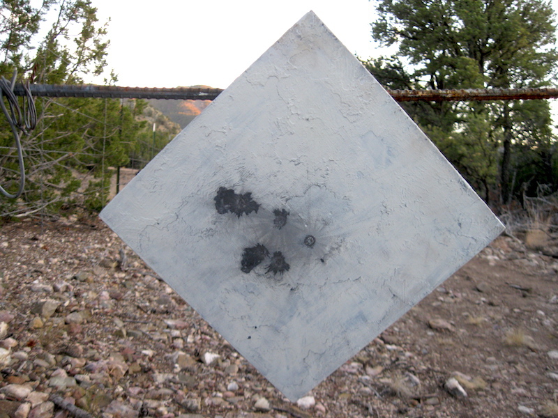

After forming, I resized the brass and turned the necks to ø.265" on a .224" mandrel, then annealed them, and loaded some up at 37gr of H4350 with Hornady 88 ELDs and compared them to my original set of 50 brass over a chrony. They were about 24fps slower, I suspect this is due to differences in neck tension after being treated slightly differently for neck-turning before bullets were seated. To bump the velocity back up I added a quarter grain and compared them on steel at 525 yards.
5 rounds of the original set of 50 on the right, adjusted windage .4 mil left, and shot 5 more with the new lot of brass.
Cold bore shot is the high, right-of-center shot.

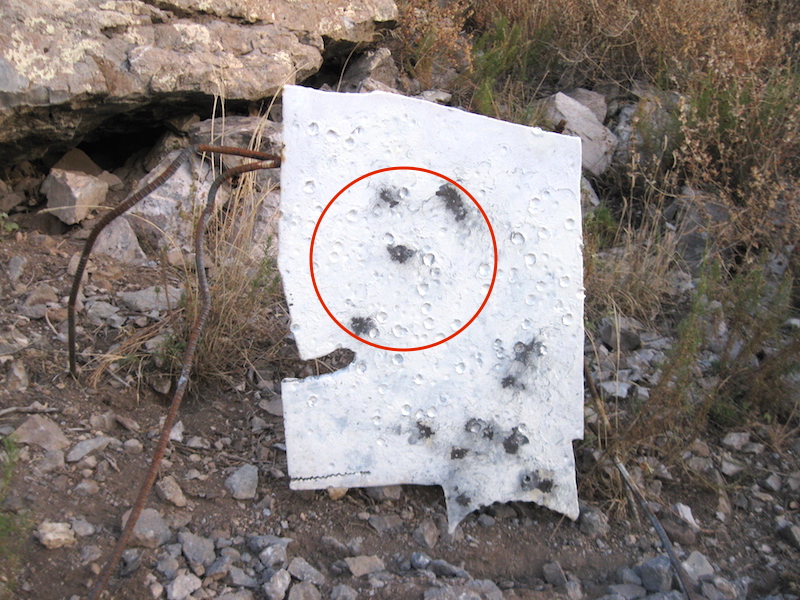

I'm just updating the thread here. Round count's up to 355 and the throat doesn't look bad. Some fire cracking, but nothing too concerning yet. Now all the brass have been re-processed in the same fashion so the next 100 rounds should be uniform. The other day I installed some HD flushcups in this laminate stock, and today I took my 16lb rifle for a test-drive: 4.5 mile hike to a deserted mine wtih a convenient ridge to shoot from 1100yards away.
Every once in a while I try for groups to confirm it's still behaving like I think it should.
Here's another group at 525 yards, seems consistent so far (.59MOA)
And here's 965 yards (.75MOA). Target's roughly 15" x 19"

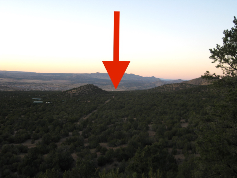

965yd shooting position:
Had a great weekend outdoors.
