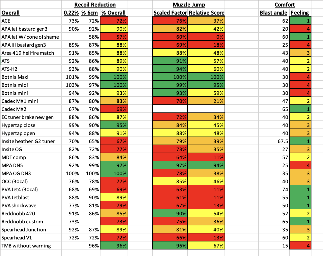

Been using a DN5 since end of Nov, have 1k rounds on it. Has a very good blast/concussion shadow for shooter, I've never felt the concussion. Note 1) I'm not running the hottest loads 2) I've had people in my squad comment how loud it is (although I don't really agree w/ that, I've been next to it too) 3) I'm not blast/concussion shy
I can't remember shooting a Hellfire
Reactions: Gquire
Thanks for the first hand info, appreciate it.
The 419 brakes are some of if not the worst brakes when it comes to concussion and throwing shit back to shooter and people watching. Add in shooting under cover and its like getting hit in the head with a hammer.
For something like a dasher you do not need the absolute maximum braking of something like a fat bastard gen 3 or a A419.

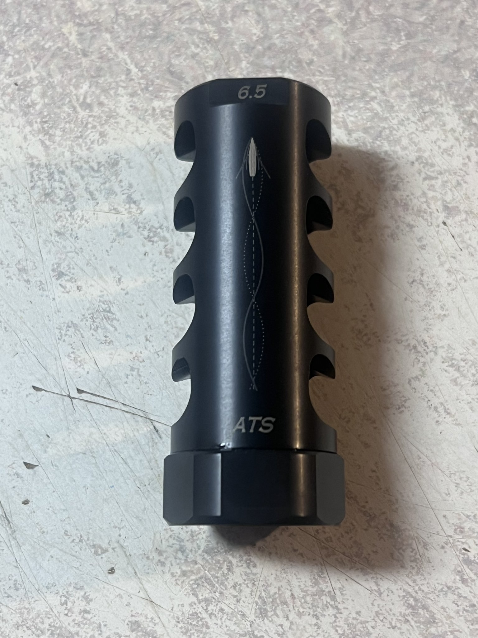

Look at the ACE and the ATS Brake. Both are very good at managing recoil while being very shooter friendly and not giving you a headache after shooting all day.

Here are the results from a pretty good test that Yanick Sab did. I changed color codes to be a little easier to see.
You can check out his YouTube videos for the full test.

Yep I watched it last night and I am sold on the ATS will probably order this weekend. Thanks for posting.
If you watch the video, he labels feeling one through four with one being the least concussion at the shooter and four being the worst
Interesting to see the TMB perform so poorly in that category - I thought that was one of it's main selling points, that the giant tuner weight collar deflected blast away from the shooter.
Reactions: Comptime6
Unfortunately, brakes that perform better at reducing recoil will be more uncomfortable at the shooter.
As far as other claims, you can't get around that. If you have something behind the ports that deflects gas, that in turn will counteract the recoil reduction of the brake. You need gas pushing the rifle forward, which means gas coming back towards shooter. Deflecting the gas after that just pushes the rifle to the rear again. So, if his collar deflected the glass, it would in turn reduce the recoil reduction performance.
I hear you.
I was just surprised given the hype around this specific brake. Specifically, from what I heard in a podcast or two from shooters (that *wink* may be sponsored by TMB). They made it sound like the TMB could cure cancer :ROFLMAO: I guess it doesn't after all.

Agreed. A lot of it is perception as well as points per match performance for people.
Take a look at the "feeling" category. A lot of the green and yellow brakes, people will swear they cut recoil down much better than other brakes. When in reality, they are just shooting better and/or staying on the gun better with a more comfortable brake. Which is great for them. Just not the reasons they think.
For many people, getting something like an ATS brake that is more comfortable for the shooter, and still relatively high in recoil reduction, will net better match scores than going with a Botnia Max that reduces more recoil, but gives them a headache halfway through the match.
One important thing to look at muzzle brakes is efficency, which is mostly ignored.
As @kthomas said, who cares about 11% this, or 8% that.
If brake A is comparable to brake B, but its physically half the size, would brake A be more efficent as its handling gas, recoil, muzzle jump, pulse rate, etc. ?
I dont like having to have a brake twice the size and weigh twice as much to get 5% benefit.
Juice isnt worth the squeeze.

So it looks to me like the gills on the ATS are angled back to me...so your saying that there is no back blast on the shooter? Serious question because I have one in my cart but just want to verify that.
So I have an ACE and it performs just fine, but have been looking at the MPA DN5. Based on this conversation that one is out of running. My alternative was the ATS or The Chad if it ever comes available to order.
It has the least amount of back blast and side blast of any brake we tested. Its not just the blast angle but the fluid dynamics of the blast. You can stand right next to someone shooting it and while you feel the blast you do not get the ringing concussion you get from other brakes. I don't understand WHY, I just know it works.
In fact, I ordered another one today :)
