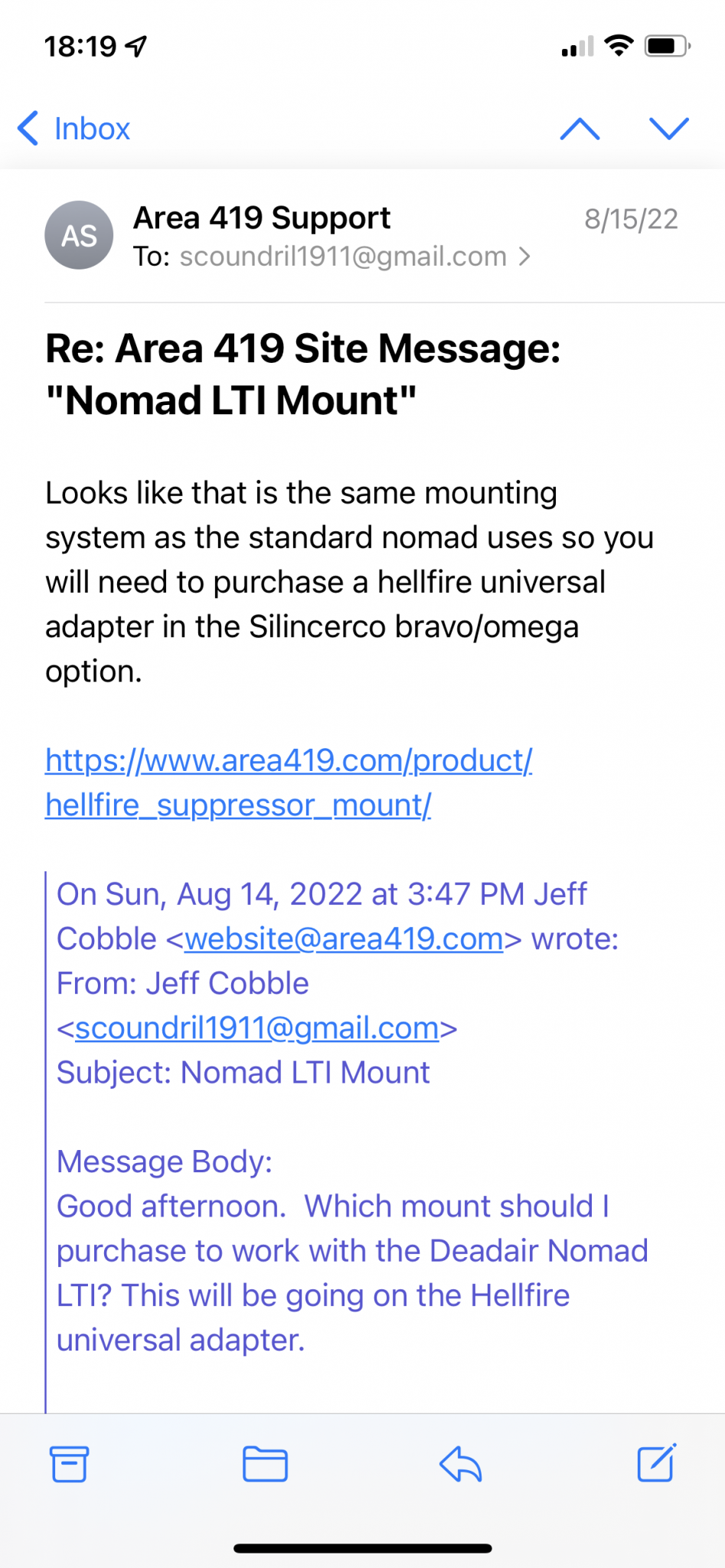

Does anyone make a Hellfire(Maverick) to Xeno adapter? Or is there any good solutions to being able to use both a Nomad and Maverick suppressor?
419 makes an adapter that goes on a nomad. Depends on if you need it to work on other rifles sans 419 adapters. I have mine done that way.
I'm a little confused, so sorry if I am misunderstanding...
Yes, A419 makes a hellfire adapter for DA Nomad (Ti and regular Nomad use the same adapter).
You are asking about a hellfire to XENO adapter which wont work as the are both adapters to run a can on.
What exactly are you trying to do?
Run the Nomad Ti on your Xeno flash hider/break and also use it on a rifle that has a hellfire adapter?
Unless i am misunderstanding you, you would have to choose whether you want to run the hellfire or Xeno on your rifle. I originally had hellfire running on all my rifles and then switched to Xeno as I liked being able to keep my muzzle device on the rifle when running a suppressor.
