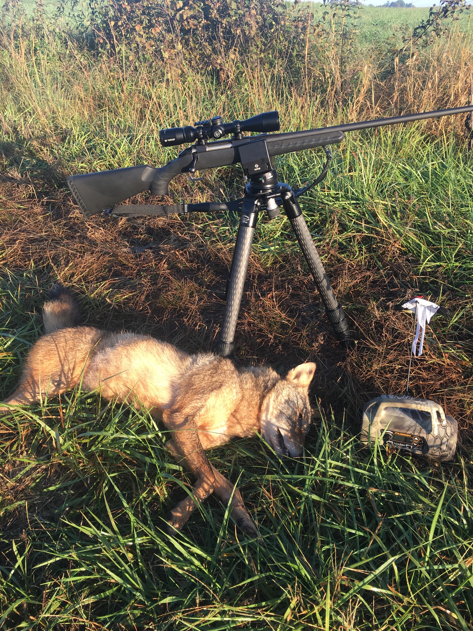

The PVA tripod with RRS leveling base and VYCE. I don’t see how any other setup could be as more effective as this.
I bought the vyce so I can use with a variety of different weapons as well as let my buddies use if need be.
I will be using this for PRS and obviously predator hunting. This photo was from my first set this morning with the setup.
125 yards. Dead in his tracks. The PVA tripod is the best bang for the buck in my opinion.
