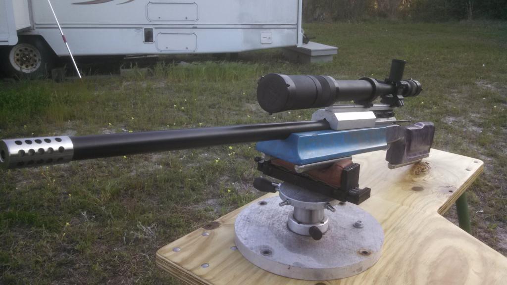

Rifle -- You guys suggested several different varitions, but most agreed that CheyTac makes the best long distance rifles of today. Let's call his particular weapon Intervention M600 (it's not a real model, which helps when trying to make an "impossible shot" less unrealistic)
Rounds -- Hand made .408 caliber hardball bullets
Scope -- A networked IR tracking scope wired to a satellite or surveillence camera closer to the target.
Heavy rests -- rear and front for rock solid stabilization.

As the shooter has knowledge of where the target will be the next day he has about 12 hours to choose a perfect position. This is what you guys have provided me with for this shot.
-Time, early morning: for calmer weather.
-A high altitude position: for a desired angle to improve range and stability of the shot.
-An Avenue Approach: along one of the bigger roads of the city. The warmth of the traffic below will also help improving flight distance.
-Prone position
-Time window: the target will stop at a zebra crossing, and the shooter's spotter has hacked the traffic lights to keep it red a couple of minutes for final adjustments to the to the tracking scope, as well as attaining a lock on the desired target. Then he will count down (keeping in mind all relvant delays, including bullet travel time) and then turn over the sights to the shooter for a few seconds so he can aquire the right target as per the previously locked in settings of the computer scope.
-Satellite information regarding weather conditions, intersection draft, coriolis drift, gyroscopic drift, poisson effect, will all be factored into the calculations of the tracking point scope.

VaRandy: I assume that's the Wildcat you were talking about before. Nice picture.
