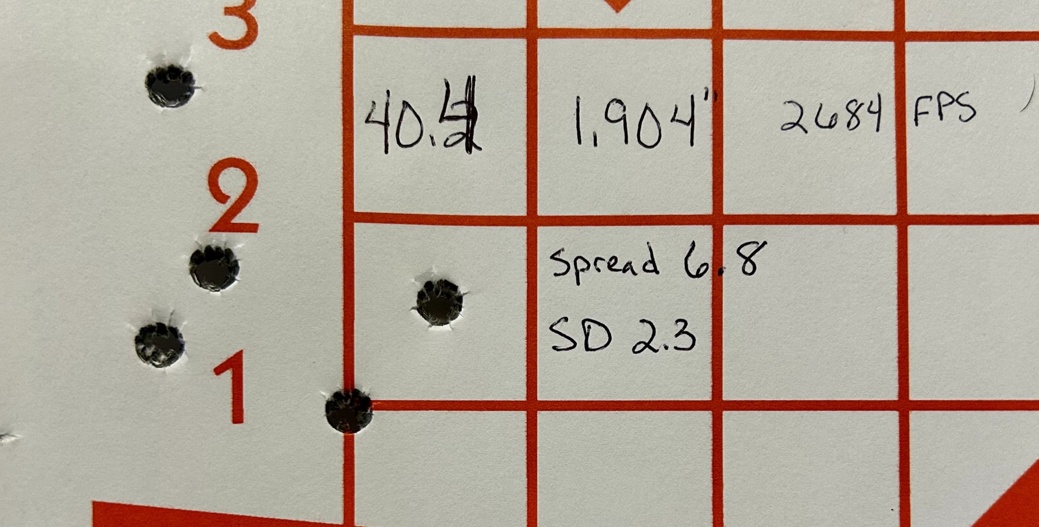

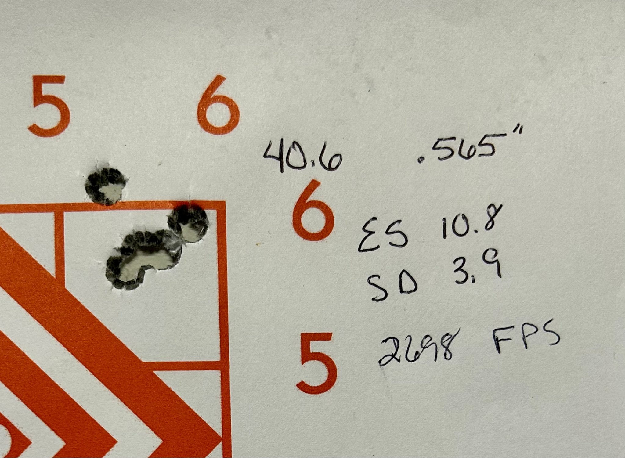

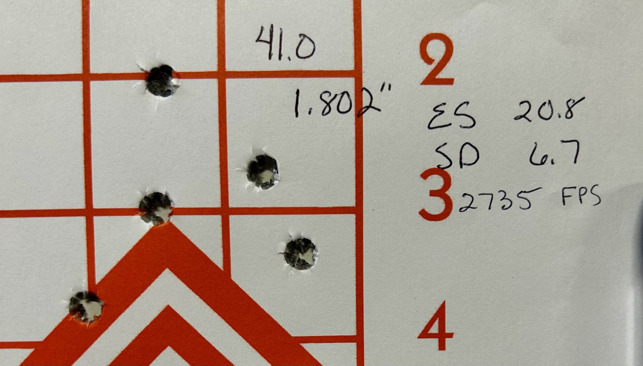

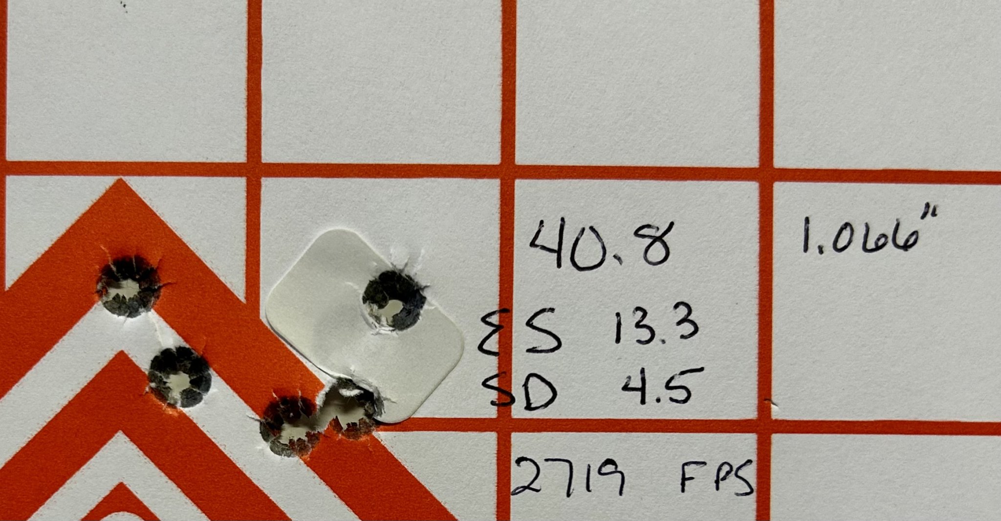

I took my 6.5 out yesterday and did some load testing with what I would call “odd” results. Components used were as follows, Nosler 140 RDF, lapua SRP brass, H4350 powder and Federal GM205M primers. I shot at 200 yards as it was a super calm morning. I lost the first 5 round group but found 3 of the shots at about 1.9 inches for a group. I have posted the results for the other 4 groups below. What I found “Odd” was how quickly it went from 1.9 inches to just over a half inch and then back out to 1.9 inches with just .6 grains of powder difference. Anyone else find this strange? I’ve loaded some more rounds up at 40.5 , 40.6 and 40.7 grains to take back out and see if the .570 group was a fluke and if there are any gains to be made.

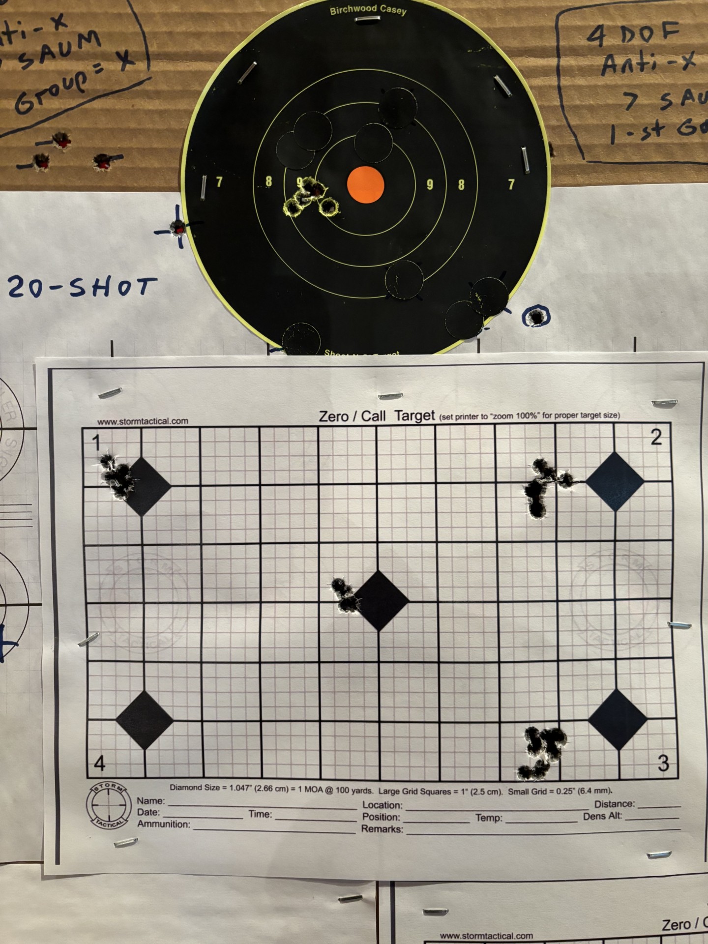

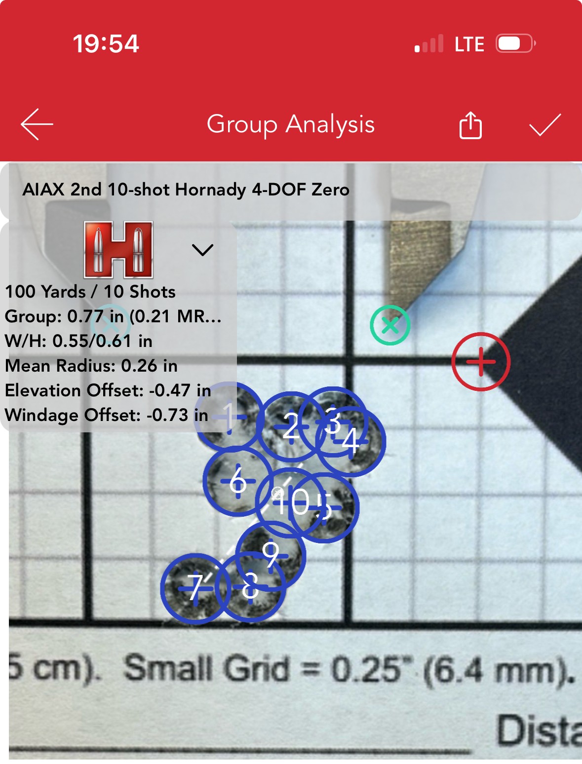

You're shooting almost the exact same load I've been using for 2200+ rounds in my AIAX 6.5 CM (140 Nosler RDF, 40.6 gr H4350, Lapua SRP, CCI 450). There's nothing inconsistent or wrong with the RDFs, especially at shorter to mid ranges. See the pictures below for proof. Those bullets and that load shoot like that all the time. What you're probably seeing in those results at 200 yards, is the normal dispersion profile of your system. Shoot more groups at 100 yards and quantify it. You'll probably find 3/4 MOA is as good as it gets. It is for me. I'm happy with it and it works.
I used to chase my tail like in circles like you're doing, playing around with 0.1-0.2 grain movements in powder charge and OCW tests, but no more. The stuff the Hornady guys put out in their group size and sample size podcasts pretty well proves the futility in that. It'll save you a lot of time and frustration by just picking a load, shooting a good sample size, and applying those results to your intended use case.
