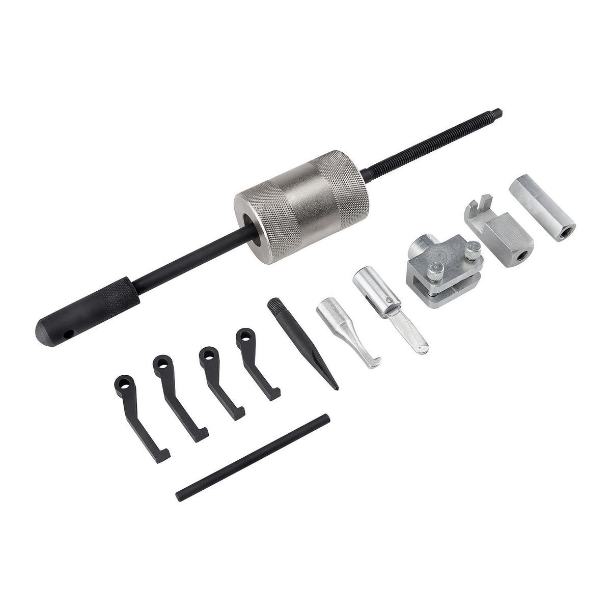

I'm not sure that I'm following. Are you using the type of broken shell extractor pictured below? You said "bolt stuck in action", did you mean "bolt carrier group"? Is the upper and lower mated together (or able to be mated together) with the BCG stuck fully in battery? Have you done anything to the BCG, like removed the firing pin?
