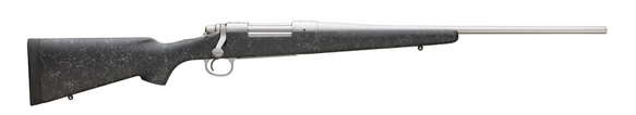

700 Mountain SS / 22" / 10" / 416 Stainless / Stainless / Bell & Carlson Aramid Fiber / 6 1/2lb

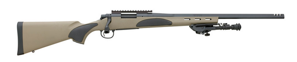

700 VTR / 22" / 10" / Carbon Steel / Matte Blue / Synthetic w/Hogue Overmold Grip / 7 5/8lb

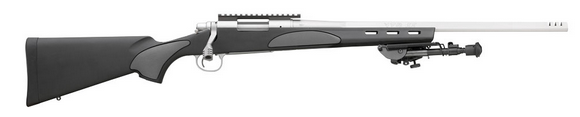

700 VTR SS / 22" / 10" / 416 Stainless / Matte Blue / Synthetic w/Hogue Overmold Grip / 7 5/8lb

The VTRs come with a pick rail on top and a bipod as well as heavy triangular contour barrel with integrated muzzle break
The Mountain is 1 1/8lb lighter

Of your choices I'd go with the mountain ss. Weight will be similar compared with the vtr once you add a bipod an rail. But that hogue stock is complete junk on the vtr especially with the bipod use. If you plan on upgrading the stock then i forget the three you have listed and look at the sps tactical aac-sd 20" heavy threaded barrel. 1 in 10" twist compared to the 12" twist

I'd go mountain but with a non stainless finish on the barrel. Not fond of shiny hunting arms.

The stocks that are listed are not Hogue stocks, just have Hogue grips built in.
They're still the typical Remington stocks, JUNK.
The stocks flex too much for very precise shots.
The VTR stock feels alright for an injection molded stock, but that isn't saying much. It works well for a hunting stock, as it isn't that heavy.
I own the VTR and don't care much for it. The built in break isn't much, the stock is alright, and you cannot thread the barrel. Mine is an alright shooter and would probably do good with a different stock.
Also, like what was said, don't get a package deal for the package. Remington scopes are junk. I bough a Walmart 700 that came with the scope. My GF would make a shot, we'd adjust for it and the scope would track PERFECTLY. Then we'd adjust it again and it would be off the paper. Shoot again and it would be close, but not where we adjusted. Shoot it again and it would be way away from the original group.

The 700 mountain ss is an excellent choice. It will be money well spent and you won't experience buyers remorse afterward. Scope, sling and your good to go.

I'm leaning towards the 700 Mountain SS.

I had a VTR, and was unimpressed. Now let me say, it wasn't a bad rifle, but at the end of the day it shot a little better than my regular sporter barrel 700, but the muzzle brake didn't seem to do much to reduce recoil (probably because if you look at it, the rifling ends and the barrel diameter opens up before the brake. The brake did manage to direct more sound back at me.

I would guess that you would be quite happy with the 700 Mountain Stainless. The only real downside I've heard to stainless is that is more shiny... well that's an easy fix with same paint...search the forum, you'll find plenty of threads about people doing very nice finishes on their rifles, usually camo but the same techniques and paint types in black will give you a rifle that looks like the non stainless version (if that's what you want).
