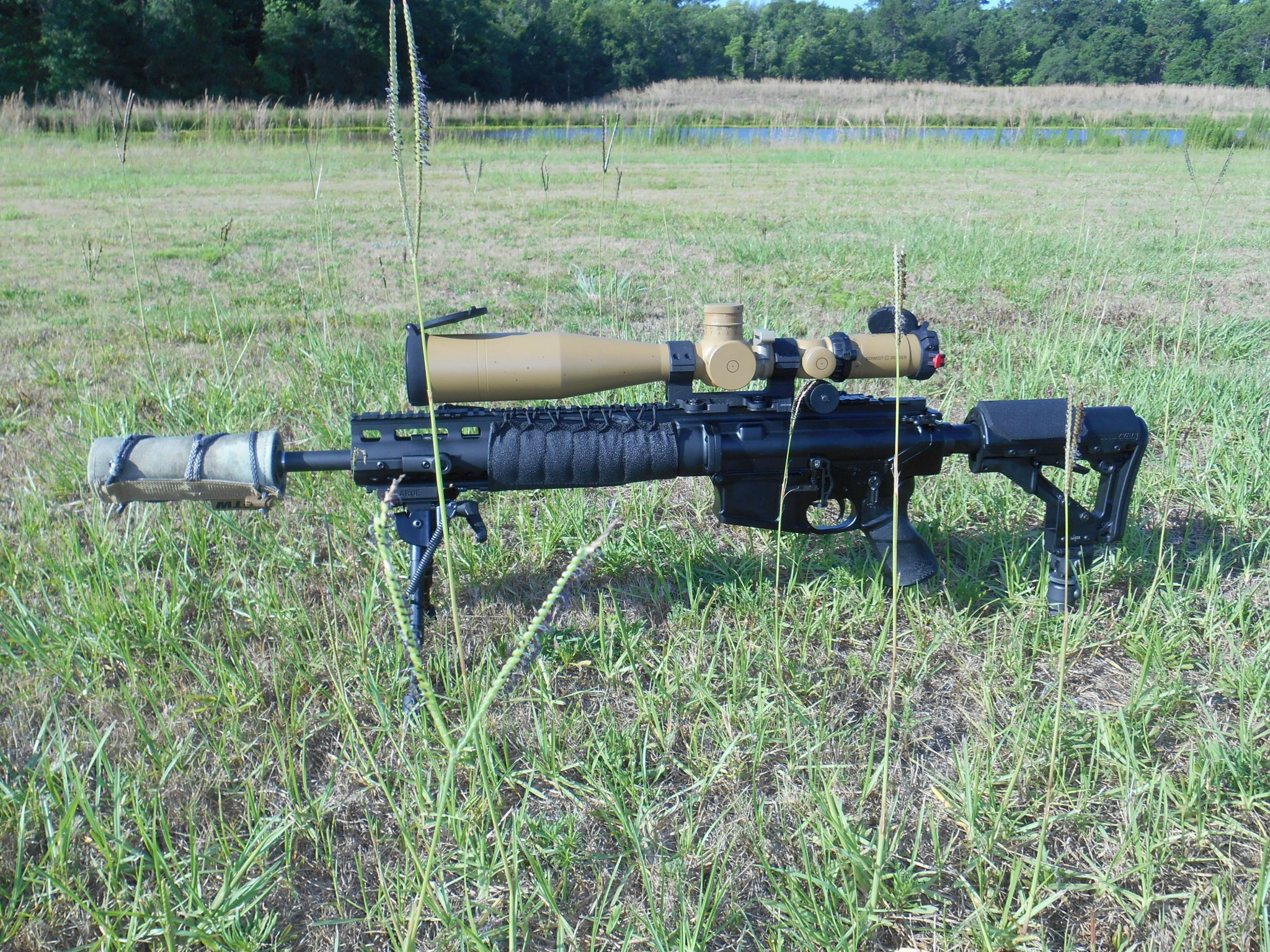

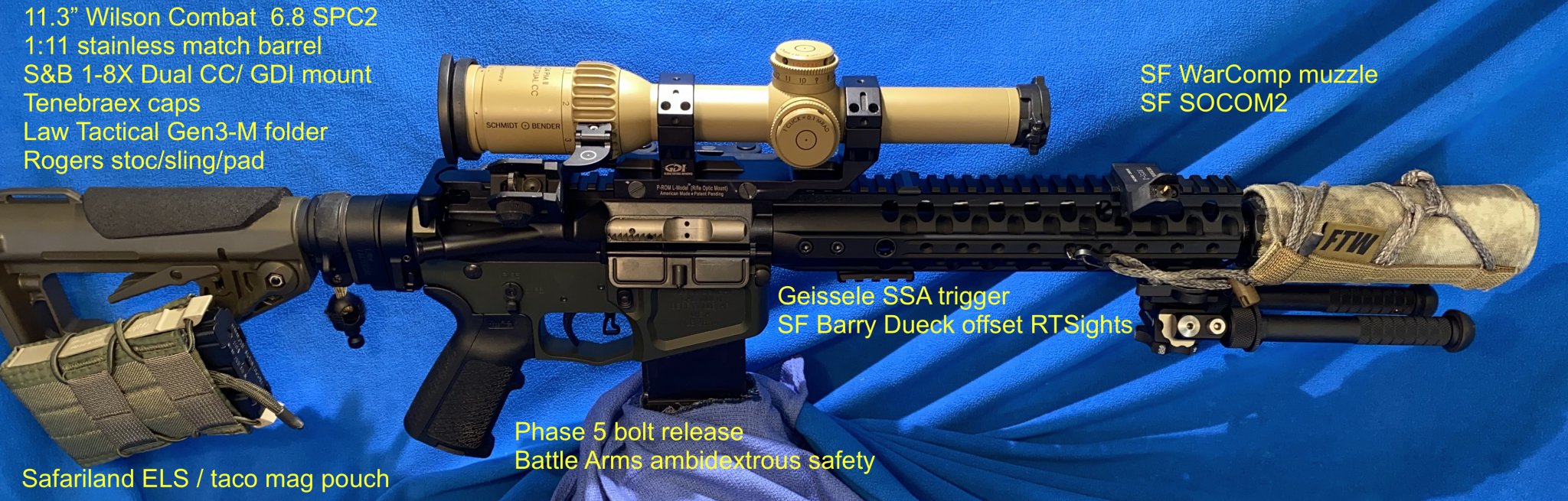

I have a GDI mounted on a Wilson 11" 6.8, a Spuhr on 14.5" SR-25 and LaRue LT111 on 16" OBR. All have performed nicely with return to zero as I usually do not keep the scopes mounted in their respective bags. In the 2010 International Sniper Competition service members Homyer & Gianelli won first place using 16" & 18" LaRue OBR’s, Night Force Scopes w/ Horus recticles and LaRue QD mounts. All are tier one qd mounts.
IMG_0182KAC SR-25 WITH SUPPRESSOR BLACK SCOPE & SLING RMR MOUNTED POOLSIDE 07.30.21 ANNOTATED ...jpg
Reactions: DesertScout23
