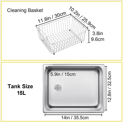

Like has already been mentioned, size does matter. For me sorting through the various tank dimensions was interesting. If you search for a certain size, 15L or 4 gallon for my example, you end up with several different configurations. I finally ran across this one that I think best will serve my needs:
One of the things you'll notice is tank dimensions are different from basket dimensions. Make sure you can get what you want cleaned inside your cleaner. My plan is to use containers with cleaner and parts inside the tank filled with water. Because of this I opted to error on the larger than needed size instead of ending up not being able to get the items inside the tank.
Another thing I noticed while shopping is larger tanks means more power and more transducers. This example has 6 or 6 X 60 for 360W. I also opted for one with a heating option to help with stubborn items.
Another thing to think about is the material used in the construction. Most will assume that the tank is stainless steel, and most probably are but a lot of units don't specify which type of stainless or the thickness. Just something to think about.
