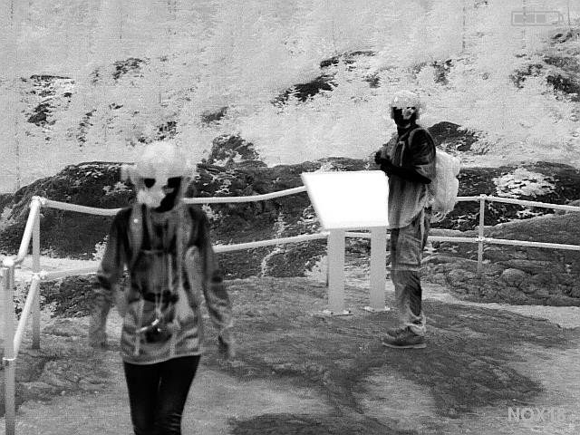

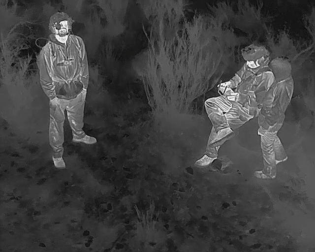

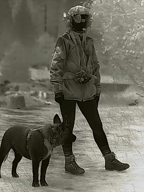

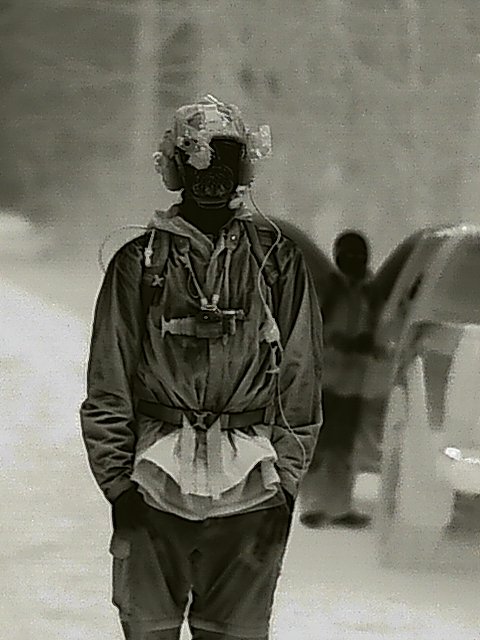

If observation/image capture is your goal then get the bigger lense. Small lense 640s are pretty amazing these days but a 50mm is gonna stomp all over them at range and even for fine detail at closer range.
Someone will probably be along to explain the whole pixel density thing but long story short bigger lense = finer detail.
18mm
25mm
35mm
Notice the finer detail on the 35mm and how the smaller lenses show the pixels faster when you zoom in. 50mm is even more noticeable.

What scope did you use for the 35mm pictures?
