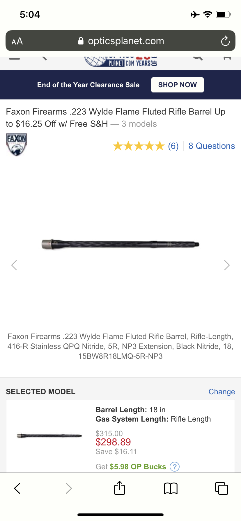

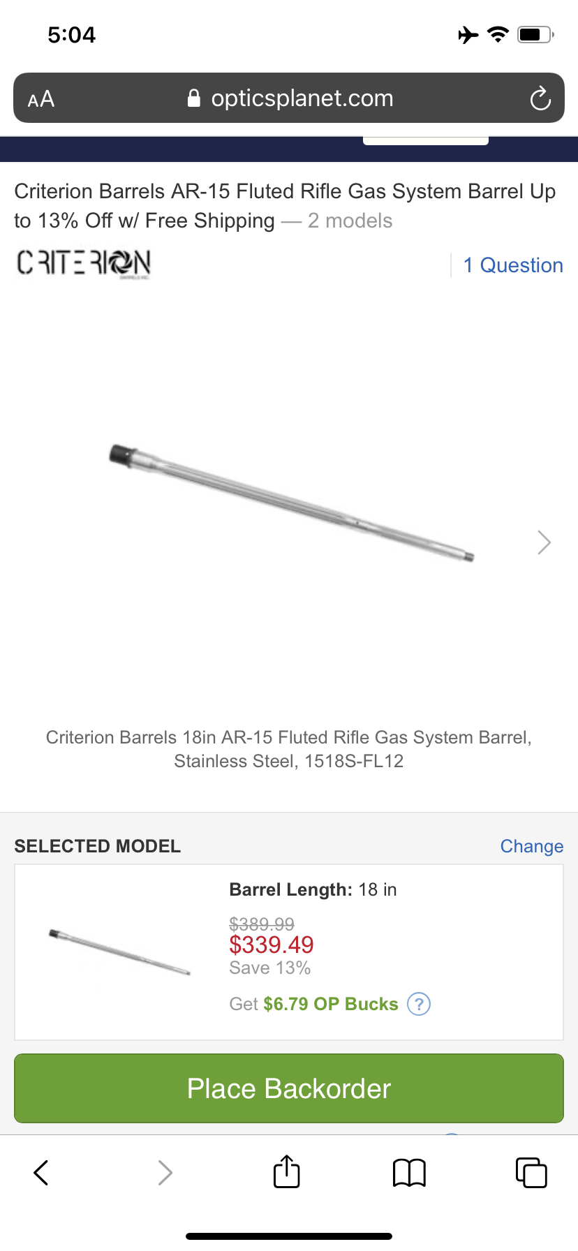

I’m have I got trouble deciding which one of theses barrels I should pick. I my main goal is under 1 moa for 5 shots. I have ballistic advantage that I’m sending back for inspection that I can’t get to shoot under 1.5 moa. Any advice would be appreciated!

You'll have the same issues with the Faxon that you're having with the BA barrel. Both companies seem to be having QC issues. The criterion is probably good to go. I'd be more inclined to go with an Odin Works barrel in your price range. Namely this one. https://www.gunbroker.com/item/884868924

Criterion without hesitation. They're probably the best overall value in barrels these days. I'd also consider White Oak Armament, X-Caliber, Odin Works, and maaaybe Wilson Combat in the same category.
If you can afford to step up the budget for Proof Research (that's a good deal up above!), Lilja, Bartlein, or Krieger barrel, you'll have better results - but you have to pay to get there. If you want the very best precision, then it's well worth the price in the long run. As a casual shooter on a budget, ~1moa or better is good for me, and Criterion one of the most affordable ways to get there consistently.

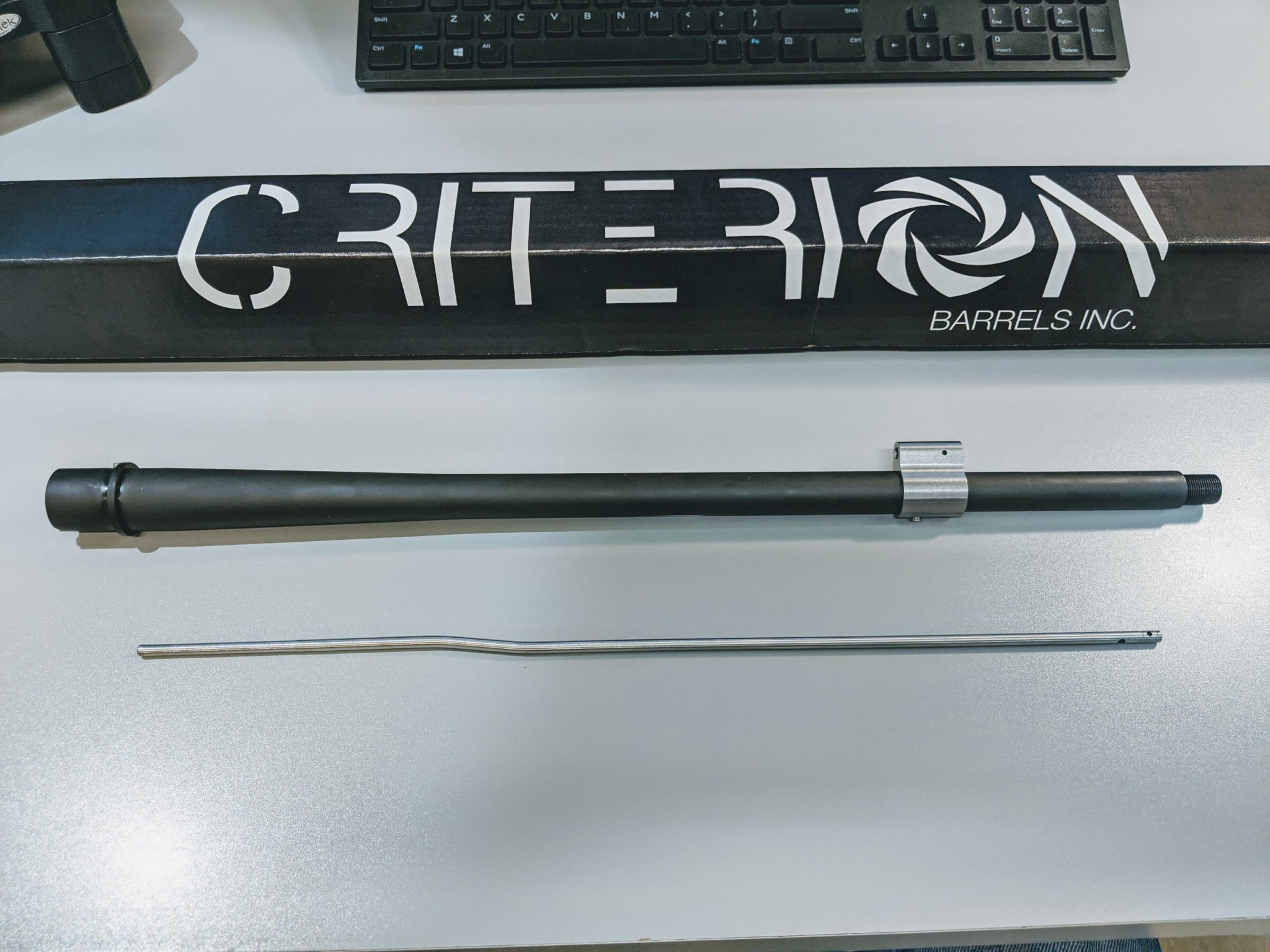

I picked up an 18-in Criterion CORE barrel. Wes @ MSTN really likes them . He ran a bore scope through it and was very impressed. These barrels are advertised to deliver a higher level of accuracy with the durability of a chrome lined barrel. You might want to check it out.
