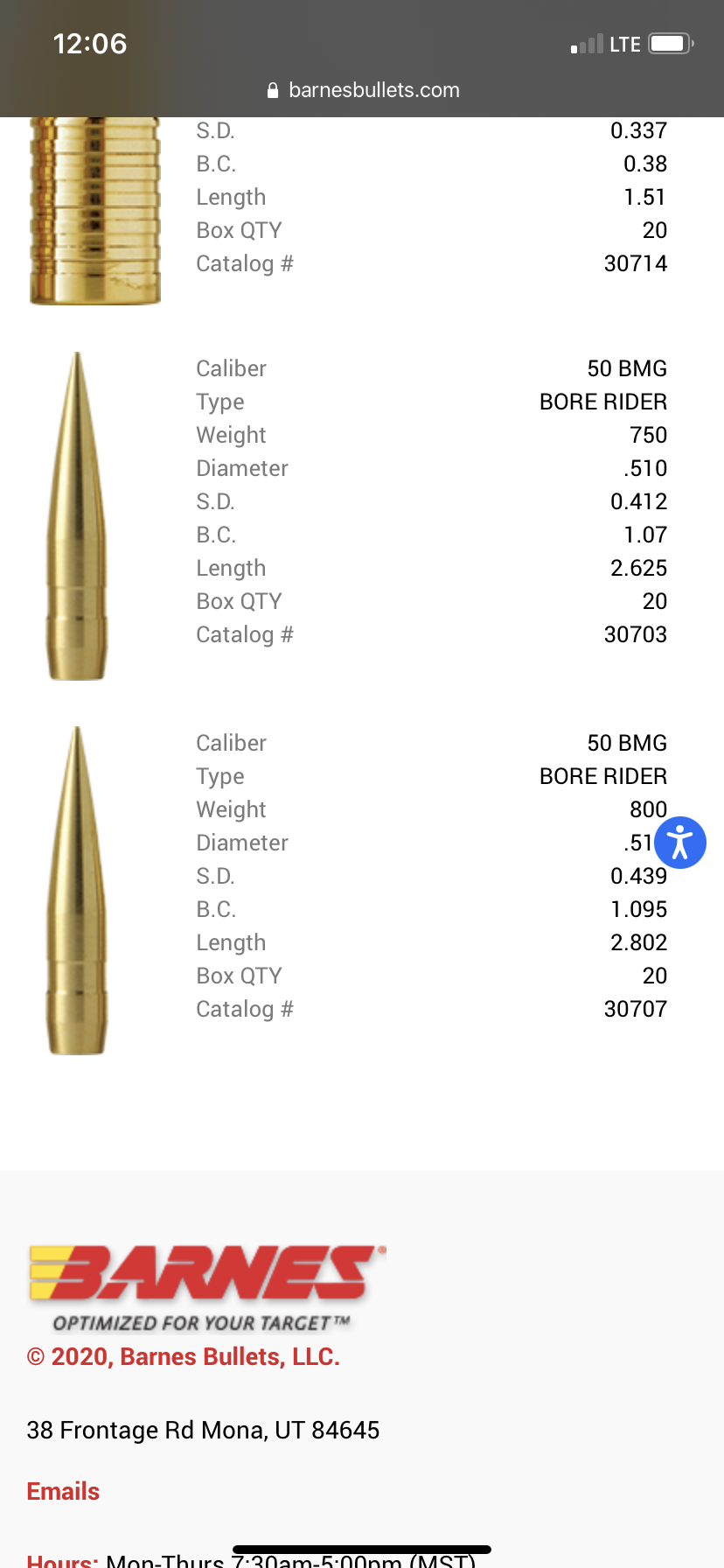

I went to the website you linked and looked under 50 cal components and all the bullets you bought are shown with the bullet weight in grains...did you not see that?? If you have bullet weight, muzzle velocity and barrel twist rate, then you are essentially there other than for BC. One of the bullets is even labelled M33...which has an approximate BC of 0.64 G1 and 0.33 G7 @2,750 fps
Yes, I looked recently and again prior to asking here. I bought mine years ago. I'm not sure that any are the same as what is listed now, and the bullets I'm really interested in are not there any more (they were listed as "Solid Brass Sniper Match"). Thanks for the follow up!
