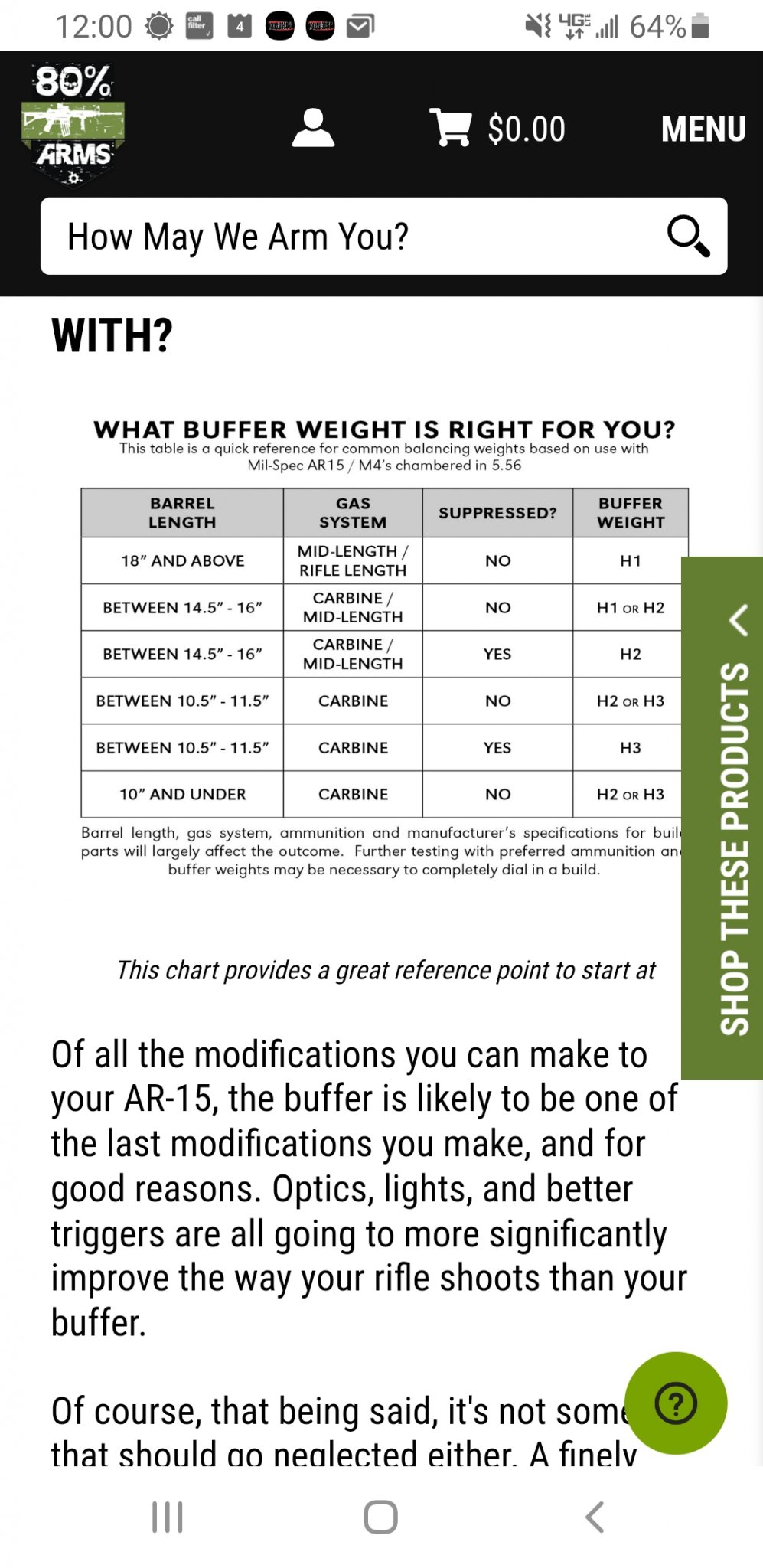

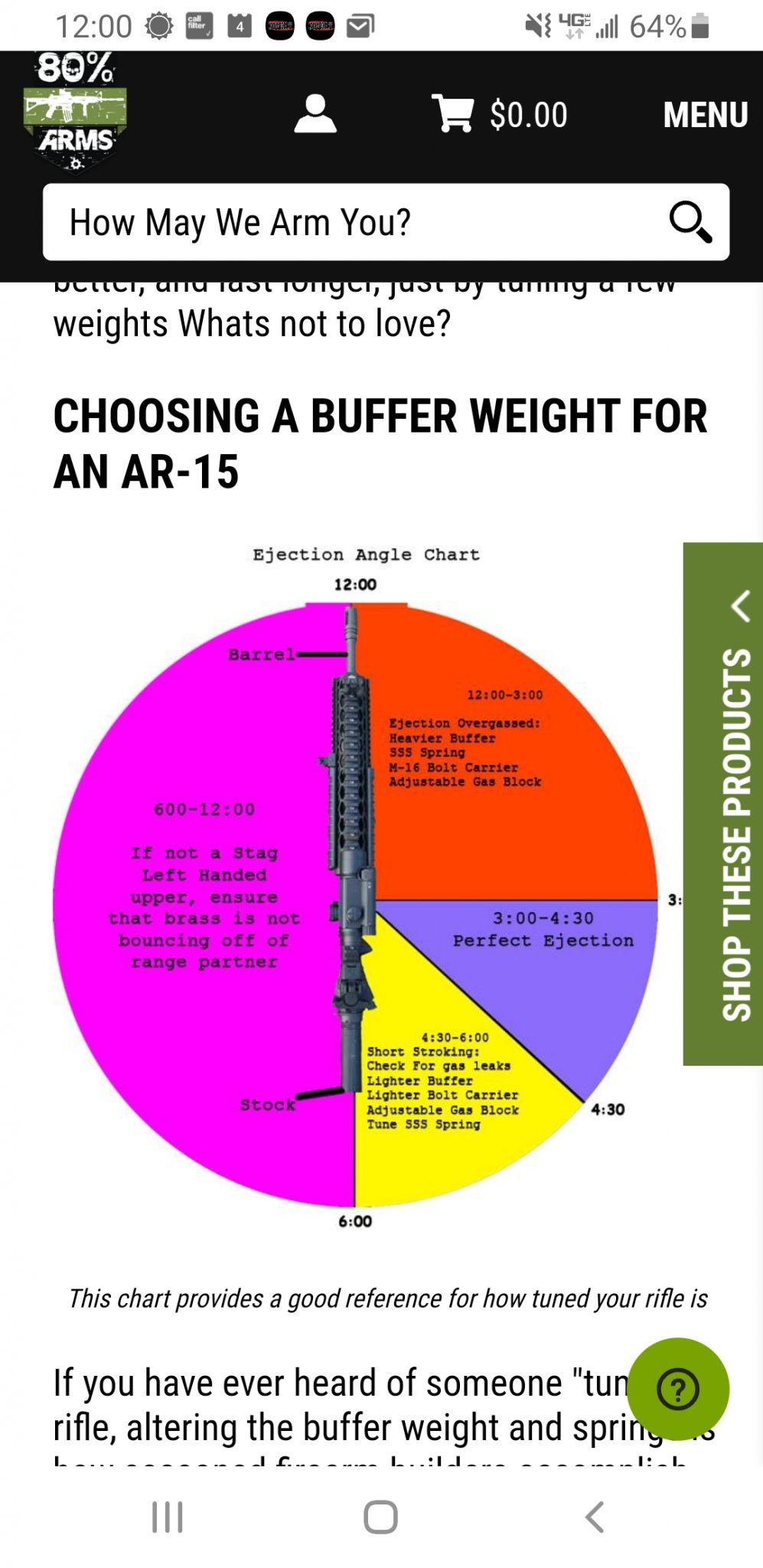

Can anyone offer suggestions on ftf for an AR in 6.8 based on a picture? JP rcvr set, spring and carrier, ARP barrel and bolt, headspace checks, brand new PRI 25rnd mag. Happened same way with this SB ball and 120g sst reloads. Only about 150rnds total in the rifle, didn't happen with my other 15rnd PRI mag. I didn't get time to do much experimenting, was shooting at some pigs the other evening and left for work the next day. I did clean it and it happened a second time so I snapped this pic. Normally I'd get some ammo and my other rifle and figure it out, but trying to save my ammo. I suspect the mag, but it's PRI? Never had an issue before, but this one is my first 25rnd from them. No smiths near me that I know of, appreciate any help.
It's way over gassed. You definitely need a heavier buffer or whatever measures you need to take to slow the carrier down.

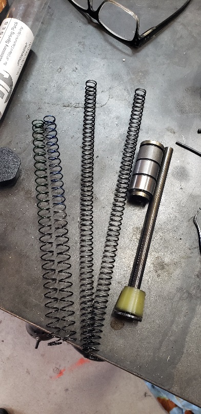

I should have included it's a suppressed 10.5" barrel. JP adjustable gas and a heavy buffer (I don't remember exactly, h2 if I had to guess). I have to experiment more with those components, I feel the same way. Although it functions, the gas is wide open to get the bolt to lock. Brass kicks out between 1-3 o'clock. The rifle is mostly borrowed parts from a diff build while I wait to buy the final parts. Most will be same or similar, but I want to get the gas system tuned better. I didn't consider this could also lead to ftf issues, thanks.

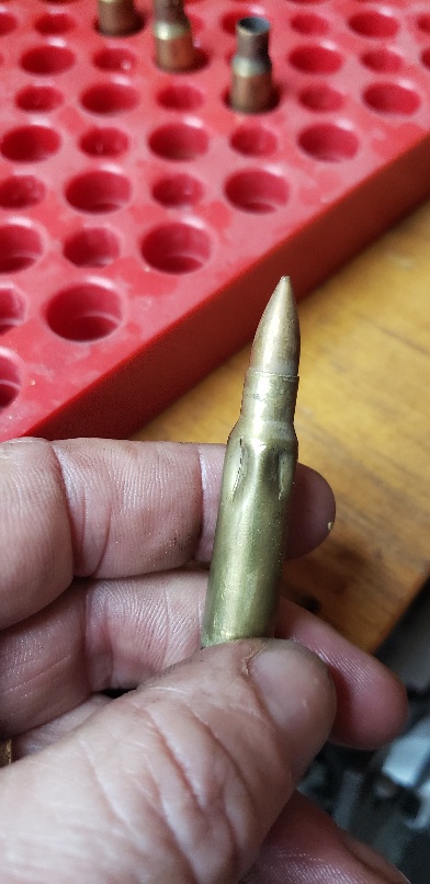

I didn't see any issue with the case heads but will look more closely.

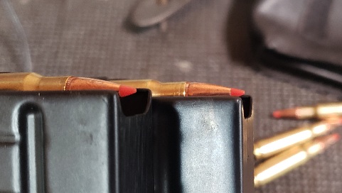

I hate to think it's that magazine, just bought 4 of them because they're "the best" and I don't like jacking with feed issues. I'm gonna keep on wishing for good shit to happen to me, but prob need to look at that mag like you suggest...thanks

I'll oversimplify the situation... It's just mechanics. Don't even think of it as a weapon. Think of an old metal garbage can with a bent up lid. Just a matter of movin' some metal around to make the lid stay on. Probably just need to move a little metal on one mag. Once you get that one to cycle just do the same to the others.
Remain calm, don't get frustrated. Lots of help online and here on the forum.
Lol thanks...a garbage can is a good descriptor of how I felt about it the other evening. 25 or so hogs mixed in with the cows, brand new rifle, first real world test.... boom click. So on top of figuring this issue out I have to practice ftf drills, because I sucked. The damn women giving me crap about letting them all get away.

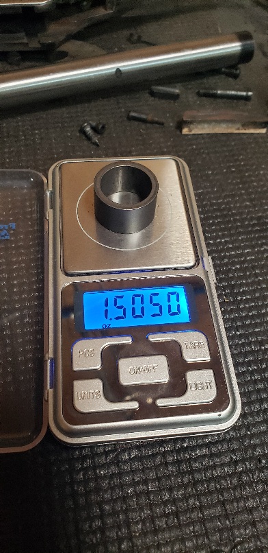

I have walked many miles in your shoes... I have explained to many 1st year apprentices when they see two locomotives speeding towards each other it's best to calmly take a few steps back and watch the train wreck. You just need a good healer to sort the livestock. Weapons and women are no different. You will be OK.
When I have had the failure to feed and crushed brass like you have it has been because of under gassing and when setting an adj gasblock. Considering your adj gas block is open completely you can’t add gas so lighten the mass. Throw in a carbine buffer and see if it’s better. I’m relatively new to AR stuff but this has been my experience.

Thanks, setting up a gas system in a new rifle is always a challenge for me. I'll try a lighter buffer also. I do have one of the jp captured springs with the adjustable weight system. I was hoping to avoid using it unless nothing else works.

Let's go through some general concepts. Keep in mind I don't have experience with your exact cartridge.
"Dwell time". If you are not familiar with that term google it. Basically it is the amount of time from when the bullet passes the gas port until it exits the muzzle.

Did some testing today with different buffer weights and two different springs in the JP silent captured spring. More to follow, but here's what I got. I only tested to see if I could get the bolt to lock back and note brass ejection for different buffer and spring weights. I want to get the system operating correct before I address the FTF issue I initially asked about.
So I had 2 JP SCPs to work with and one XS spring pack I bought a couple years ago for another build - the XS springs are the smaller ones to the left in the pic. I weighed out the buffer system parts individually.
The SCP comes with tungsten and steel weights and a standard "AR-85" spring. Tungsten weighs approx double steel, and that's Tungsten in the pic at 1.5oz. The system has 3 weights total. The XS springs were .2 oz lighter than the standard spring. They are lighter functioning springs for when your bolt doesn't lock back with full gas. I machined an extra steel weight also, and it was very close to the JP one.
Here are a couple of useful things I pulled off the interwebs...they helped guide all my incorrect suppositions about the gas system.
Buffer weights I pulled online...
Additionally, the JP instructions are also useful, I guess. I plan to read them. Eventually.

As far as the FTF, it's the magazine...
I called PRI, they are taking care of it. It's a small difference, but see how the round tip sits lower in the left magazine? That's the problem. It should be angled slightly up like the one on the right.

What did the dented brass match? The lugs of the barrel extension or the lugs on the bolt? Curious if the angle had the bolt run over the top of the cartridge rather than pushing it up the ramp.

The AGB is a JP A2 model. The brass is hitting the feed ramp while the back end is still held down by the feed lips of the mag. I loaded a second one yesterday and noticed anything over 20 rounds or so will usually not feed the first round, especially not if the bolt release is used to charge it. Less than 10-15 rounds in the mag and the follower floats enough that they mostly function.
I asked PRI how they fix it and was told they adjust the angle slightly. I wouldn't mind trying it myself, but they have the tooling, and I have some pliers ha. But I think I anyone could do it if they had to.

You need to dial that back and use the chart already posted. Ideally it should be ejecting between 3-5:00
If it's spitting brass at 1:30 (and I imagine 10-15ft forward from your firing position) you're beating the fuck out of that gun.

Just watch that ejection pattern, it's a great indicator of gas pressure. If you're around 4:00 I'd leave it alone.
If you're at 1:30 you've got work to do because you're beating up the gun.
