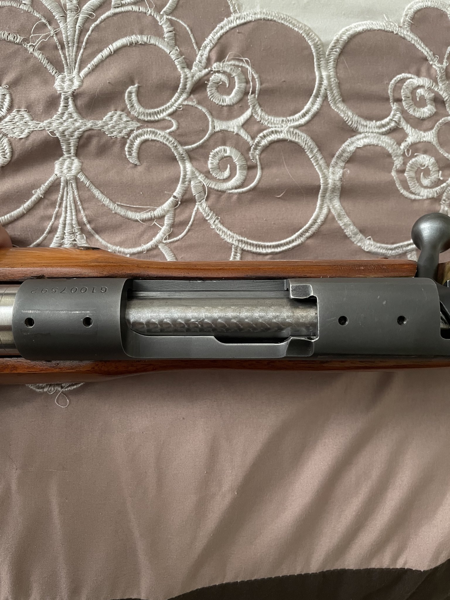

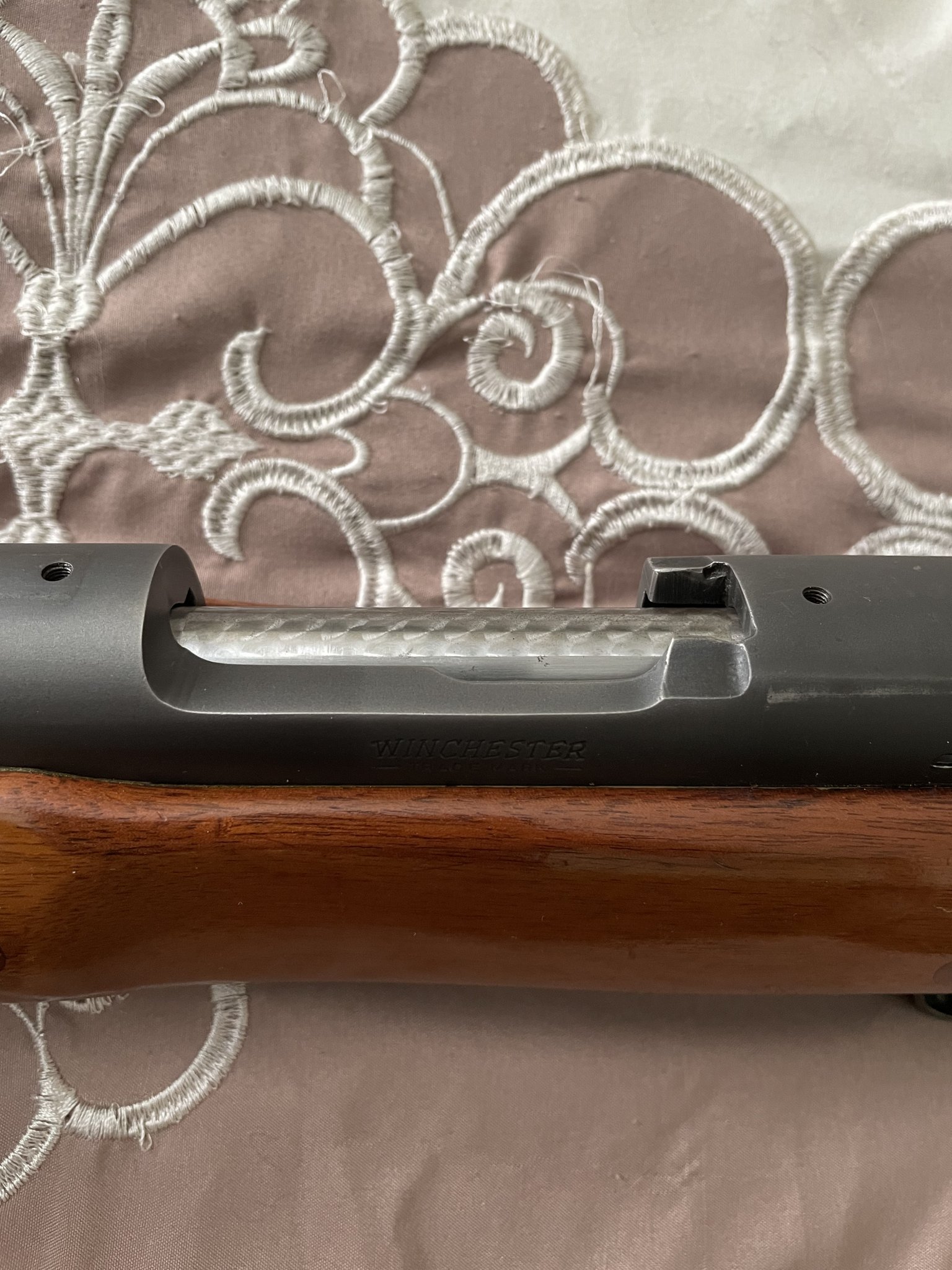

I received a Winchester Model 70 from my father after he passed away. It was setup to shoot bullseye competition with a Redfield adjustable rear peep sight and a hooded front bullseye ring. The rifle has been re-barreled with a very heavy stainless bull barrel and has no markings on it. It is chambered in .308. Since I had no interest in shooting bullseye competition, I removed the peep sight and front ring sight with intent of slapping on a scope base, rings, and scope. I assumed it was a short action so I bought an EGW base for it. The base arrived and it’s too short. In measuring the two center mounting holes I found the measurement to be 3.8 inches. EGW has a scope base that has that measurement for a long action. I guess I’m trying to figure out if my rifle is truly a long action and what benefit would he have gained from putting a .308 barrel on it. The rifle, according to the serial #, was manufactured in 1970. I’m also curious as if Winchester clip slotted their actions as this one appears to be. Any info any of y’all might be able to give me would be appreciated.

No post 64 model 70s were clip slotted from the factory unless they were match or super match actions. Maybe that one is one of those.
Or it's aftermarket gunsmithing
I don't remember when the short action came about. I don't think it was by 1970. So they were all the same length with different bolt stops.
Or I could be wrong thinking of something else. I'm sure someone more knowledgeable will be along soon.
Reactions: fmrabnmp
You have a modified 308 palma rifle. Was built in the 60's 70's for Camp Perry competition.
It's a long action. There are bases out there. The clip slot was standard on those models.
The clip slot caused the front (rear bridge) hole to be further to the rear.
Some bases come with three holes in the rear of the base. Some don't. A 2 hole correct length base is no problem for a competent Smith to add the 3rd hole.
Best to you !
Best to you !

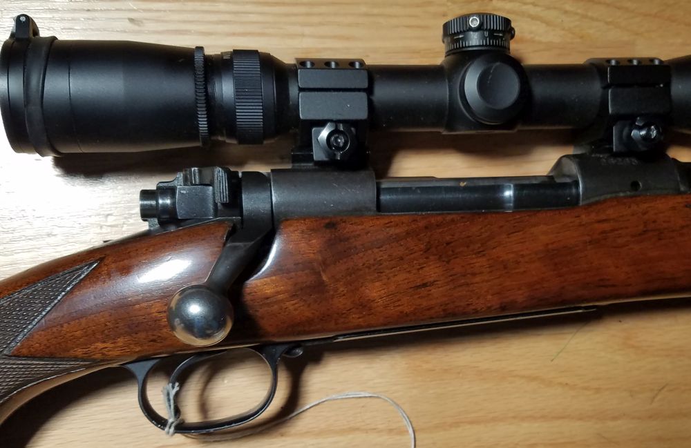

I have a 1953 win M70 in 308 and it is a short action, in the sense it would be very hard to convert to a long action.
Too easy, if you have the parts. Remove the bolt stop adapter from the extractor ring, use a std ring, put in the long box /spring /follower, and a pre-64 goes from 308/243 to a 270/3006 length in a flash.
For the 300/375 H&H, use the correct bolt stop and correct box/spring/follower, and your action is almost ok for those two calibers. Your 53 action doesn't have the relief cut in the bridge to clear a loaded 300/375 round.
