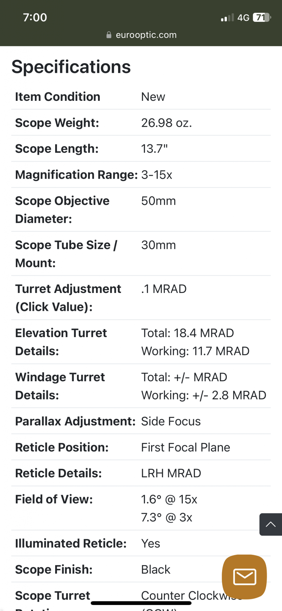

See this is what I’m intrested in, so the tt315 long range hunter has lower quality turrets?
I wouldn't call them lower quality, you just have to pull them up to use them and that's always a sacrifice IMO unless it's just something you're not dialing much. The turrets on the M are extremely nice.
I would also buy the M solely for the ability to get the G3XR reticle with the floating dot and tree.
Worth noting the G3XR reticle is really fine and not useable at 3x. Fantastically light and capable scope regardless and the turrets are mind blowing, but limited to 12 mils of elevation (6MIL double turn).
I am now considering this scope, I just am curious is it every bit as good of a scope as their other scopes? Tracking, glass, exc
Yes, it is every bit as good as their other scopes optically (which is to say some of the best on the planet); however, you have to keep in mind that the turrets are different, they are only 6mil per rev and you are limited to 12 mrad total elevation travel which is plenty for most crossover/hunting applications with modern cartridges (but the turret feel is outstanding, maybe even better than the "P" scopes due to the wider spacing). What TheOE mentions is correct, the Gen3 XR is outstanding above 5x but below 5x is really difficult to "see", for this reason, many who think they are going to use the scope below 5x a lot will opt for the Gen2 mildot reticle as it looks like a thin duplex at 3x and "easier" to see center cross.
