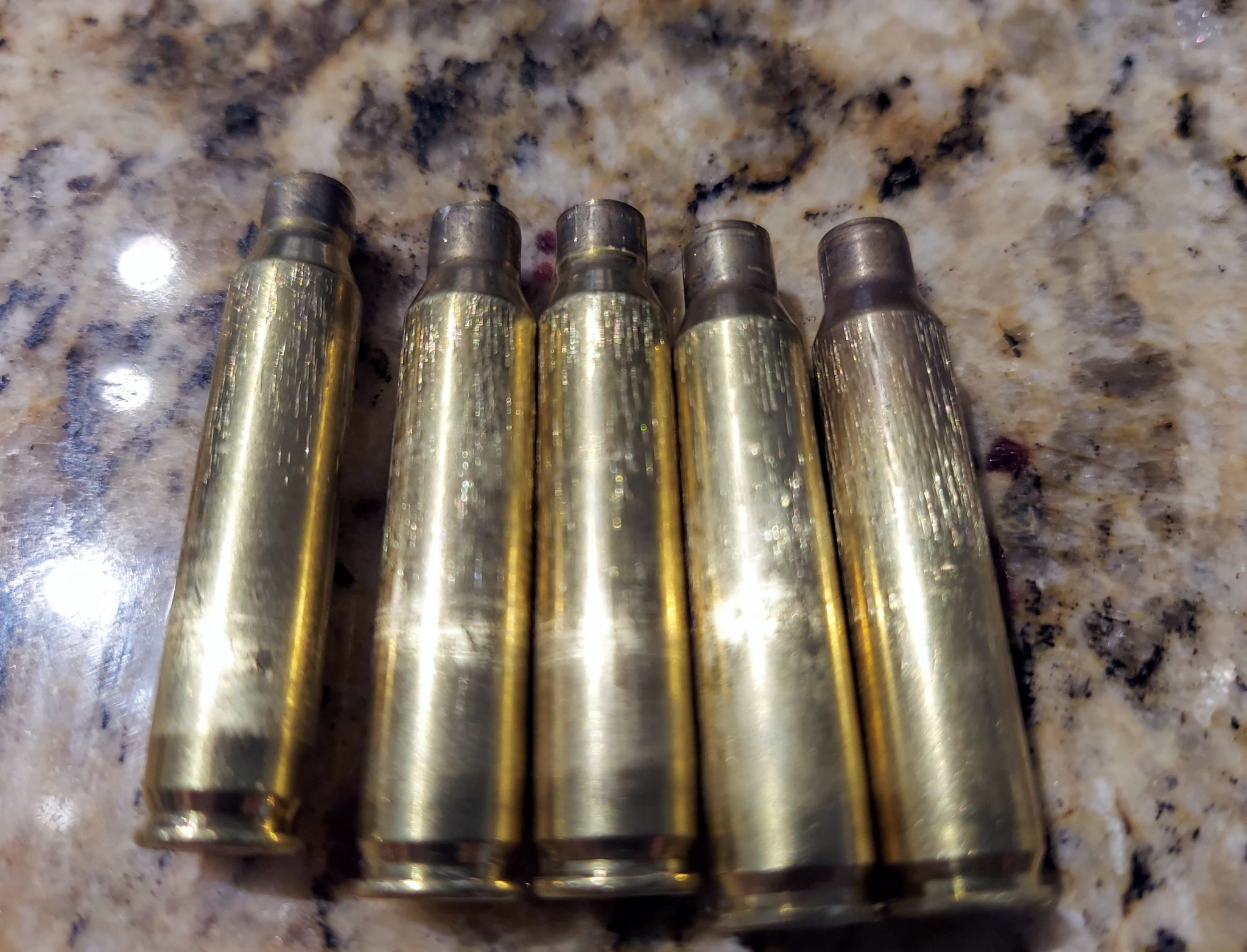

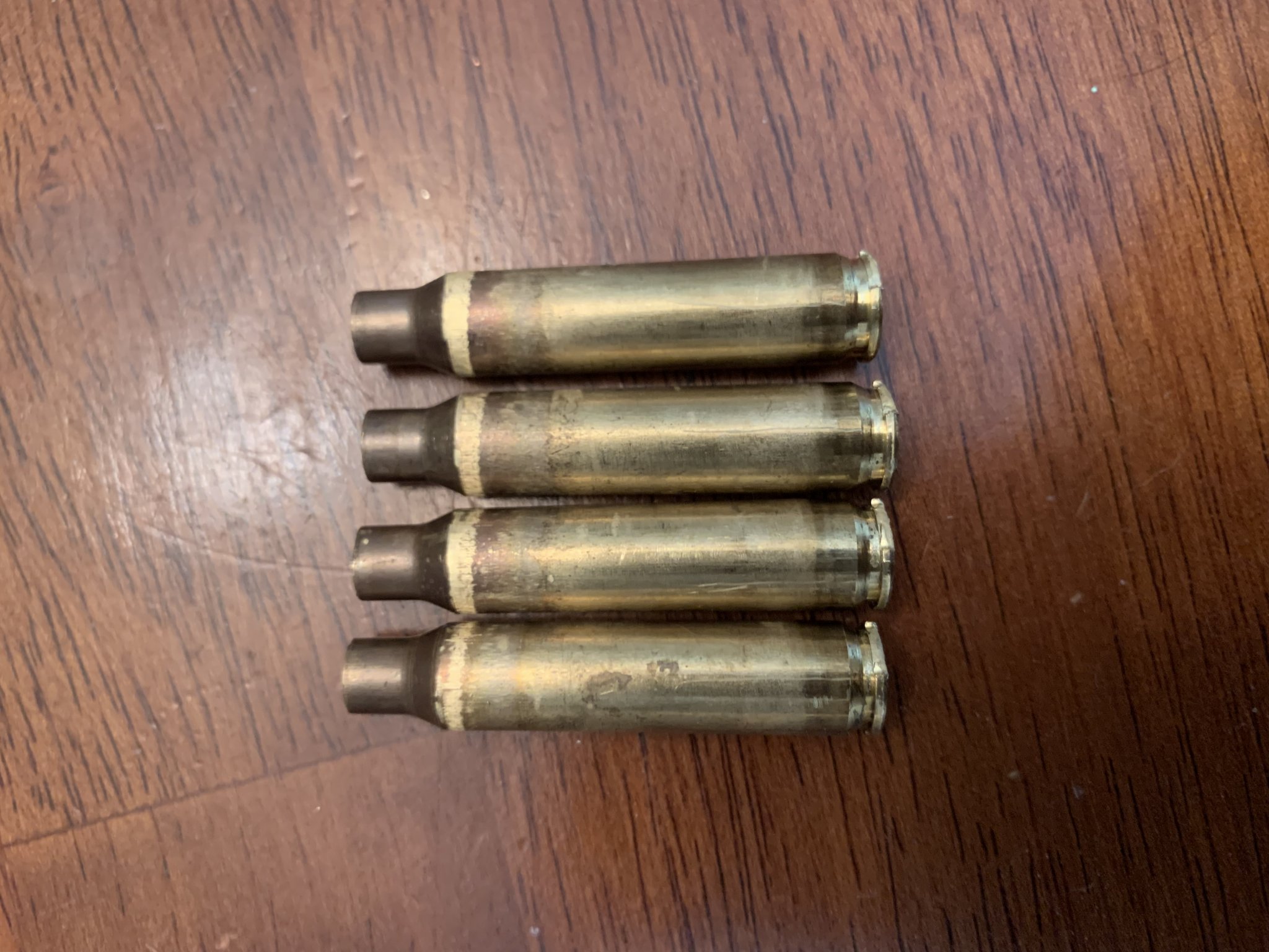

    Took our oldest to the range with his new rifle his uncle built him. We were shooting 5.56 through it and it would shoot but not extract. Pics below of the brass aftermath. Tried 223 and it would shoot, eject, shoot another but only halfway eject while it tried to cycle another round in. The RO and someone else tried diagnosing it to no avail. We swapped the bcg for mine and it had the same issue, although I don’t think mine was shearing the brass like his. What could be causing the issue?
    My thoughts?
    1. Not chambered for 5.56
    2. Gas tube issue/pressure issue
    3. It didn’t seem to like the mags I brought for it but he left his at home his uncle gave him.
    It’s an Anderson lower and I don’t know about the upper.

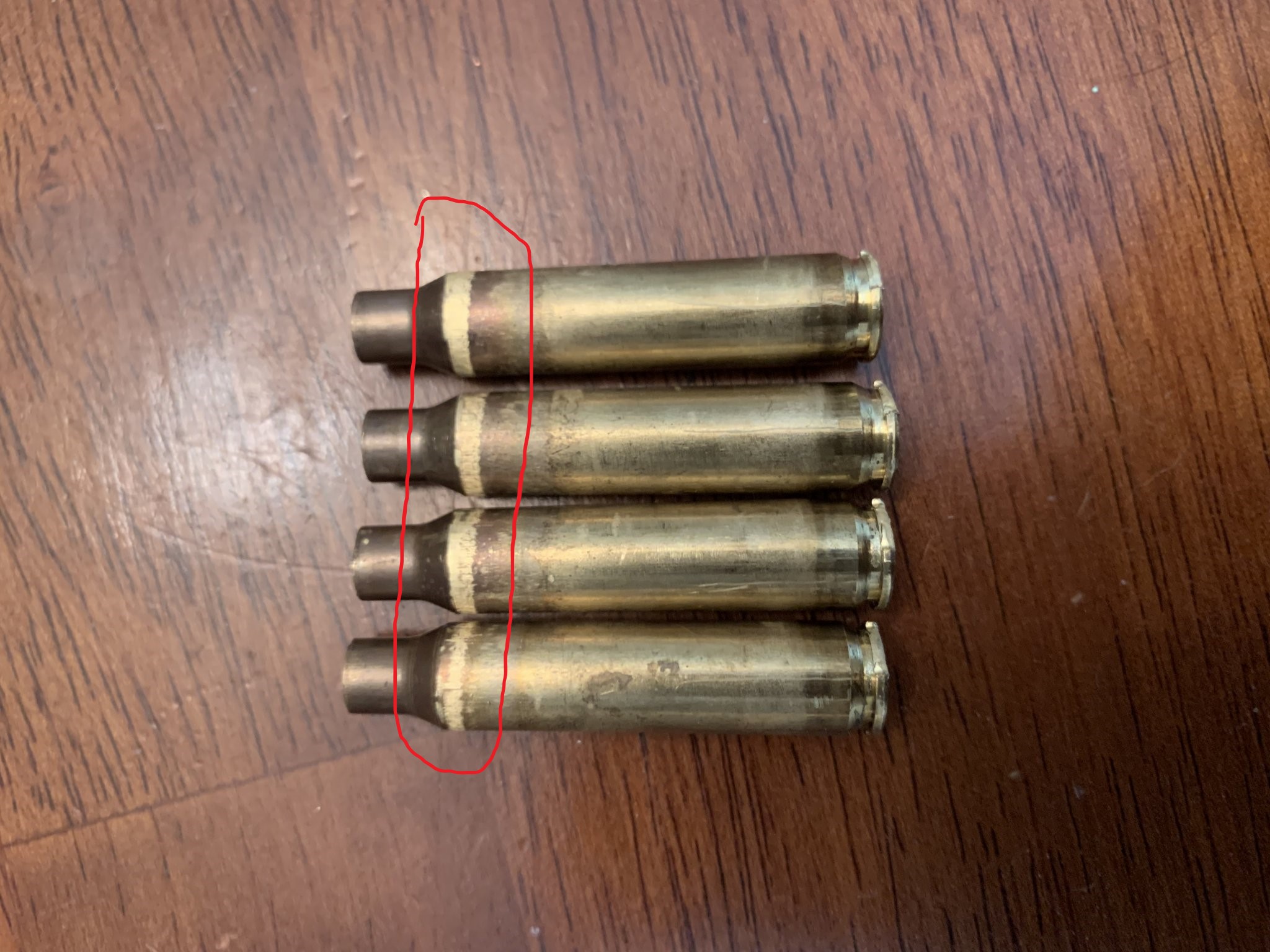

    Hard to see but there are scratches above where it’s been sheared on the case

    You’re wasting your time and ammo with that barrel. Mags and tuning a gas system aren’t going to do a thing when it’s got a chamber that was cut with a chisel. That barrel and/or entire upper belongs in the scrap pile.

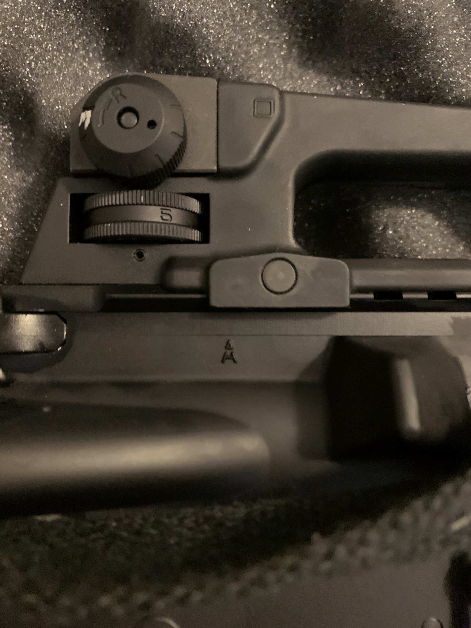

    A for Anderson? Only marking I can find

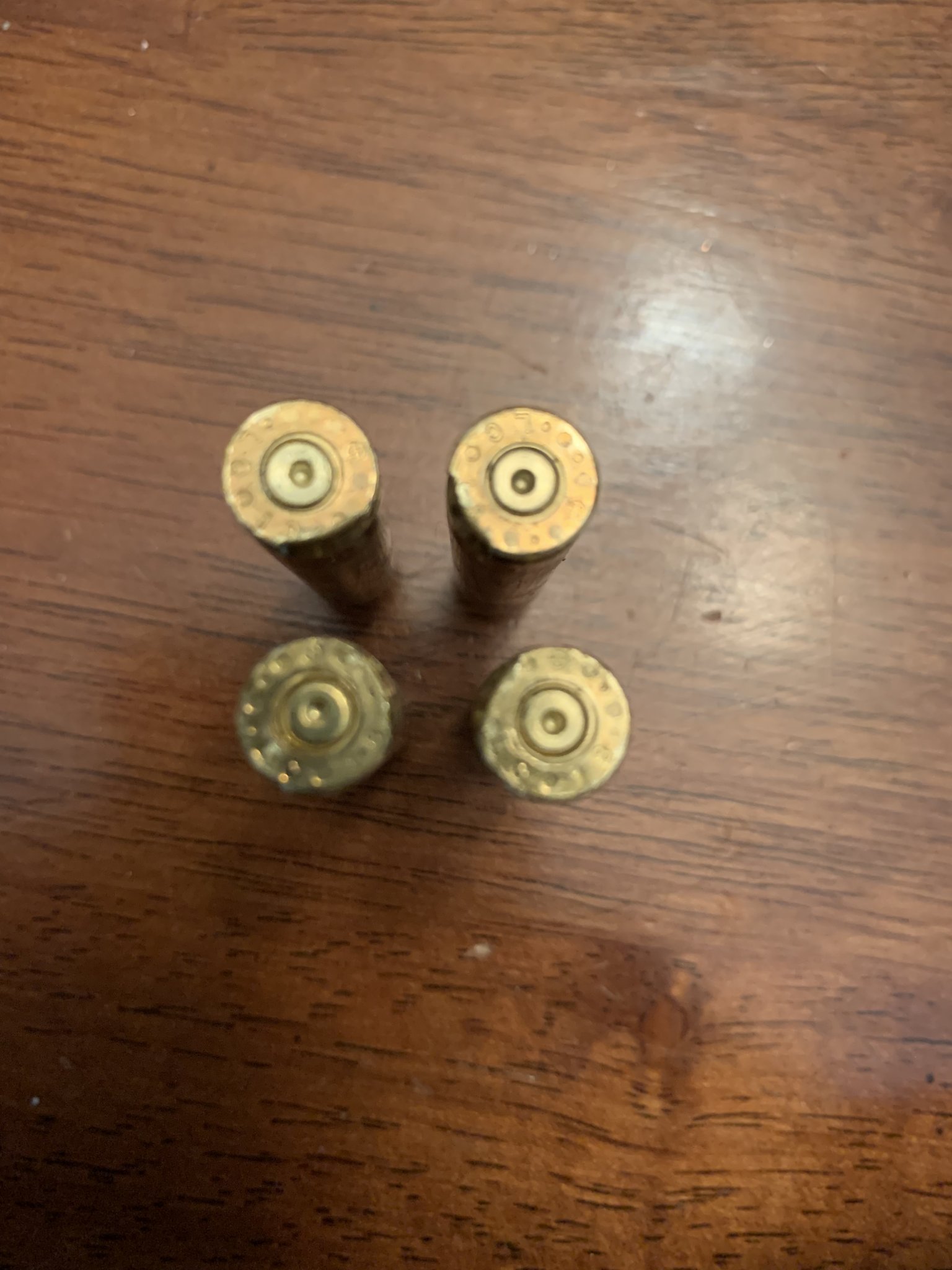

    There's no way a properly-built 20-inch .223/5.56 rifle should be destroying brass like that.
    That barrel's a piece of sh!t.
    I'll bet you a bucket of chicken that upper is salvageable at the price of a new barrel. PM me. You buy the barrel, send me the upper and replacement, and I'll swap 'em for you, no charge (you get the old barrel back to use as a tomato stake). You pay the ride both ways.
    Look at the shoulders. . .holy @%*#!
    Putting 556 in a 223? Bet there is a ton of brass in the throat now.
    I was thinking it was chambered in .223 as well. His uncle was a Marine so he thinks he knows what he's doing. Told him to text him and ask him what it's chambered in and he said, "it's chambered for both, it's mil-spec and everything." Like dude, mil-spec is just part sizes and shit nothing to do with the chambering of the rifle.
    Anyway to find out for certain what it's chambered in?

    Both the lower and the barrel should be marked with the cartridge they're made for- it's a government requirement.
    Reactions: Hobo Hilton
    Lower just says multi like most lowers. Don’t know where it is on the upper. I don’t think mine even says on the upper. Unless it under the handguards

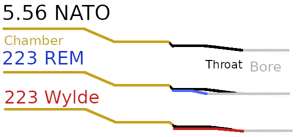

    5.56 will chamber and fire fine from 223 chambers. The dimensions of the cases are identical. Long bullets used in 5.56 ammunition “may” cause excessive pressure in barrels throated for light weight 223 ammunition.
    Many ARs are marked 5.56/223 because they are essentially identical.
    Haven’t heard that. Always heard the opposite. 223 through a 556 but not 556 through a 224 unless 223 wylde
    223 chambers cut for 40gr hunting ammunition may have short throats that cause excessive pressure with the longer bullets used in 5.56 ammunition. But, so long as the bullets aren’t jamming into the lands, there is no issue with firing one from the other. There is a lot of internet myth based on a lack of understanding CUP vs PSI pressure measurements used for ammunition.

    Is the chamber perfectly clean/clear? I've seen a separated casing stuck in a chamber and the guy was still trying to shoot his rifle wondering why it didn't work.

    Generally speaking, the barrel's data should be engraved on it somewhere.
    The cheaper (or more exclusive, like gunsmith-machinist done from a blank) the fewer the markings. The OP's looks like it's from the cheap end.

    Unless it is a custom throated chamber standard 55 gr or 62 gr 556 will go through a 233 just fine.
    There is a lot if internet bs about the whole 223/556 type thing. Just go out and shoot them.
    If it's a 223 custom varmint gun, then proceed with caution.

    Doesn’t really matter what it is chambered in between 223 rem or 5.56 if shooting 55gr fmj. Between the two the chamber is nearly identical, the throat is slightly longer on a 556 chamber.
    The problem is that chamber is flat out messed up from whoever cut the chamber, evidenced by the messed up shoulder on your fired brass.
    Replace the barrel and it will probably run fine.

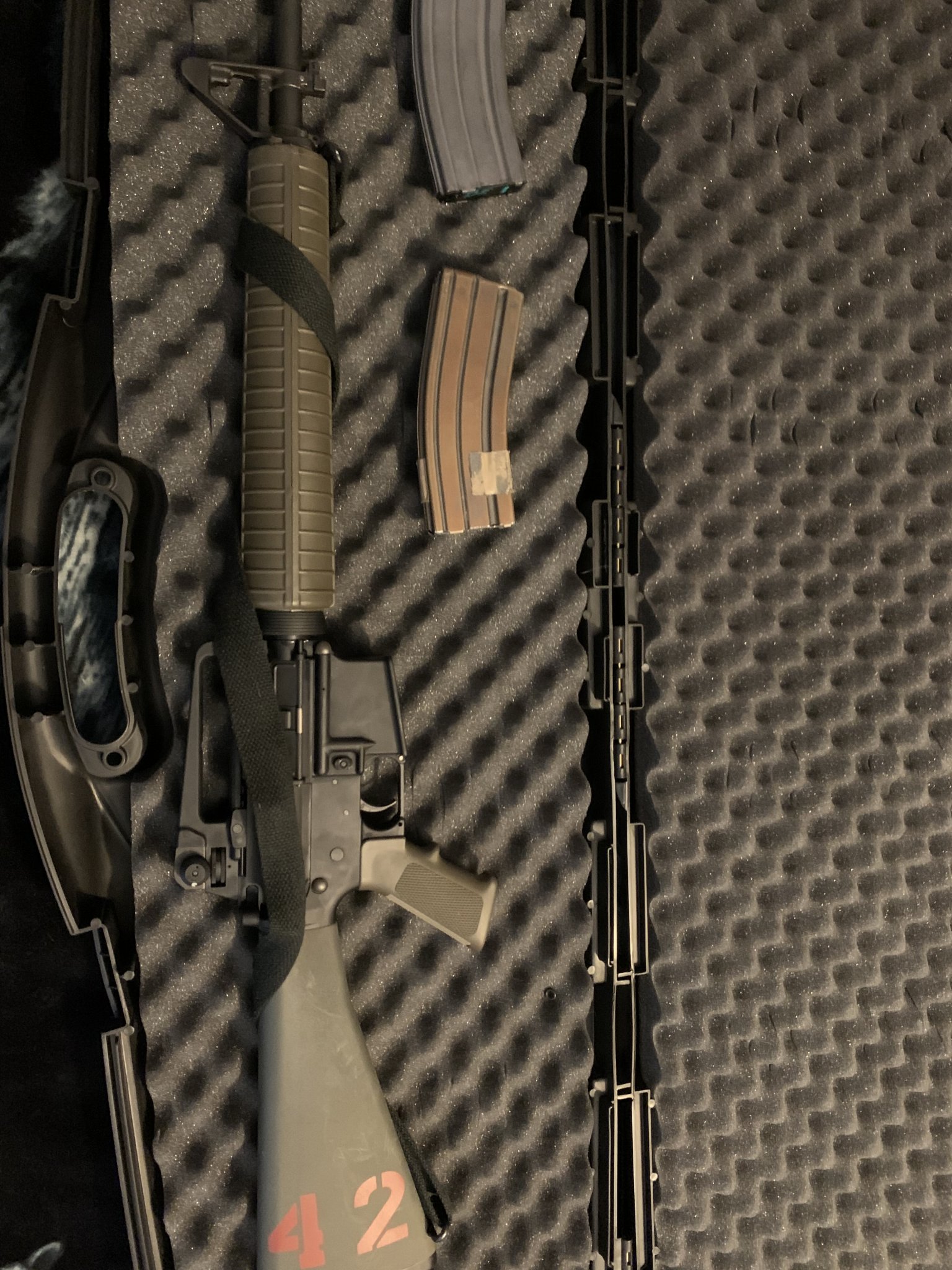

    He wants to keep the upper because he likes the old school style -.- and he won't admit it but he places sentimental value on everything people give. He gets that from his father who hoards anything and everything. Since a lot are saying a barrel swap should do the trick, I'm looking at this one to swap for the shitty one.
    Yeah, no problem keeping that upper and handguards and FSB at all assuming they are all in spec.
    As far as the barrel, just buy this one and never look back.
    It is the correct barrel for that rifle. I am not sure that the one you posted will even fit.
