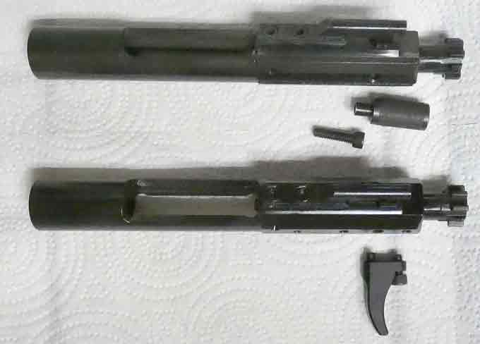

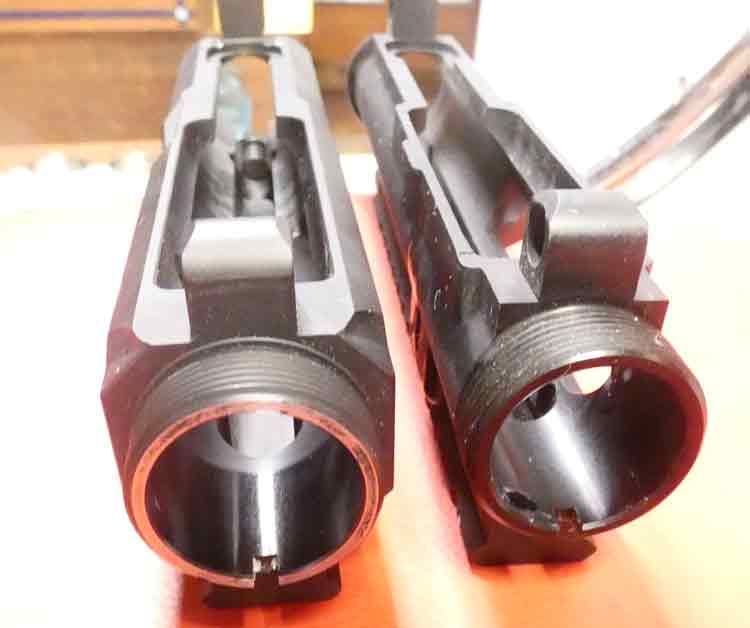

Can someone help identify this BCG. I received it with a 22ARC barrel and obviously it doesn’t have serrations for forward assist and the dust cover doesn’t close.
Looks like a side-charger to me, hence the threaded hole up front with the adjacent holes for the handle indexing points.
Just my first guess based on what I’m seeing. Can’t have ejection port doors on right side chargers and no need for FA when you have a handle attached to the carrier anyway.
