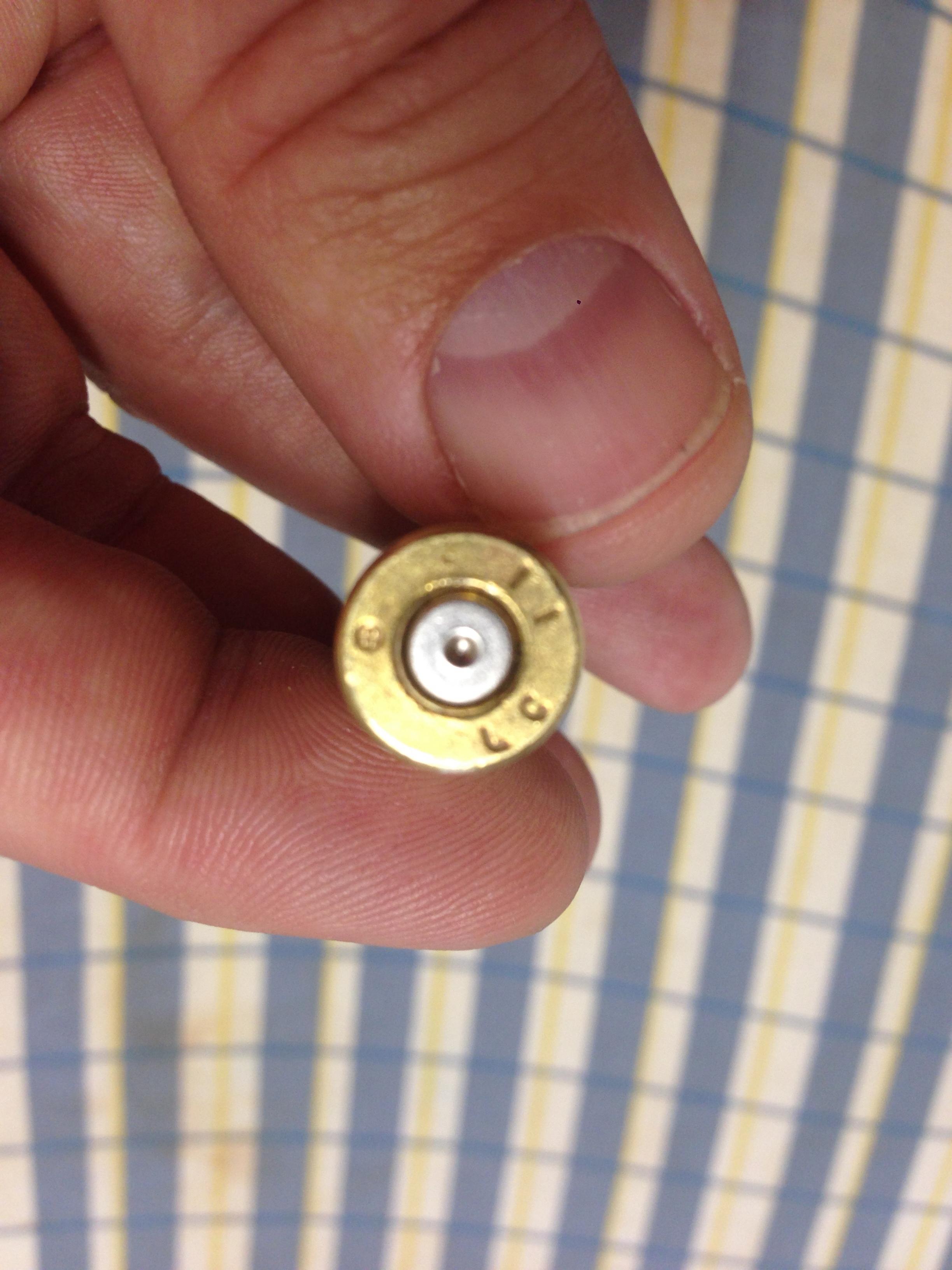

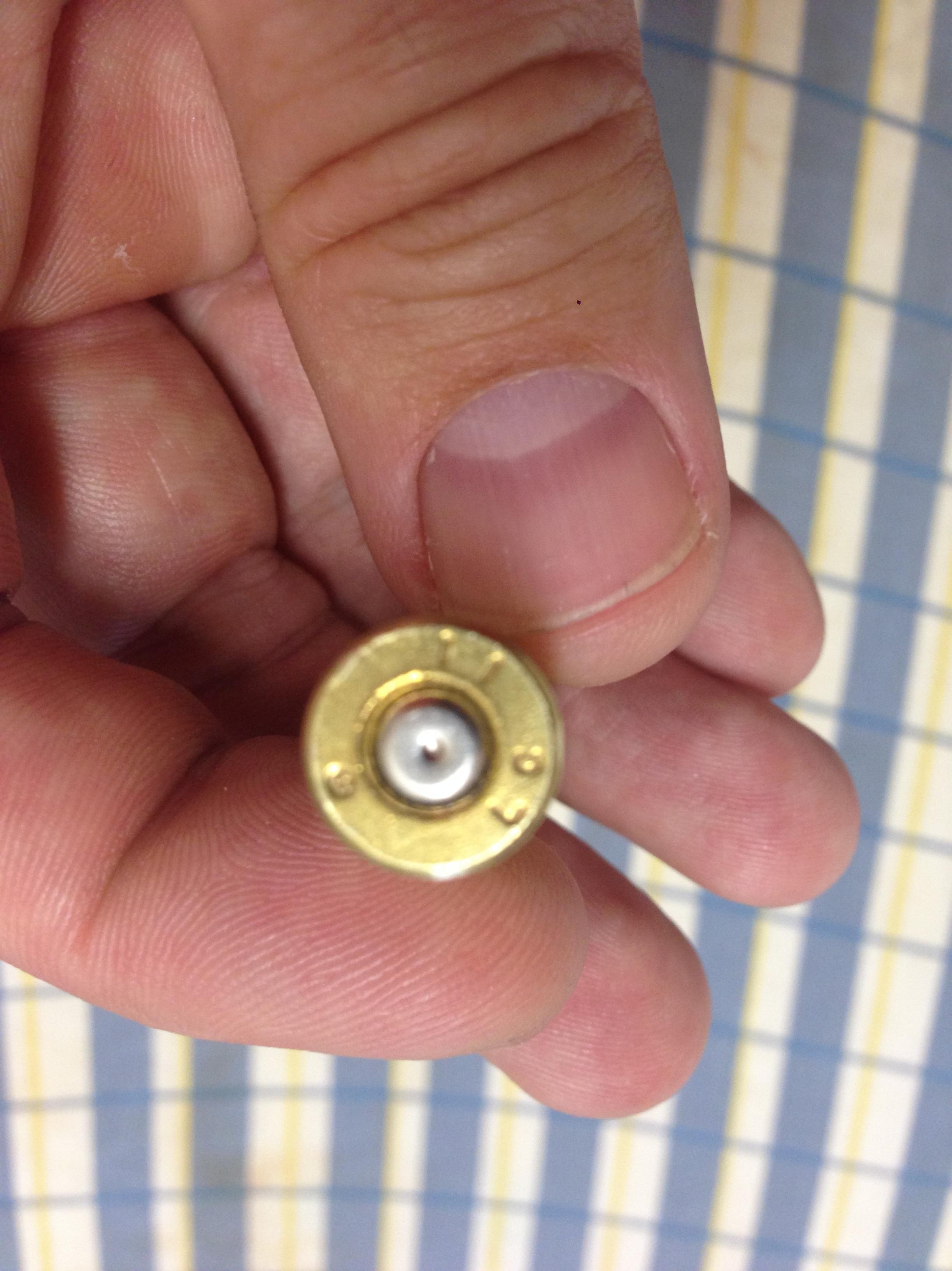

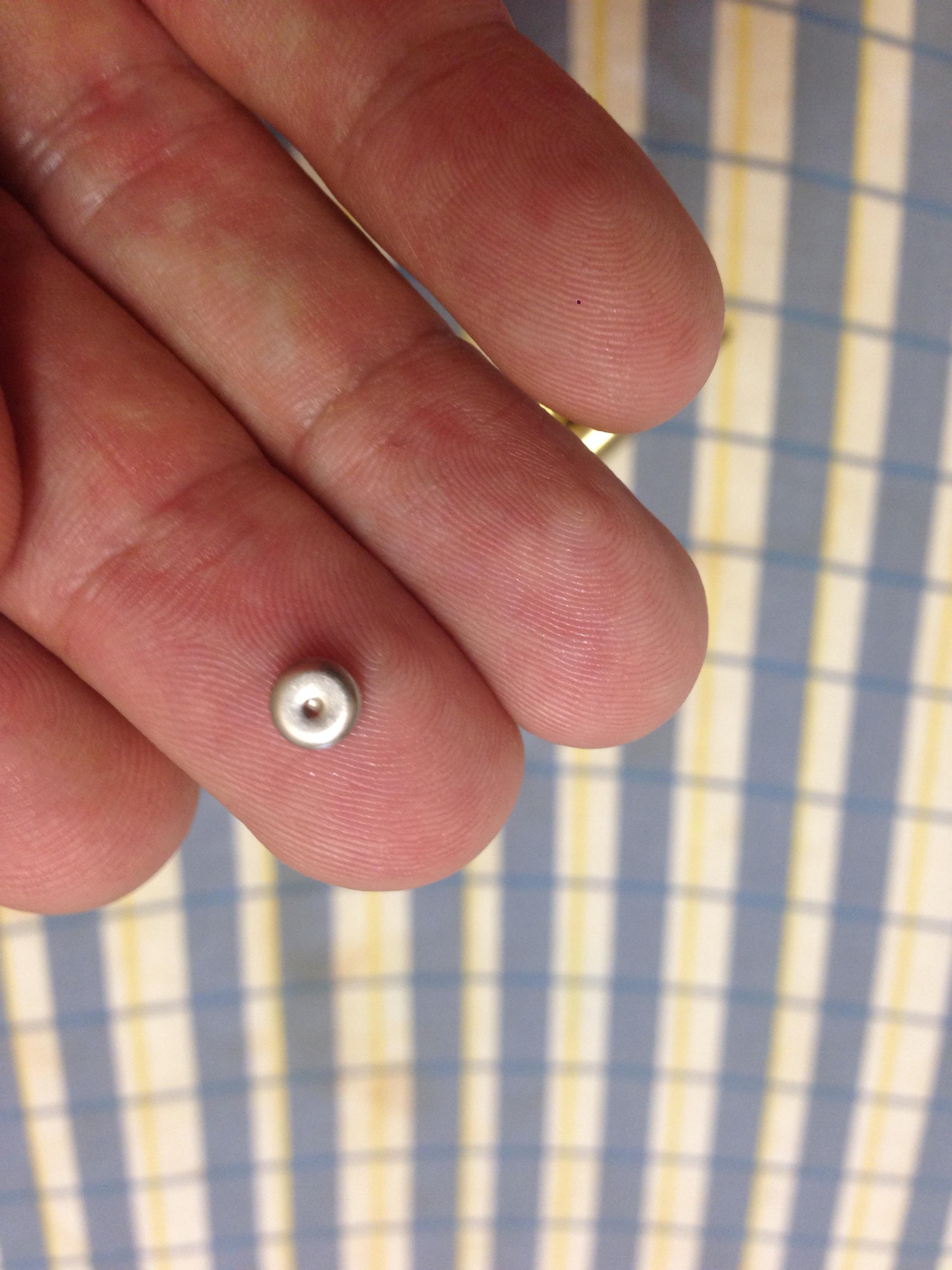

Doing load development. All cases were trimmed to the same length, primer pockets were swaged with a Dillon 600, primers were seated on the Hornady single stage. I had 20 rounds, all the same but there were 4 in a row that did not properly strike. The primer didn't ignite, Stiller action is new, barrel has 60 rounds through it so I can't imagine its the firing pin. They are CCI LRP 200. Out f 60 primers these were the only 4 that didnt go bang and I find it weird it was one after the other. Primer/case on the left did not ignite, primer in the middle is obviously one of the primers that didnt ignite and the primer/case on the right is one that did ignite. Any ideas fellers?

What is the lot#?I had the same problem last saturday with the same primers.First time I ever used CCI.Also experienced that they were different sizes which made some seat loose.Dealing with CCI now,they want measurements on my primer pockets.Never had any misfires but usually use FED primers.I would definitely let them know about it.

If I had a new Stiller action, I would really hope that a grain of unburned powder wouldn't stop my rifle...
Probably just some bad primers, which is very unusual for CCI, but I've been reading about difficulties with CCI primers a lot lately.
I almost never use CCI primers. But, there are many things that can cause a dud. I have to wonder if there is really an epidemic of bad primers, or just mass hysteria. Has any manufacturer admitted to bad primers? The photo looks like contamination, to me? BB
Well I just tested another 60 rounds and same thing. This time there were also Tula 7.62 primers. Some would go bang and then some wouldn't. The ones that didn't ignite, well about 90% of them fired when I reloaded the round into the chamber for the second time. It's definitely the gun and my reloading imperfections. You guys think I should replace the spring? And sorry for the confusion, the action I bought off a member here. Thing is all factor ammo never have a problem, SW ammo no problem. I'm not doing anything to the primer pockets but swaging them on a Dillon 600 and I'm trimming all brass on a Wilson case trimmer with micrometer to 2.005.
