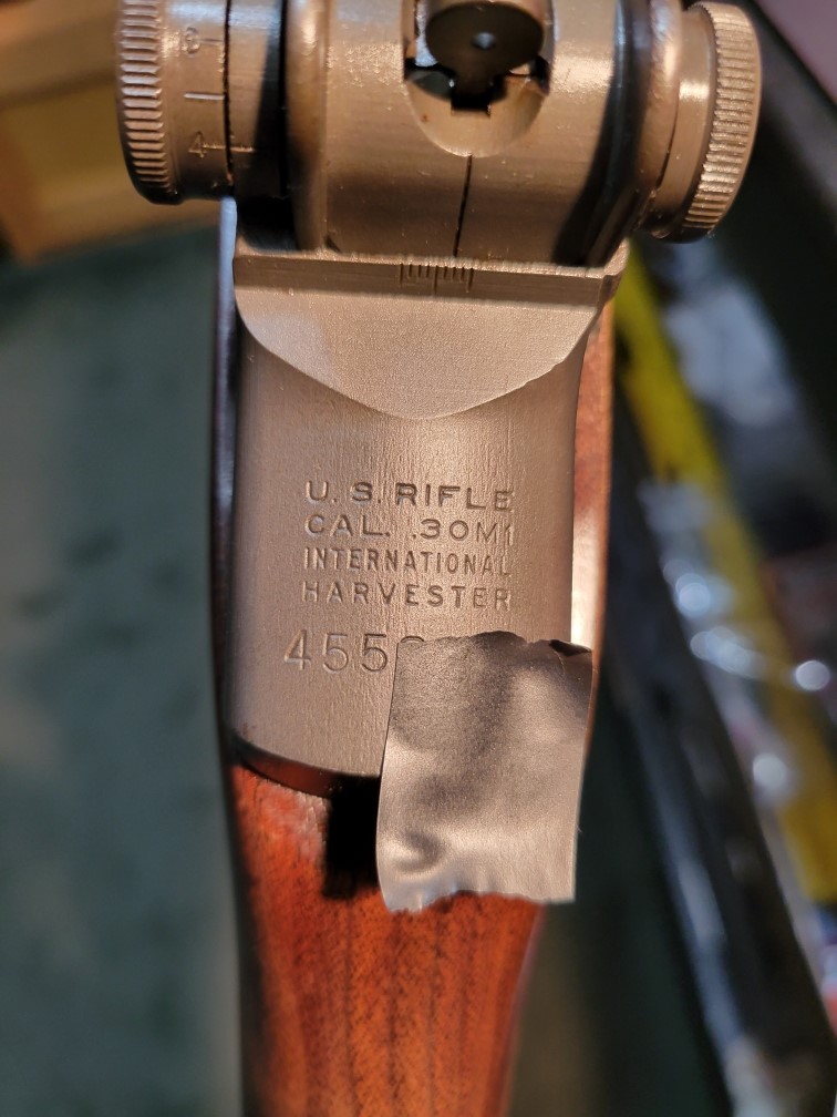

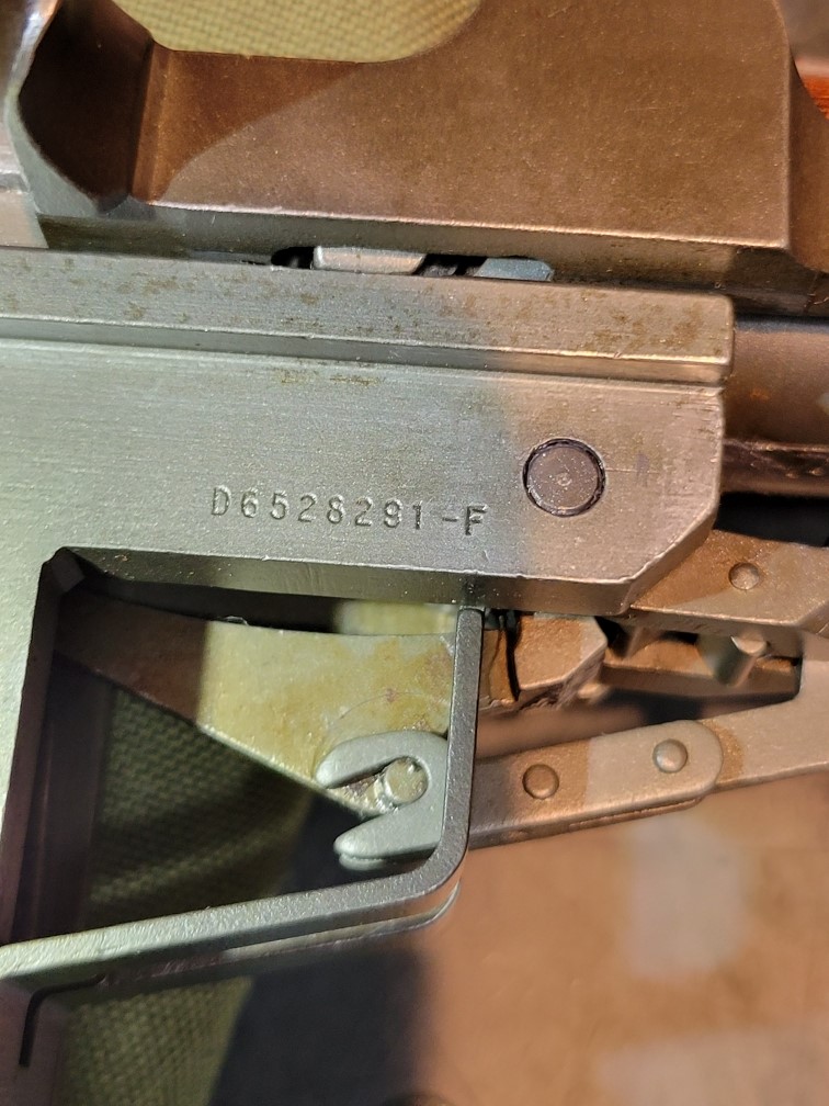

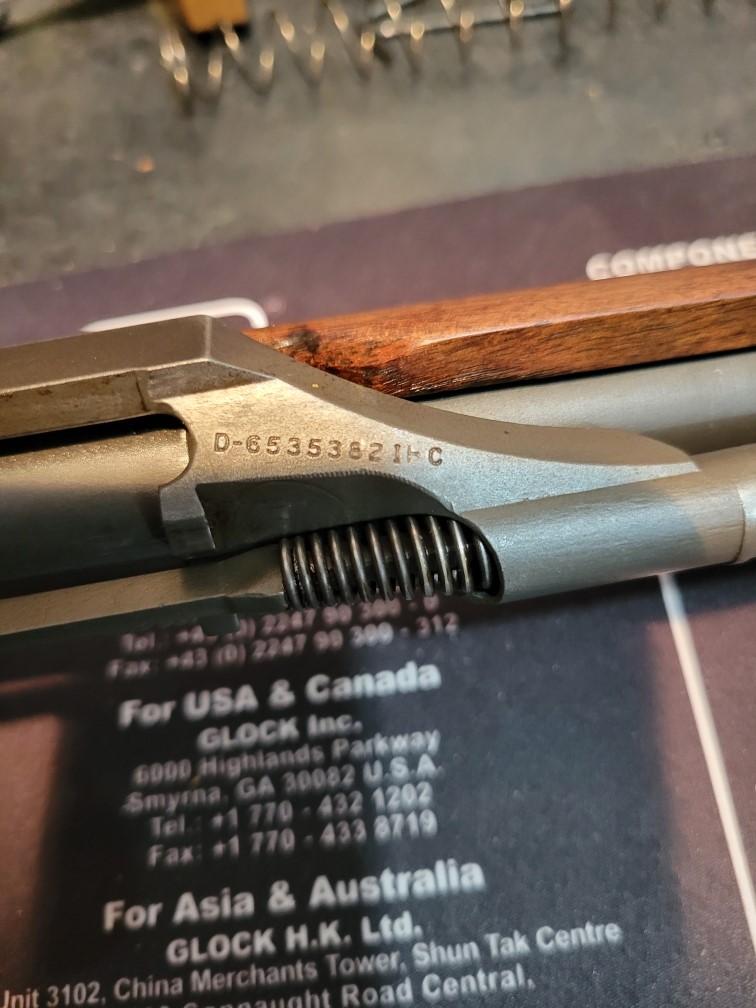

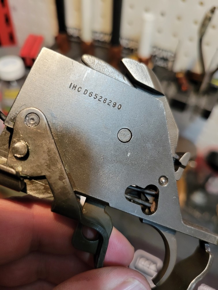

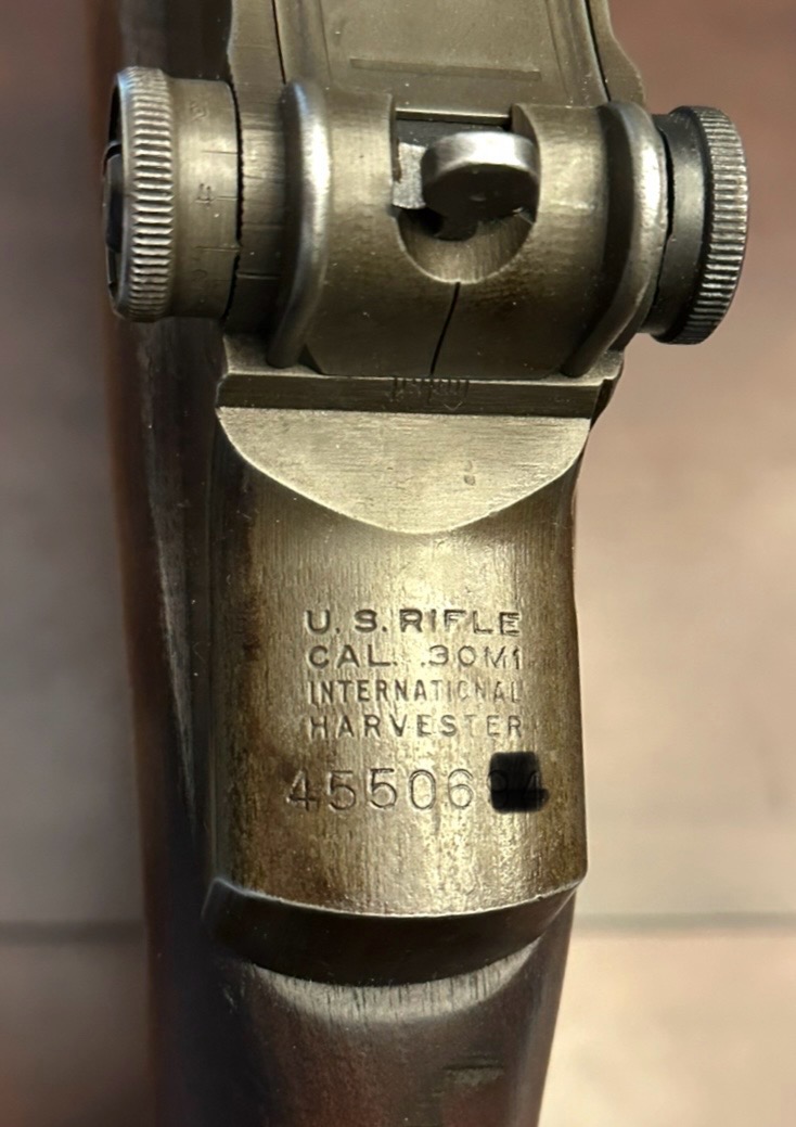

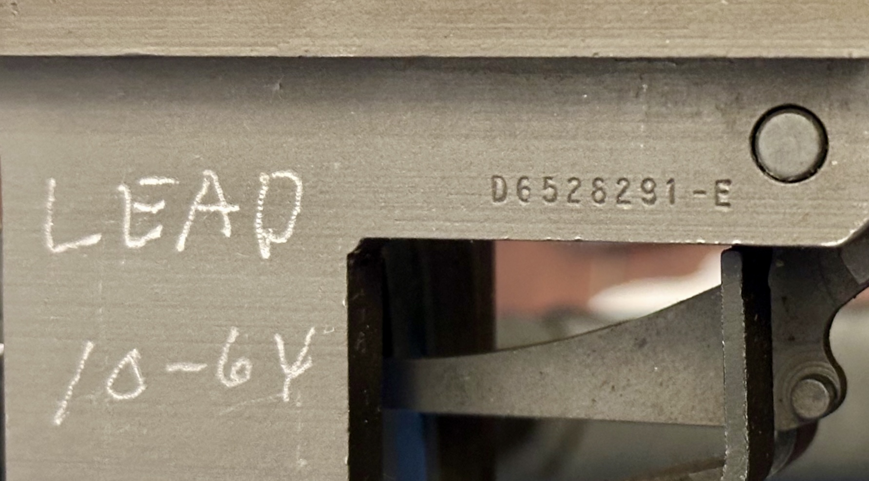

I own a IHC M1 that I purchased from CMP in 2005 that I believe is a LEAD rebuild. The serial number is 4,550,6XX. It has an LMR barrel dated 4-53, and all the major components (Bolt, trigger housing, op rod, hammer, gas plug, etc.) are IHC marked. The stock has a circle "P" in front of the pistol grip and the number "3162" in the barrel channel. While this rifle has a postage stamp style receiver marking that reads "U.S. RIFLE / CAL. 30M1 / INTERNATIONAL / HARVESTER/ 45506XX", the side of the receiver is marked "D6528291-E" and "LEAD 10-64".
From what I can find, receiver drawing number D6528291-“E” was assigned to HRA rifles.
Has anyone ever come across a IHC receiver marked like mine?

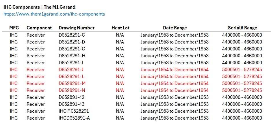

Thanks for the link to the article, however, it doesn't mention anything about an IHC Receiver with drawing number "D6528291" followed by an "E".
I think I lucked out with CMP on this one. It's still in as originally rebuilt condition, and I'm pretty sure the LMR barrel is original to the rifle. Additionally, it looks like all the other major components are correct "IHC" items. I have other M1's so I never shot this one.
My main concern is that none of the IHC M1 source documents I can find show an "E" suffix receiver.
I'm hoping that some M1 enthusiasts may be able to shed some light on this.
This site lists components of IHC M1's (There's no "E"):
One did in post #3...

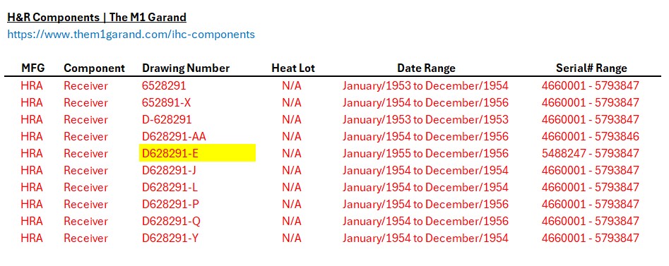

I find it interesting that HRA's receiver drawing number for Jan 1955 - Dec 1956 serial numbers 5488247 - 5793847 in one source document is the same as mine - D628291-E.
Do you think it's possible that HRA may have sent some receivers to IHC in 1953 or 1954, when IHC was making 455XXXX serial numbered rifles? I read somewhere that for receivers that IHC received from SA and HRA, IHC would mark the receiver heel, but SA or HRA applied the drawing numbers on the receiver legs.
Yes, that is interesting.
Source?
I can only find where HRA supplied approx 4k receivers right at the tail end of IHC's production.
IIRC, SA supplied around 1100 finished receivers(including IHC markings and nomenclature) and a further 800-900 unfinished receivers( except for drawing number with a "42" or "43" code iirc) to IHC.

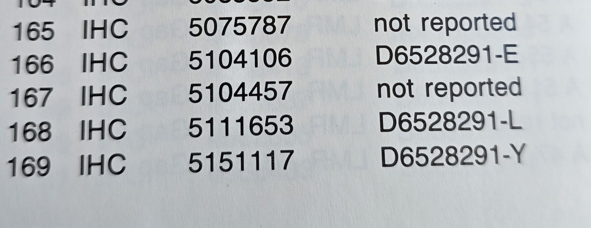

Serial Nos. 5104106, 5111653, and 5151117 with Drawing Numbers ending in "E", "Y", and "L" could definitely be a receivers HRA provided to IHC towards the end of their production run.
But my Serial No. 4550694 with Drawing No. D6528291-E is still a mystery to me.
Something to keep in mind with IHCs- they had more production variances, start/stops,parts from other suppliers and other oddities than any of the manufacturers. Not uncommon to find later serials with original earlier barrels for example.
Another thing of note (and pertaining to this thread) are these drawing/lot #s on different serial ranges. IHC didn't use a first in, first out order of production. Not uncommon at all to see late late production with much earlier drawing numbers/lots. Parts were pulled from storage areas as production needed.
They are outside the known s/n range for HRA receivers.

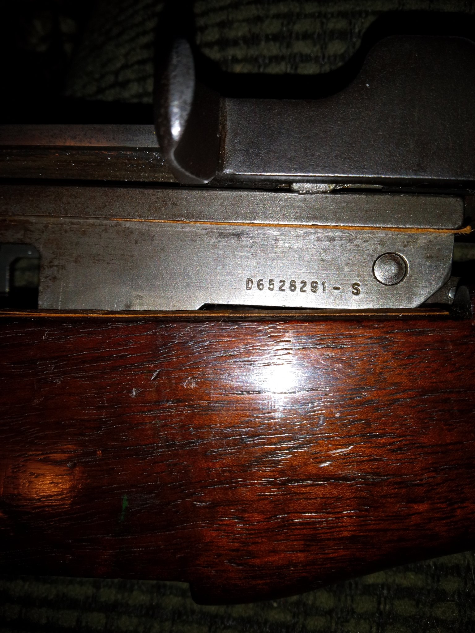

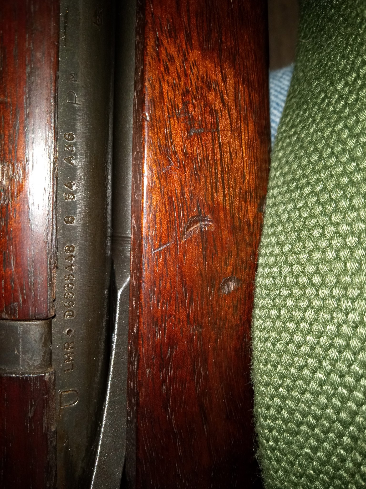

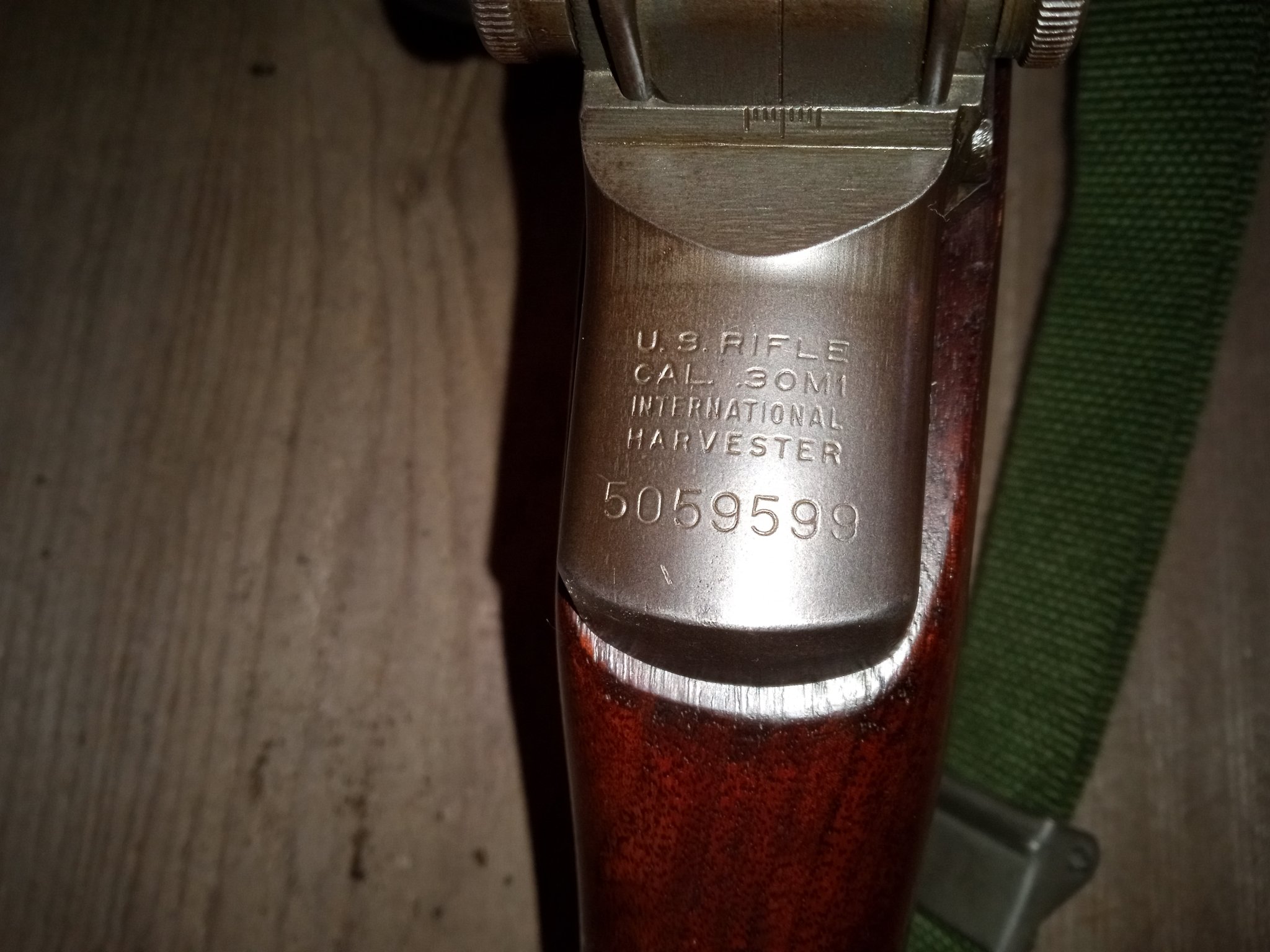

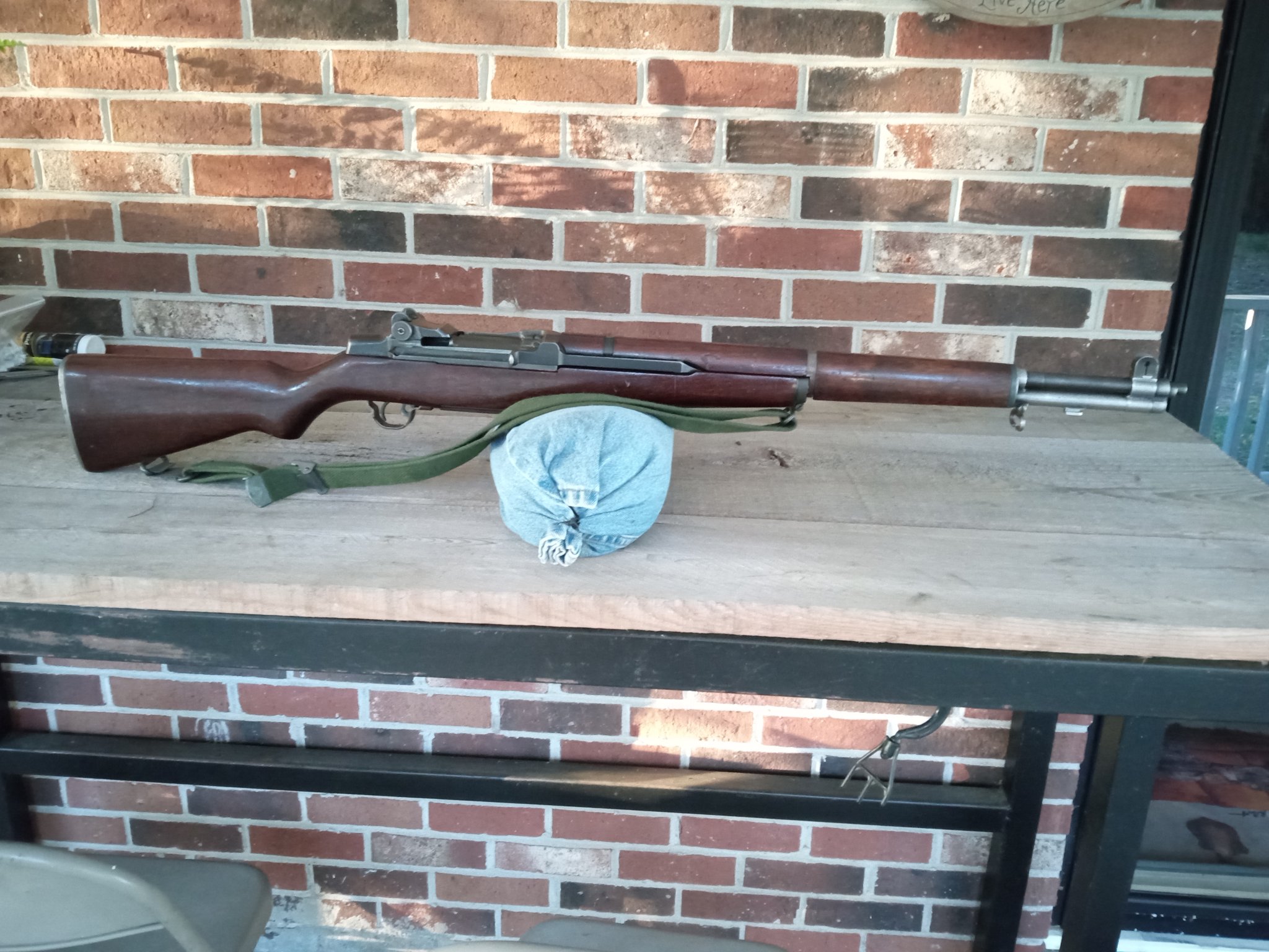

Mine is a 5.05M non rebuild mixmaster. Mostly IHC, stock, safety, front sight, gas cylinder, lock, and lock screw are SA the rest is IHC.
Has an "S" letter code.
