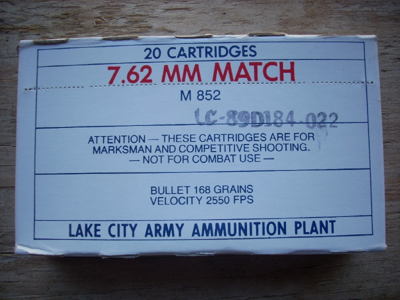

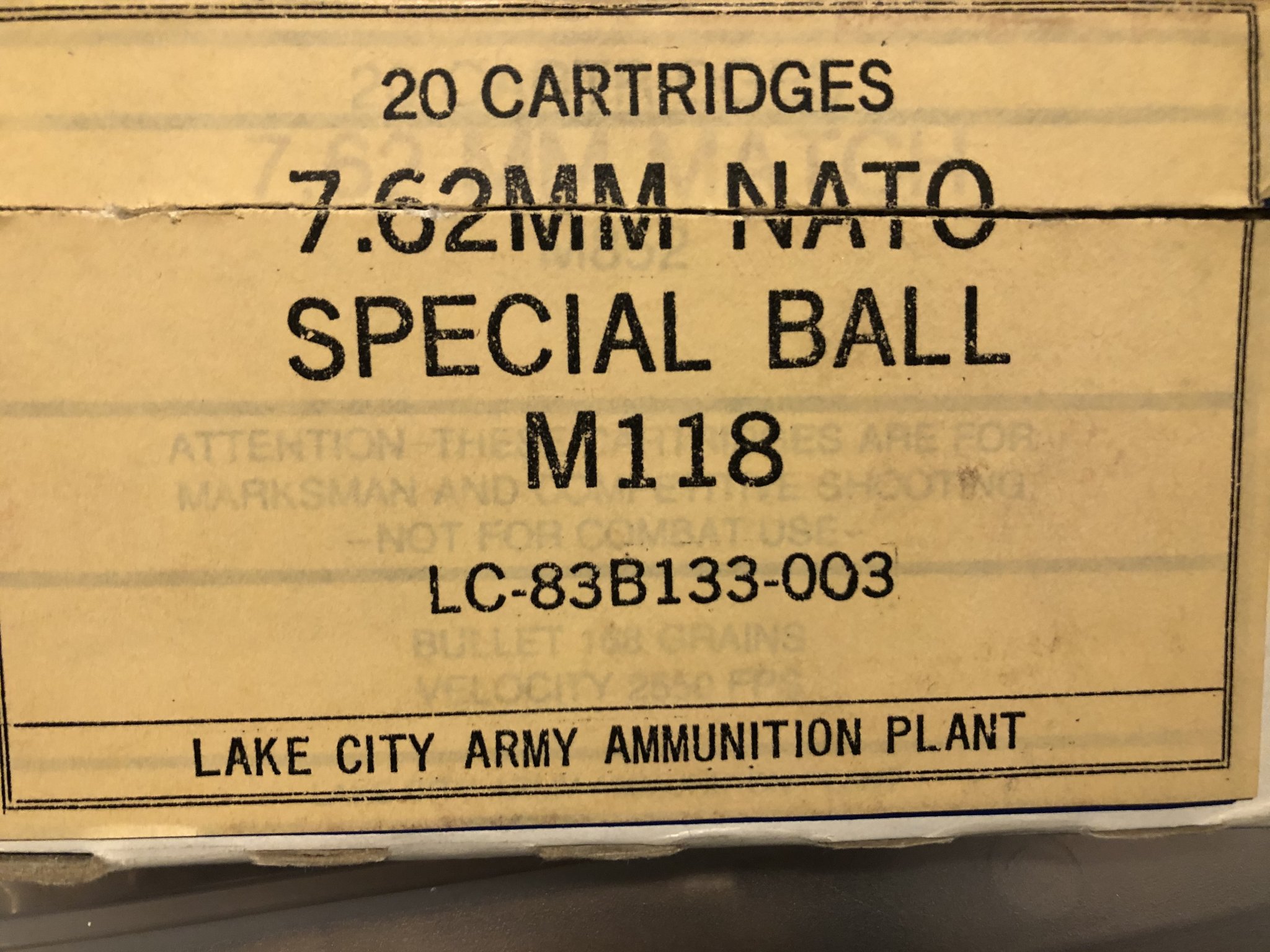

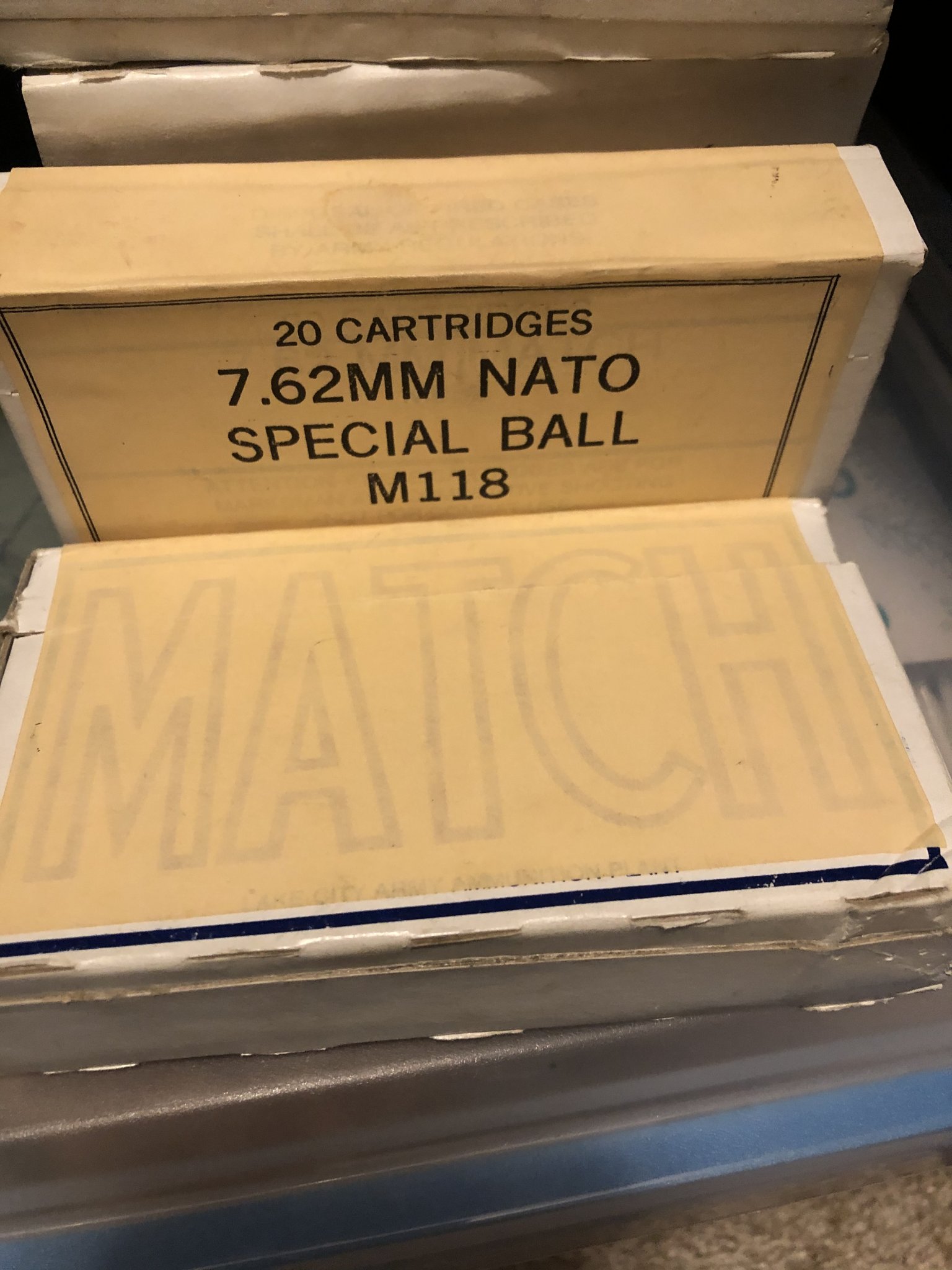

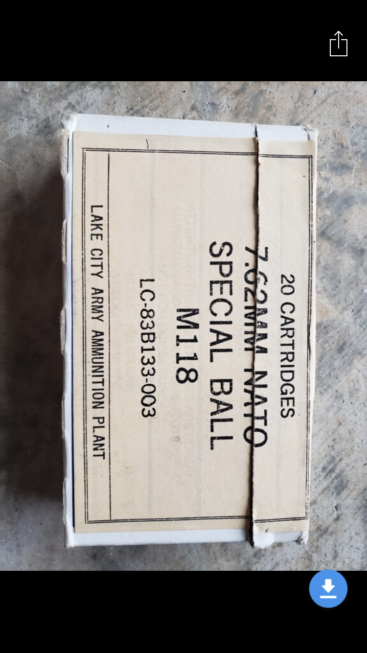

I recently traded for 110 rounds of the below m118 ammo. I thought this was m118lr 175gr hpbt ammo but upon examination it is not.
Wondering what it is? The box says 168 grains, velocity says 2550 or 2650 (it is faded), and the bullets are NOT BTHP. It does say match on back of the box.
Can anyone tell me what it is? I shoot 175gr SMKs in my rem 700 308 which is why I originally purchased these thinking they were 175s.
Appreciate any info? Is this ammo any accurate?
Thanks!

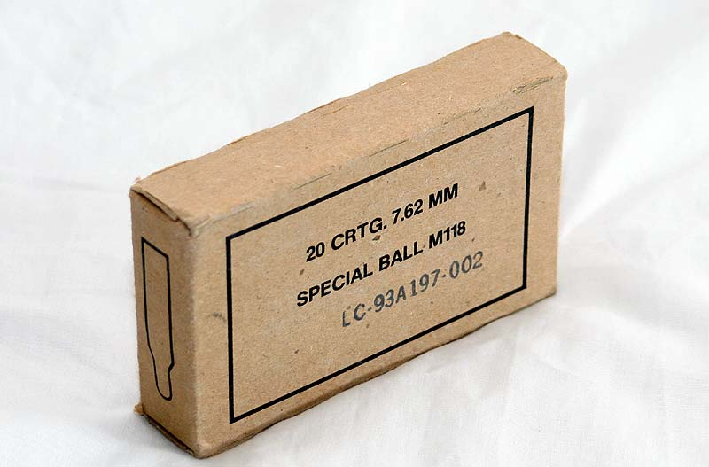

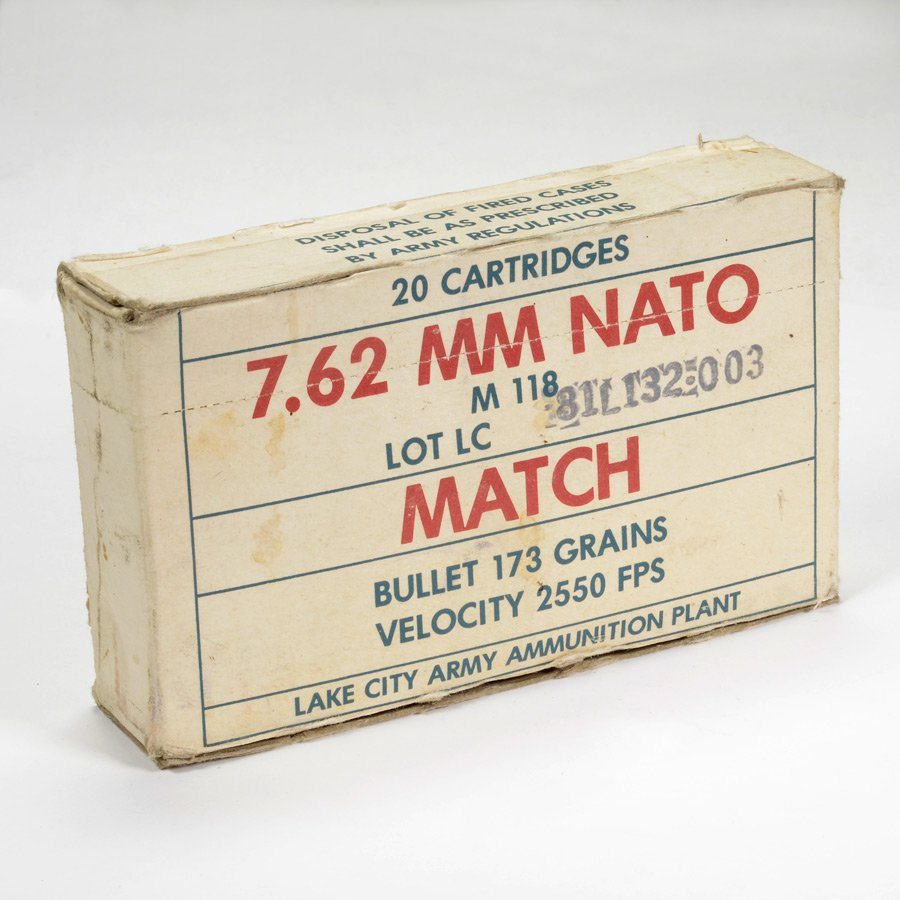

What you have is as the box says is M118 special ball . It is the military 173-1175 gr m118 full metal jacket match bullet loaded into standard 7.62 casings. This came into being after the M 118 National Match ammo was discontinued in favor of M852 match with the Sierra 168 gr Mk bullet and before the M 118 LR. Which has a more consistent case.
That is the short story.

If I remember correctly, that ammo is loaded with the 168 SMK. I've shot it out to 1080 and had fair results, but this was also at 6000' elevation, so the transonic zone was extended a bit. The issue is the 168 SMK entering the transonic zone. The 175 is better suited for shooting out to 1K
Like it has been said, it is so so ammo. It's been a while since I have shot this particular stuff, it's ball ammo, no where near match quality.

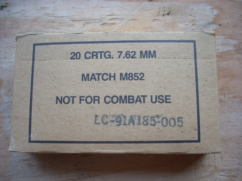

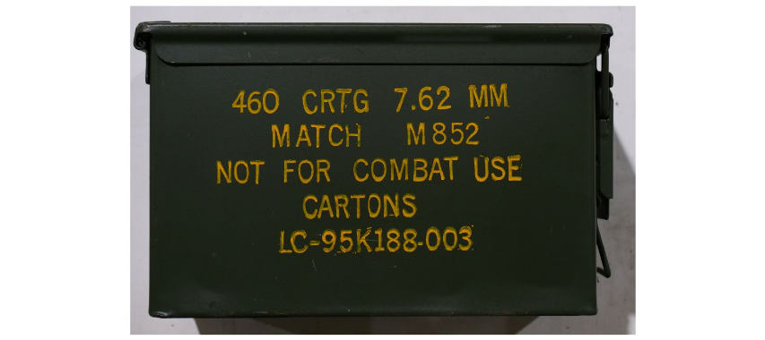

M118 became "Special Ball" when Lake City could no longer produce it to meet "Match" specifications. The USAMU, Guard, and Army Reserve teams pulled M118 bullets and replaced them with 168-grain Sierra Match Kings. Eventually the Army loaded Sierra 168s at Lake City and this became M852 Match. M118 Special Ball remained in system as sniper ammunition because it did not have a hollow tip (M852 cans were stencilled "Not for Combat Use").

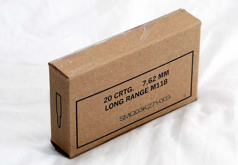

Eventually Colonel Hayes Parks wrote the Army Judge Advocate General determination that the hollow tip is an artifact of manufacturing and not specifically designed nor intended to cause undue suffering in violation of the Hague Accords, and M118 Long Range (loaded with Sierra 175 Match Kings) was US military-approved.
