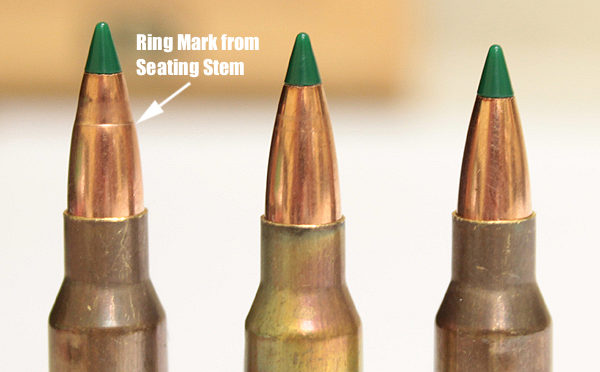

Ah. I missed the part about wanting to do it for runout. Usually people do the whole lapping/honing the seating stem because of a mis-match between the angle of the seater cone and the bullet ogive that is causing a 'ring' or other mark left on the bullet itself. Not sure that it'd do anything for runout.

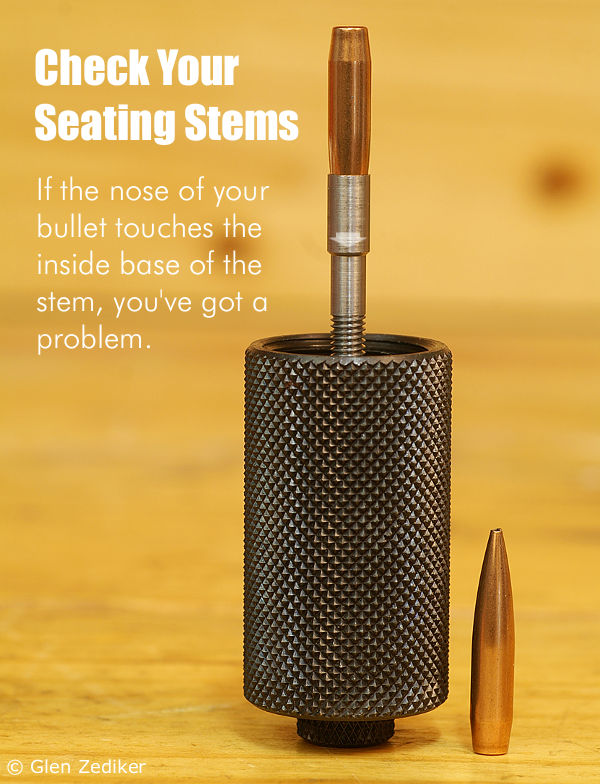

Check to see if its bottoming out. If it is then polishing isnt the answer, drilling that tip out so it doesnt contact prematurely. It should sit down there with even contact all around the circumference, not wobbly back and forth on the tip. Being forster Im inclined to believe that this is not the problem but an easy check to tell for sure.
Thanks. I'm not bottoming out (as you point out, the Forster goes pretty deep) , so I'll try some 300 or 400 grit to start. How long do you think it'd need in the drill? Can you overdo it?
