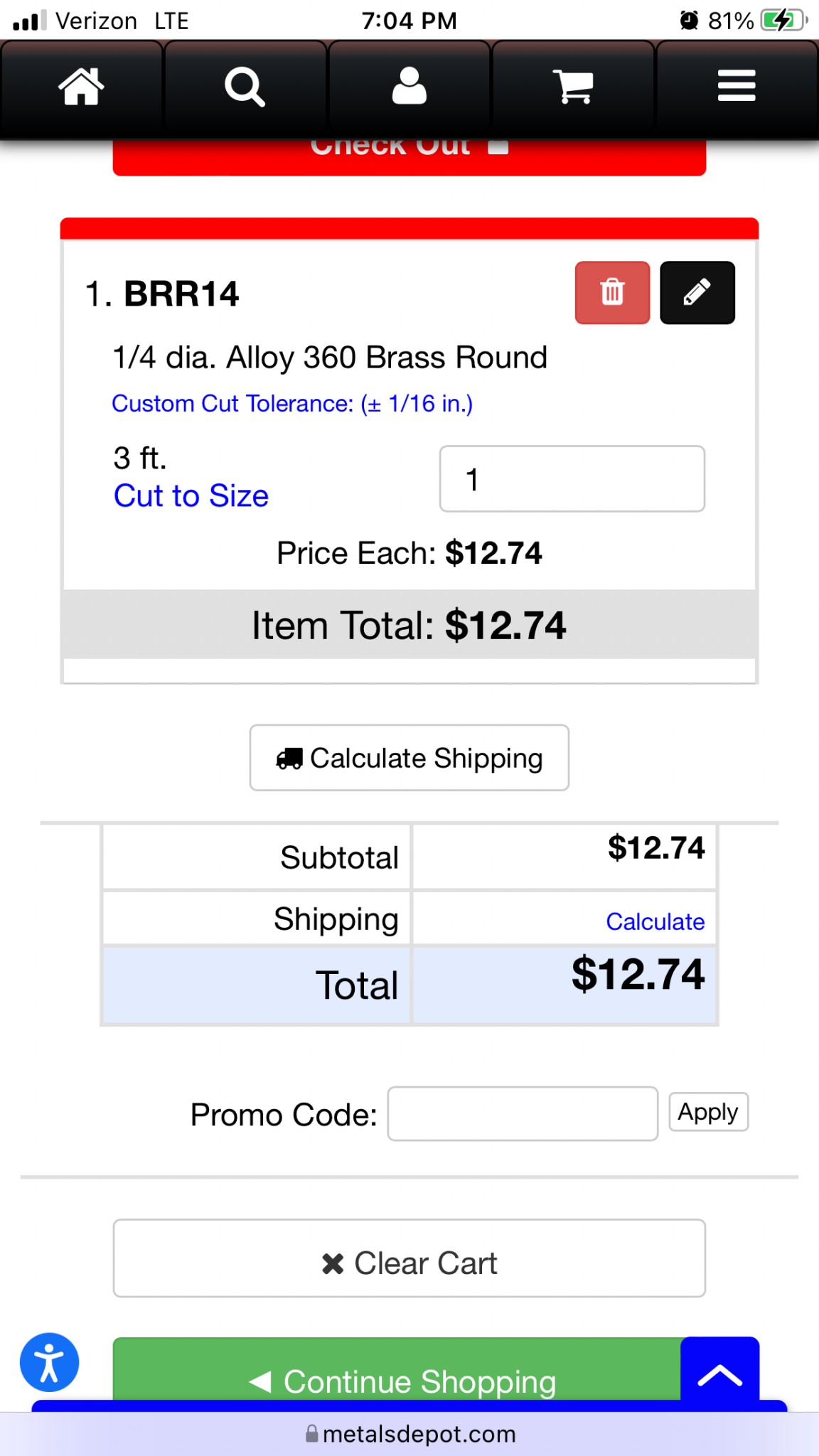

1/4” brass round stock might be worth acquiring.
HD or Lowes should have brass round stock.
Worst case, MetalsDepot.com
