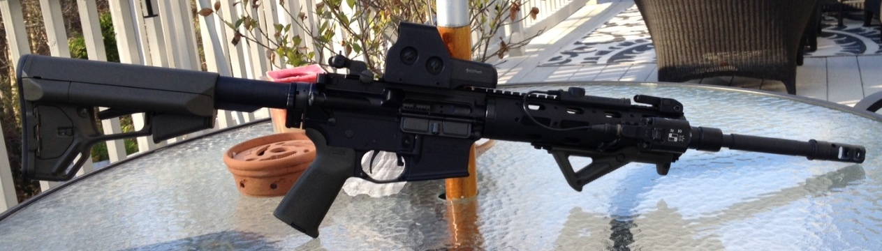

Tweaking your 6920
I was a little disappointed with my 6920 as it came out of the box so I changed components one at a time and am now very happy with it. Mostly repeating what others have said, get a free float tube. Although not on this rifle, my favorite is the Troy Alpha VTAC. For triggers I only use Timney's, most of them at 3lbs. If you ever have to take the trigger out it is much easier to do so with a self-contained unit, especially if you are tired and have cold fingers. All my ARs have a Syrac adjustable gas block. They are easy to adjust and make a huge difference. Finally, get a good muzzle brake. After lots of experimentation I just use the Surefires. They don't require tuning and have done wonders for my double taps. Accuracy is much better because of better trigger control and reduced recoil impulse. A mid length gas system would help but I have no need change out the barrel as it does everything I need for this particular rifle. I agree with the poster who said to have a competent gunsmith do the work. But I would add to that to hire one who is willing to show you how it's done. Knowing your rifle and how to tweak it is half the fun and could be worth its weight in gold in a pinch.
Please report back with your results.
I finally made it to a real computer and saw your Colt. that is a really cool setup.
I'm pretty sure I'm not the first person to want a match barrel on a Colt carbine. I see guys all over this forum with RRA, DPMS, etc with high end barrels, is that a waste too? I want a carbine that is capable of a bit more mechanical accuracy than a chrome lined M4 barrel with M4 handguards. I don't want a bench rifle. I already have one. What everybody else is seeing as a waste of a 6920, I'm seeing as a 6920 with a match barrel and trigger.
