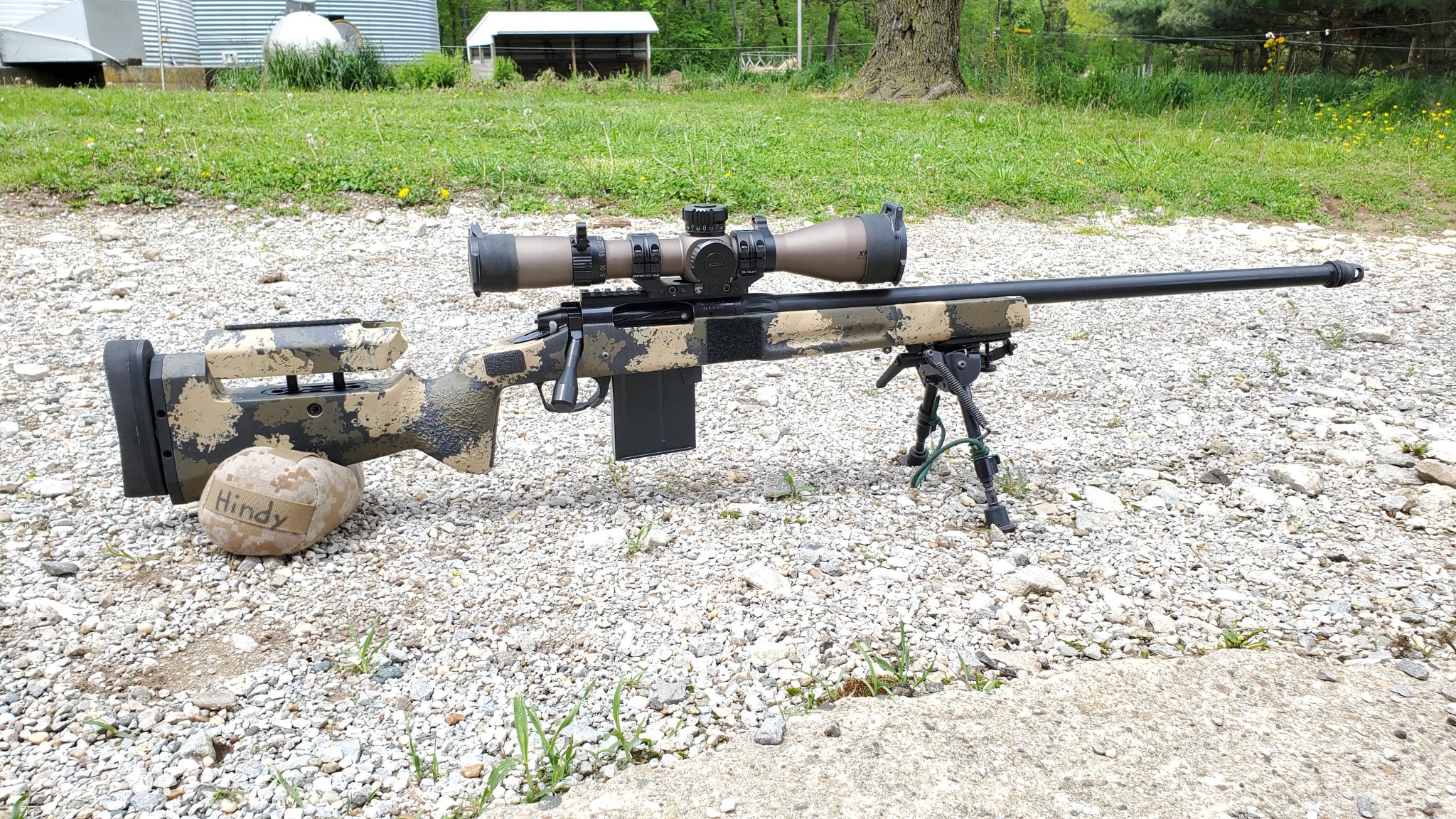

Here's my origin 6creed with a criterion savage prefit
5rds, 105hybrids@3185. The criterion barrels acquit themselves nicely

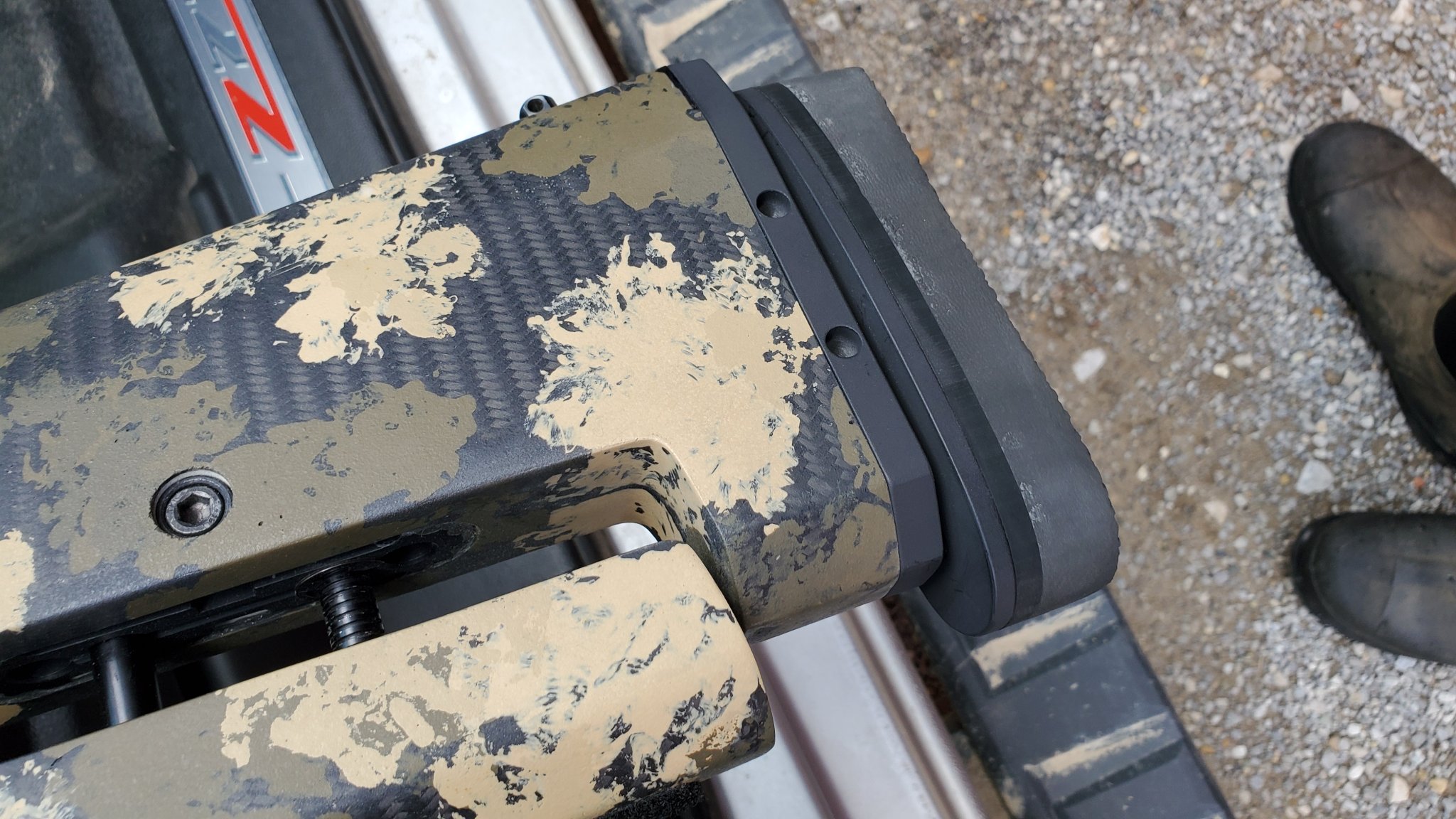

To the OP: If I had to start over I'd probably do the Origin action and build off of that. If you aren't sure if you are serious about this, I'd get a RPR in 6 or 6.5 Creed.

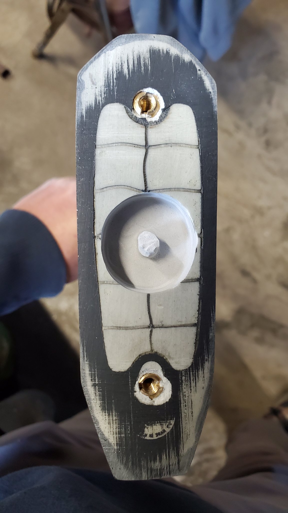

Which buttpad height adjustment are your using on your Manners? Have a T4A I was thinking about possibly adding one too.
Its a graco model with center post. Be advised manners epoxies recoil pad to stock, it has to be sawed off. I also used brass inserts that have coarse outer threads and 10-32 inside threads. They're screwed and glued in to stock
Changing barrels on a Tikka isn't that hard. A friend that hadn't ever taken a barrel off bought a outside action wrench and a barrel vise, changed the first one in about five minutes, second one took a couple whacks with a mallet on the wrench but wasn't difficult according to him. Hard to beat the Tikka for the cost.
