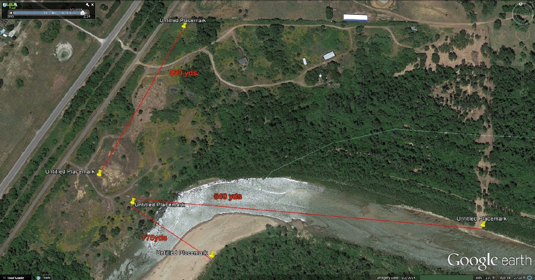

- Private land with 320yrd range and possibly a 640yrd range (why it’s a “possibly” will be addressed later)

Possibility of 640yrd range
Someone may be able to answer this. The 640yrd line shoots over the Brazos River which is state property and considered a navigable waterway. I know you can hunt on the river, but can you shoot across it from your property to your property legally.
