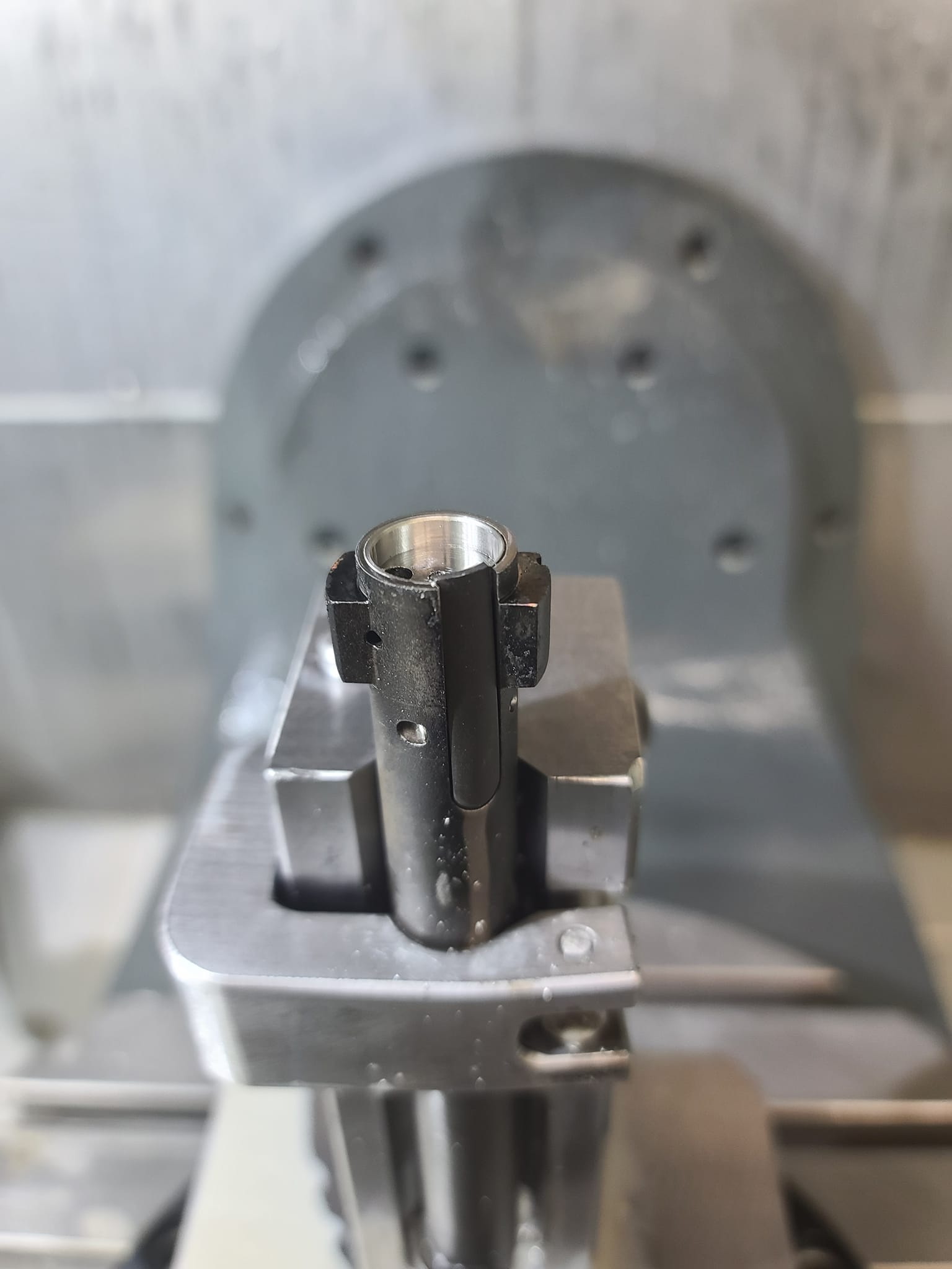

    My two bits:

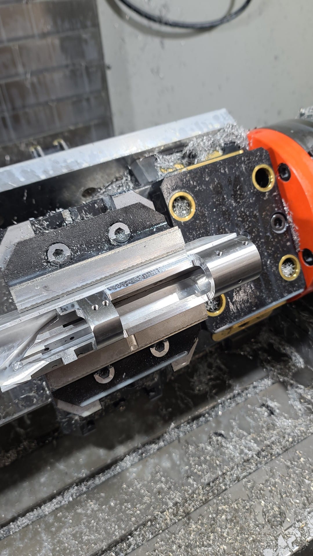

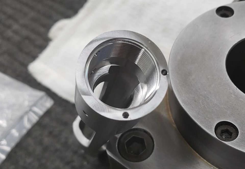

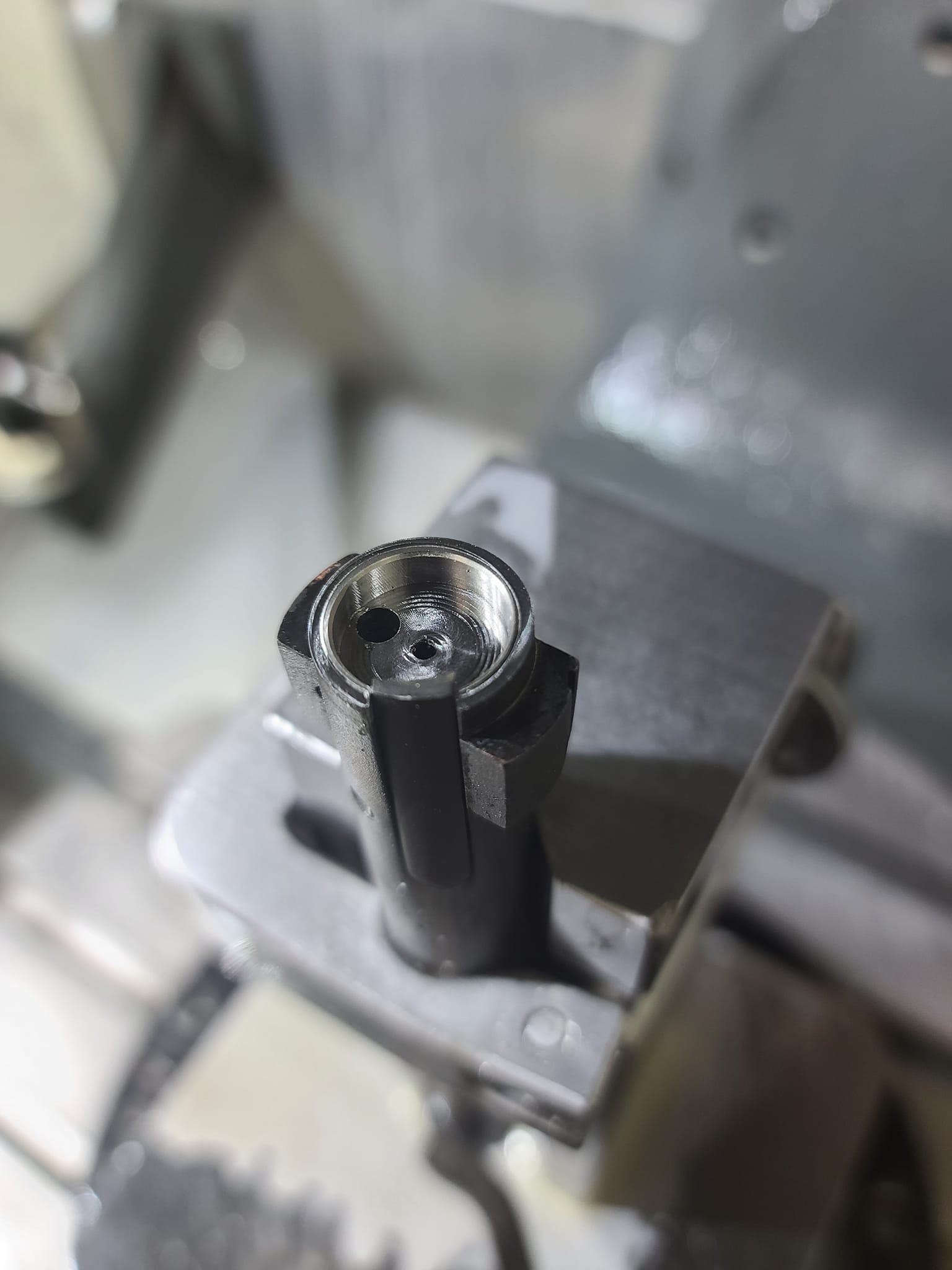

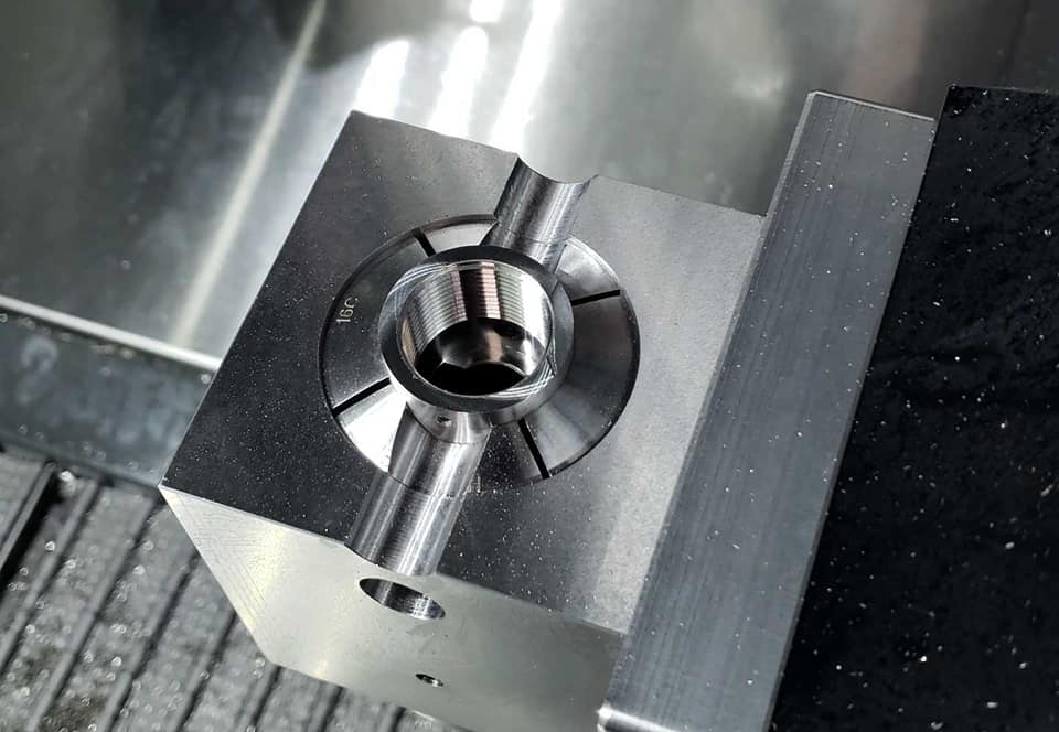

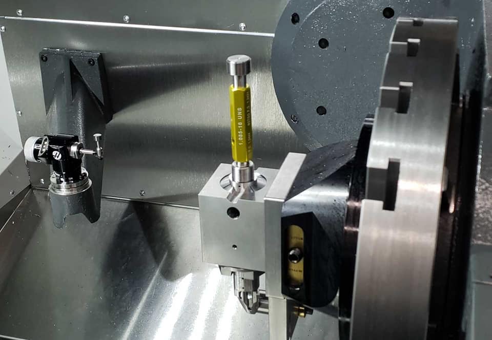

    Blueprinting/accurizing is a term that gets tossed around quite a bit. While I agree that its core purpose is to improve the accuracy potential of a rifle by ensuring all of the critical surfaces of the receiver are in a proper relationship to one another, I have evolved my opinion to try and look at it from a broader perspective. I think the overall functionality of an action is just as important (maybe more) as its accuracy potential.
    Covering all the bases is something I've attempted to address.
    • Honed receiver bores to establish roundness, correct taper issues, and provide clearance for finishing once all the machine work is completed.
    • 8-40 base holes indexed and aligned to the receiver bore through hole interpolation and thread milling instead of drilled/tapped. Drills follow an existing hole. Taps take the path of least resistance. ID boring and thread milling will correct a positional error.
    • Improving extraction with the M16 conversion. OEM M700-type extractors work until they don't. M16s are significantly more robust. The most accurate rifle in the world is useless if you can't use it.
    • Fixing Primary Extraction. Late model M700 handles were made incorrectly. The difference is immediately visible when an older legacy action is referenced. Correcting the cam geometry is the only way to solve this problem.
    • Bushing a striker pin hole on the boltface to mitigate cratered primers and boltface erosion.
    • Pinning a recoil lug. On a bedded rifle or one about to be bedded, having the lug indexed/timed with a repeatable location is critical to accuracy. It's quite common to pull a barreled action apart a half dozen times when fitting a rifle. If the lug is not indexed to the exact location as when it was bedded in the stock, the rifle will be problematic because it is biasing one side of the stock. Guard screws and floor metals will not fit correctly.
    Adding to this are several elective options that can improve aesthetics. The Model 7, IMO is an ugly action. The belt sander ejection port reminds me of an 8th-grade shop class project. We offer an alternative solution for those interested.
    Hope this helps.
    C.
