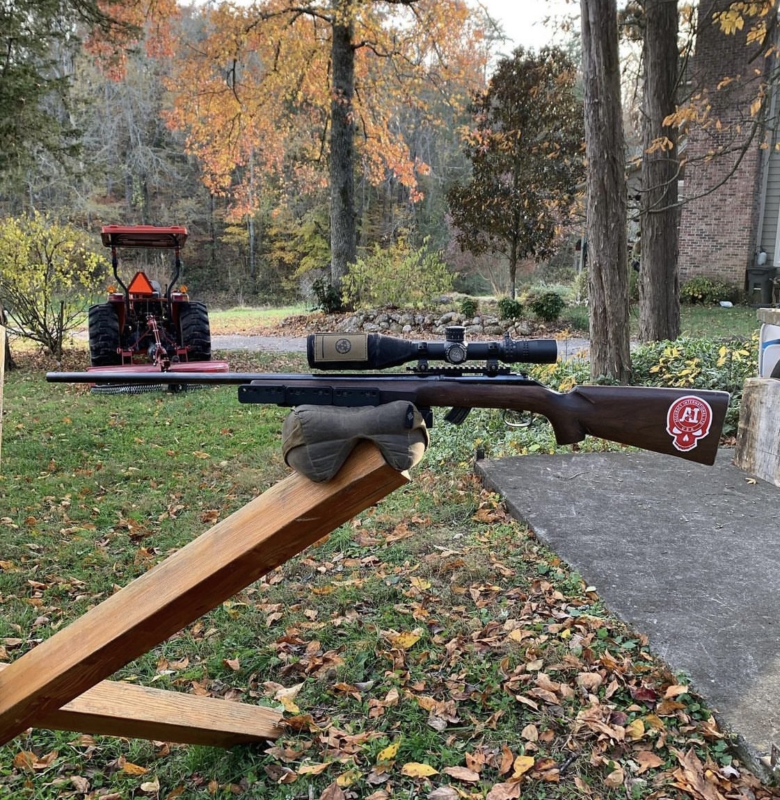

I will preface my comments that I am not a Vudoo shooter. I have owned multiple Anschutz models over the years. I am currently shooting 2 54:18s and a 1727F/AI rig. there are difference between the 1710 and the 54:18 that are important. The 54:18 is built off the 54 match rifle and has a match level trigger (far supierior). The 1710 is part of the sporter series. I have also heard great things about the 1761 series. The vodoo gives you a greater selection of barrels, Triggers and stocks being a Rem 700 clone. The Annies are more of a set menu, Yes you can get it re-barreled after sale (I got a great one done by Anshutz NA.

Agree with Fig, if you are serious about shooting, you will never be happy without building one the way you want it. I no longer shoot anywhere near competitively due to some physical issues, but I love accurate rifles and my 1727/AI is wonderfully accurate and "cool"(at least to me :ROFLMAO:), it how ever really heavy and more set up for NRL or PRS.

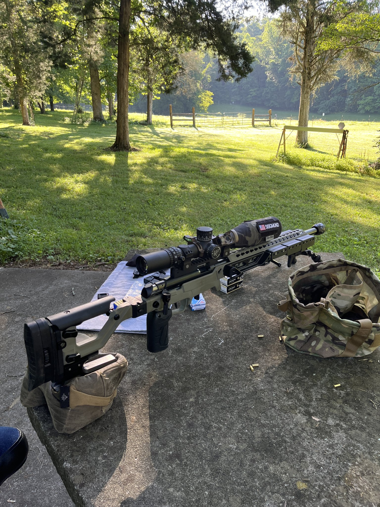

I'll preface my comments that I am a Vudoo shooter and have been since their beginning in 2017. I am still shooting my original V22 serial number 10 and it's great. I did get it rebarreled a little over a year or so ago with a 1.2" Bartlein barrel. Being able to use any of my 700 foot print stocks/chassis and triggers is a huge advantage.

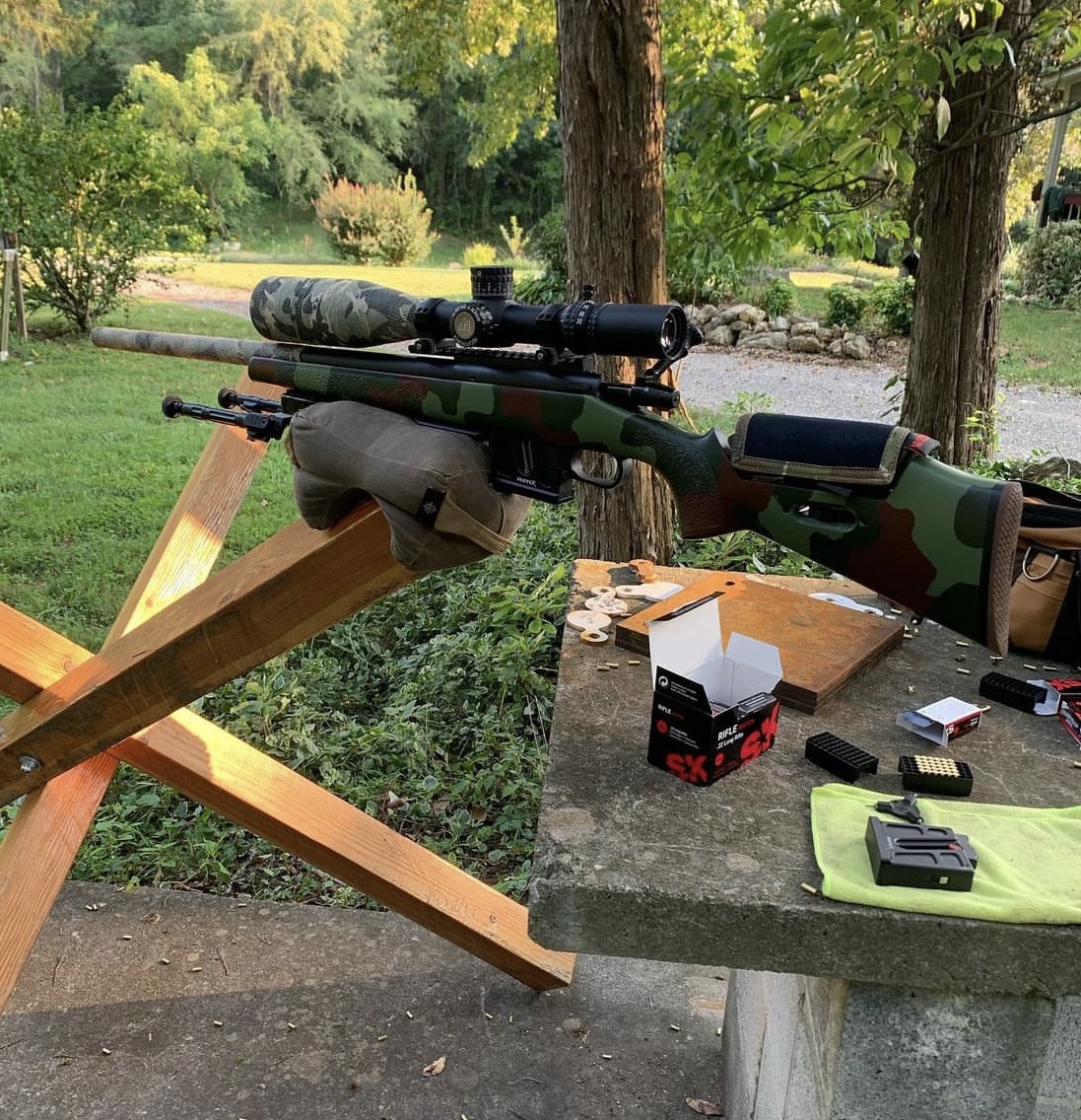

Anschutz 1727F Match-AT-X, RimX-AT-X, RimX McMillan M40A1, Winchester 52C
Annie is the "new" rifle, RimX's Bartlien Barrels spun up by TS Customs and the Winchester 52. Right now the Anschutz is the new fascination. Son in-law shoots a Vudoo in a AT-X. I practice with and shoot all 4 in NRL22 and PRS Rimfire matches. Can't go wrong with any of them.

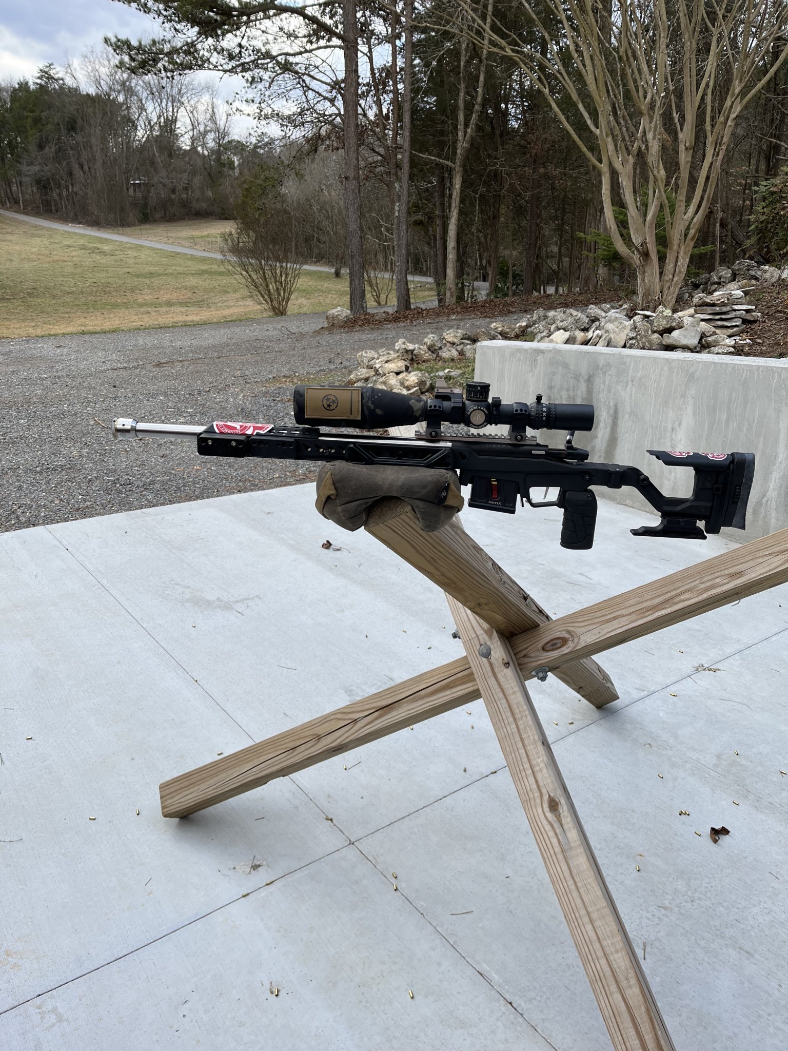

I have owned and sold two Vudoos. I have 10k rounds through my first RimX, and have a second that is getting broken in. The RimX magazine works very well, and I prefer the feel of the action over the vudoos.
I have a 1710 in the MDT chassis (check the px). The trigger is incredible. The insertion of the magazine can take a lot of practice to do quickly on the clock. And the bolt requires a cadence to operate and not induce a misfeed. I can run the bolt on my RimX almost as fast as I can possibly imagine, with no issue. If I do that with the Annie, I have a feeding issue 1-2 rounds out of 10. Operating it at a moderate pace , with very deliberate movements, and it feeds perfect - all ammo types too. It is a nice rifle , turns heads, and accuracy wise is a beast. But the operational differences to me drive me to stick with RimX.

OP, I own a first-gen Vudoo and a Rim-X I built in late 2022. After competing at one level or another with both of them all last year, I find myself favoring my Vudoo.
Why?
Well, I like chocolate ice cream better than vanilla. I like both. But I like chocolate better. It's a preference, pure and simple. No other reason. Both are superbly accurate. The do feel a bit different to run, in no small part because they're in different chassis and the Rim-X has a much heavier barrel contour (22" Shilen Heavy Varmint compared to the Vudoo's 22" Bartlein MTU).
I will say one thing in the Rim-X's favor right up front: it feeds smoother than the Vudoo. Period. The Vudoo is in an MPA BA Comp chassis; the Rim-X is in an MDT ACC Premier. I don't think the chassis have anything to do with the smoothness of feeding; the two platforms simply have different design philosophies.

I own an Annie 1761 MPR and 3 1/2 Vudoo's (second single shot now being built). I keep the Annie around because I have an affinity for blue steel and wood but I shoot the Vudoo's.
