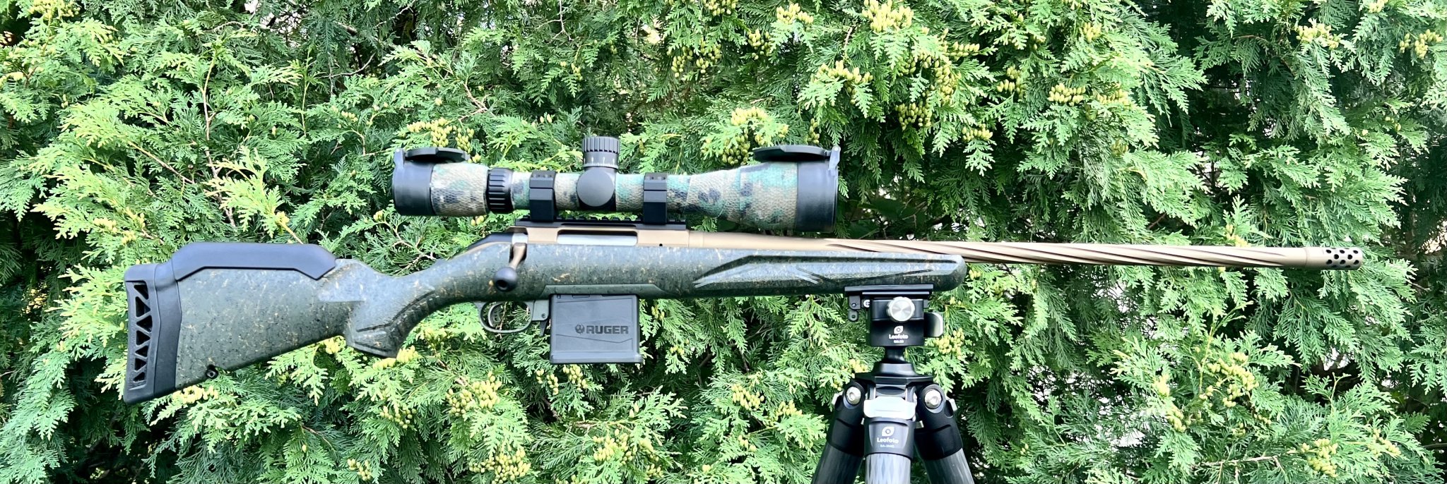

I have the heat seeker on my ruger American, only complaint is it would not feed a round with a ruger brand aics pattern magazine. Had to buy a magpul one for it to feed correctly. Other than that, it’s pretty solid, looks good and the ar buffer tube and pistol grip compatibility is pretty cool.

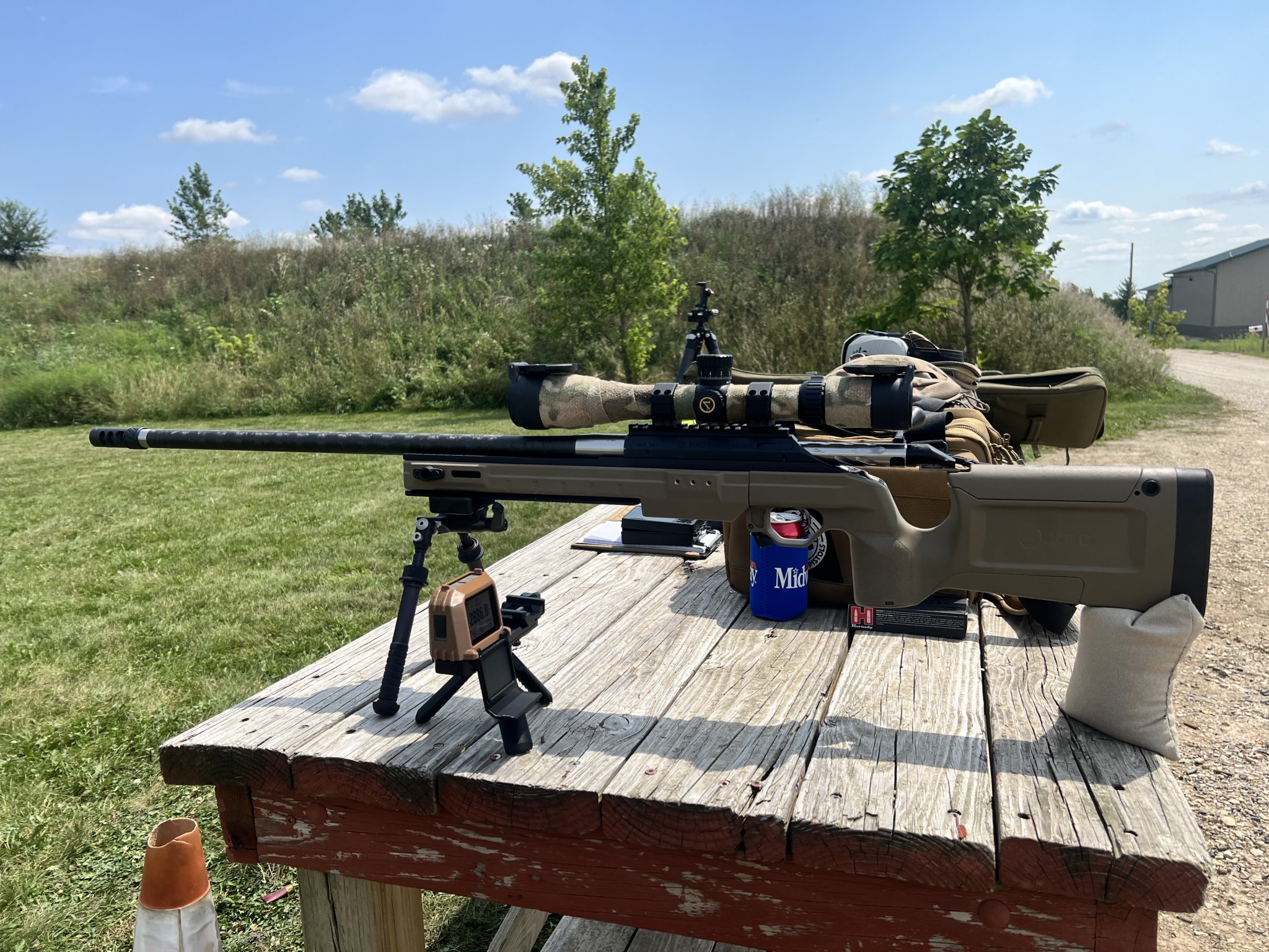

It should be in that ballpark. My KRG Bravo with Remington 700 7mm RM (1-8 tw) ADL starts out a pound heavier. With 4.5-14X50mm LR Tactical in GG&G rings is just over 10 lbs. With a lighter scope and aluminum rings you could be between 8-8.5 lbs.
Good choice. Mine with a Leupold Mk3 scope/ no bipod weighs a little over 9lbs, with the Athlon around 10 lbs. Switching from the 22” Predator barrel to the 24” CF Bartlein didn’t change the weight at all.

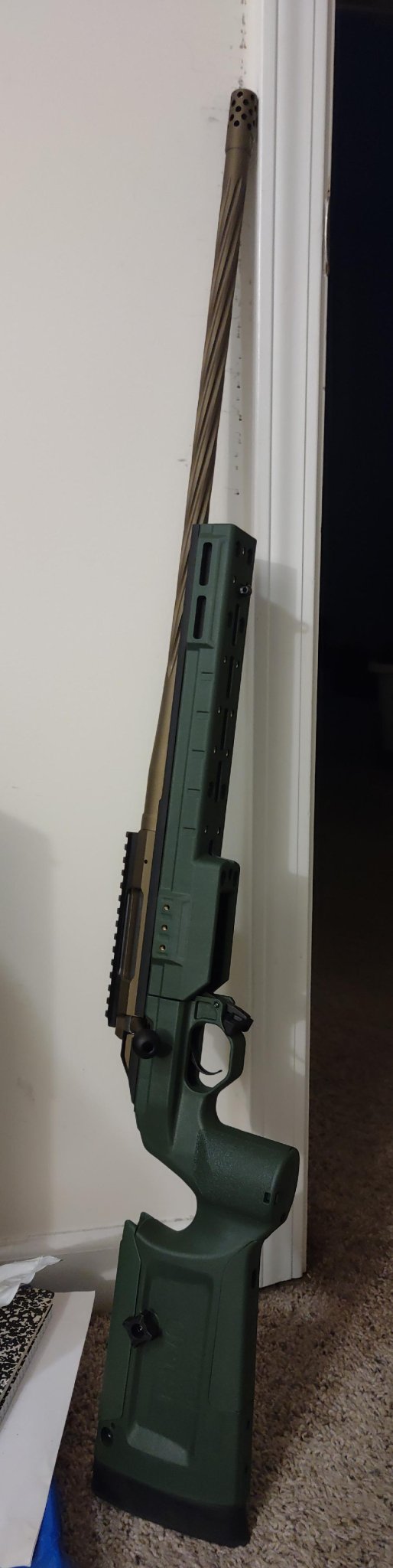

Just installed the Ruger Gen 2 Predator into a KRG Bravo. With no scope, I am at 7.25 lbs. Right at where I want to be. I have an 18 oz Vortex Diamondback and with the rings, I should be around 8.5. Thanks all.

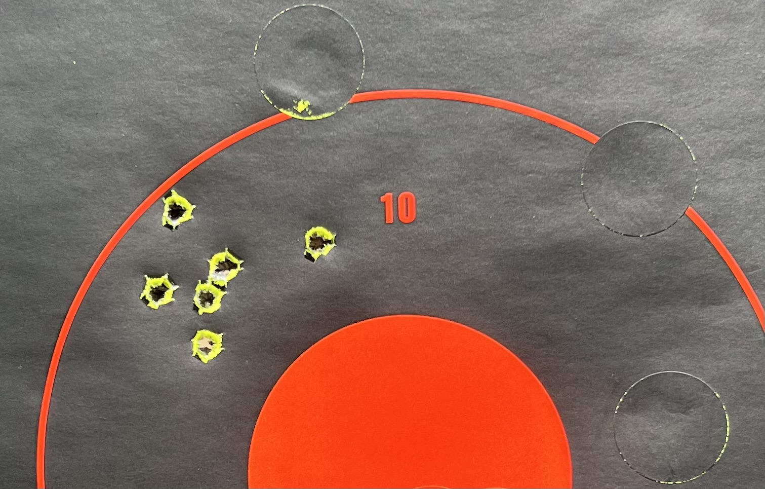

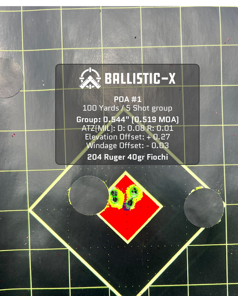

The 204 shoots really well. I tried it with Fiochi 40gr and Hornady 32gr. The velocity was a little lower than I expected but it’s accurate so I don’t care. This is the Hornady at 200yds off a bipod and bag
