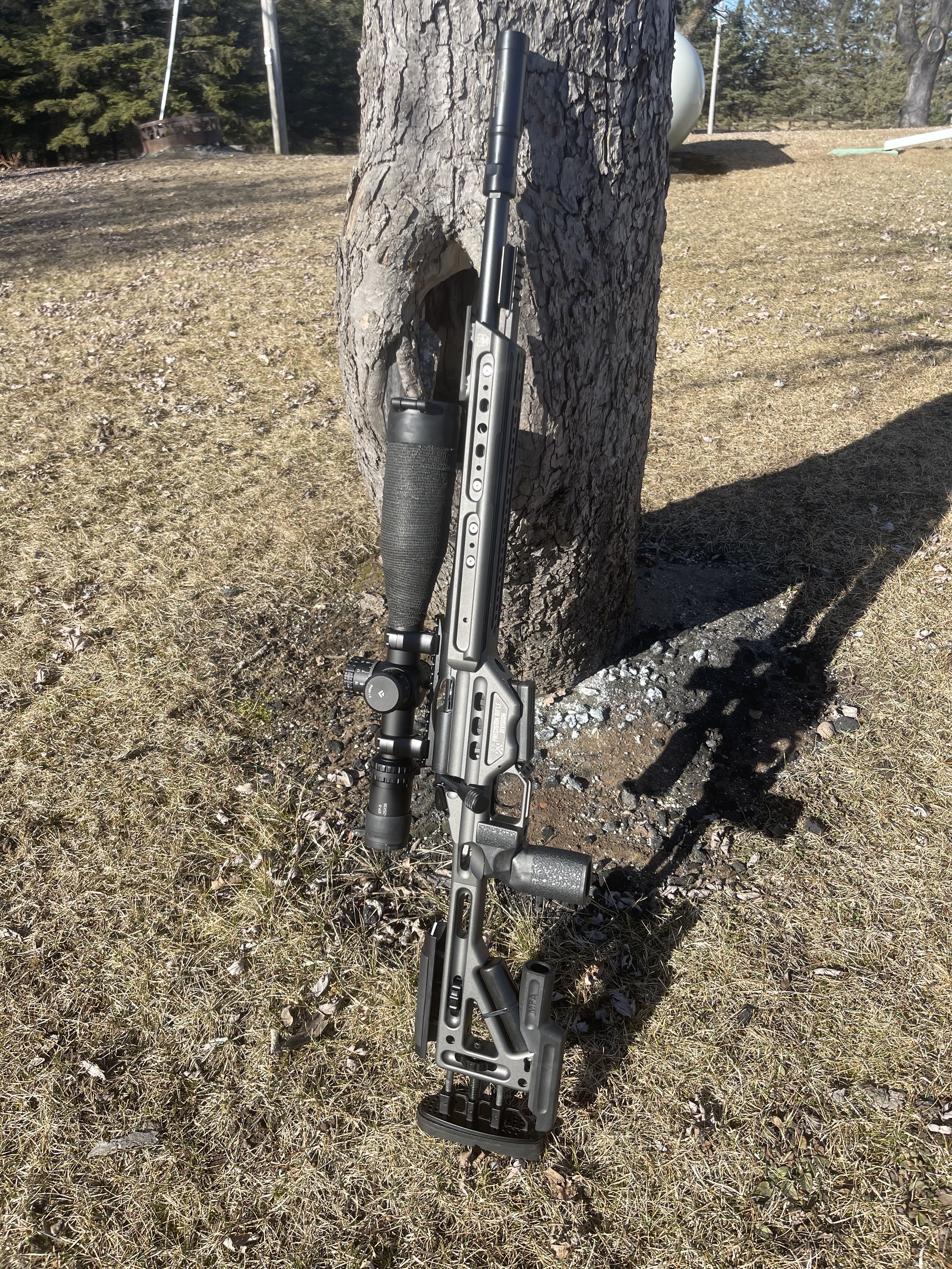

    I have the heavy barrel with an MDT chassis. It balances pretty well just in front of the mag well. The only magazine I have is the Bergara that came with the BA. No feeding extraction or ejection issues.

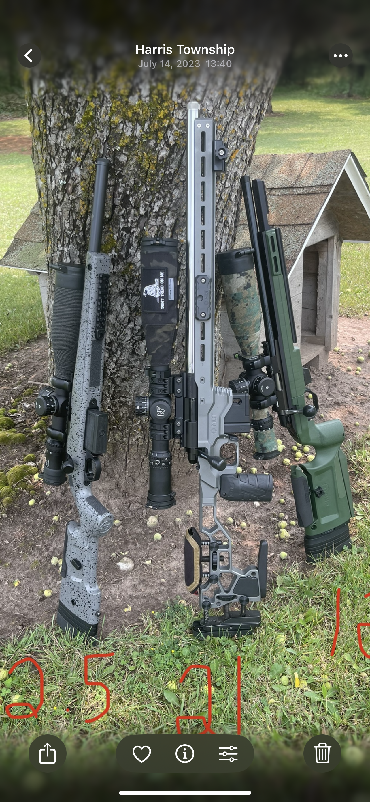

    I had a mdt premier on this prior to the MPA I just hated the way it looked Unsuppressed with the barrel short of the forend. It did however feed great in that chassis. Shouldn’t be an issue with a few inches more barrel
    This was my 20” Vudoo I had in the mdt

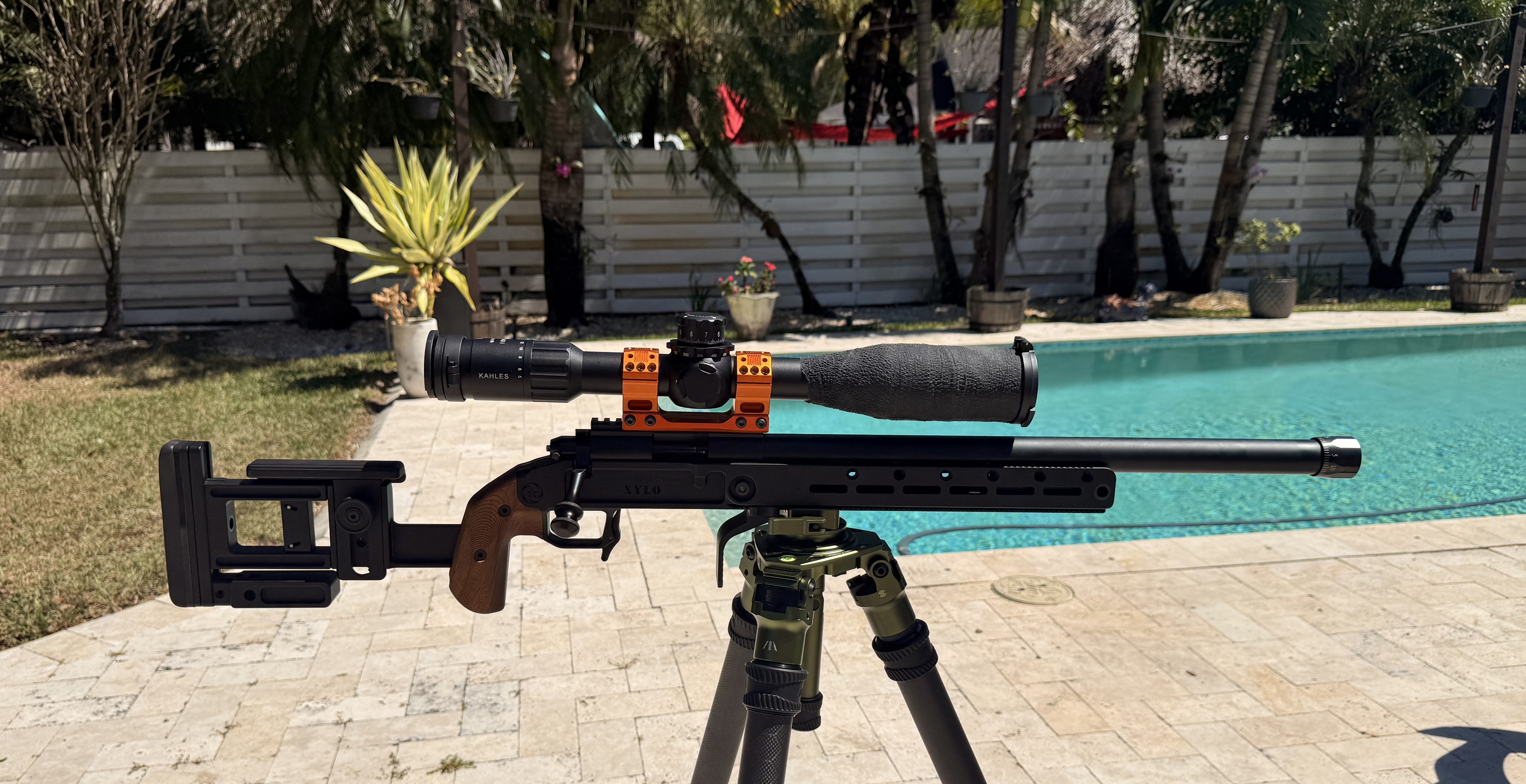

    Mine's in a 17" Aero Solus. I went way overboard with the weights just because the L3i set was cheap on Black Friday, it balances about 5" in front of the magwell now with bipod mounted.:D Feeds perfectly with Bergara and Vudoo polymer mags. I also have a TriggerTech 2-stage installed.
    Reactions: hafejd30
    Nice setup you have there. How are you liking that Solus chassis?
    Love it, it does everything I need and for $550ish around the holidays it's an unbeatable deal. This particular one is actually my third Solus chassis, and has the updated QD cheekpiece (only change is an open slot in the bottom so you can pull it straight out the top). I've swapped two different B-14Rs in and out of all three chassis and they all feed and function perfectly with no adjustments needed. For comparison I started out with a KRG Bravo and it took a lot of tweaking before I got it working reliability. My only real gripes are - the sidefolding adapter still isn't available, and the forend is apparently shorter top-to-bottom than other chassis so standard MLOK weights block the Arca rail (which is why mine are mounted at the back instead of up front).

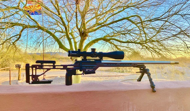

    I have a b14 in mdt premier chassis. Swapped barrel for KI Precision 24” 1.220 barrel. Balance is great even without bipod . No weights up front. I still need to get a diamond trigger but I procrastinate…
    Reactions: hafejd30

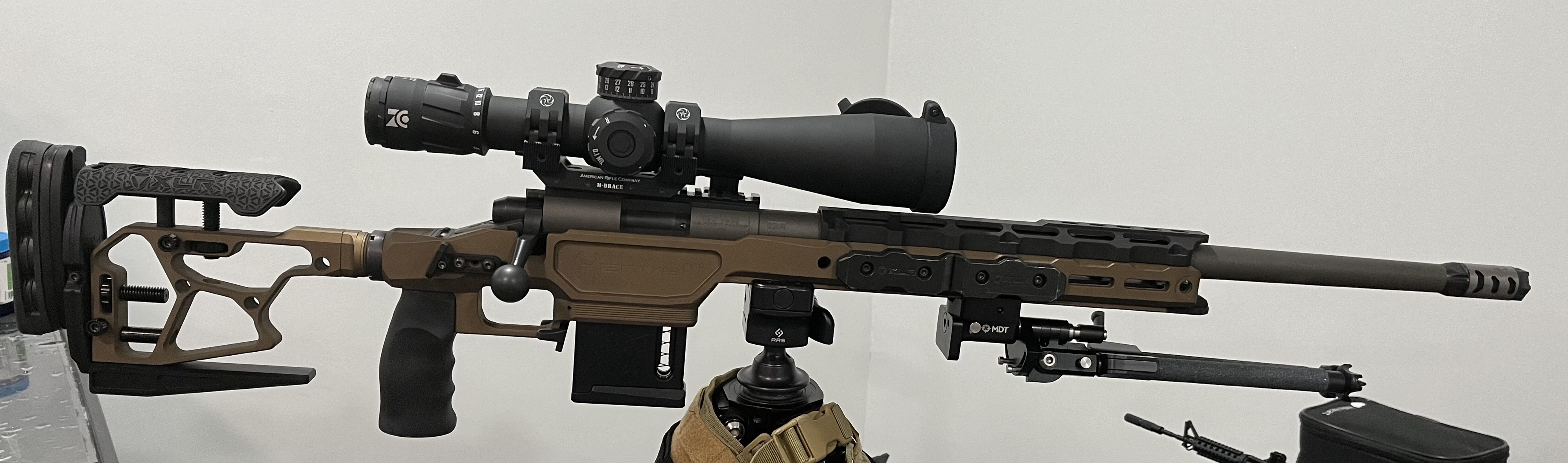

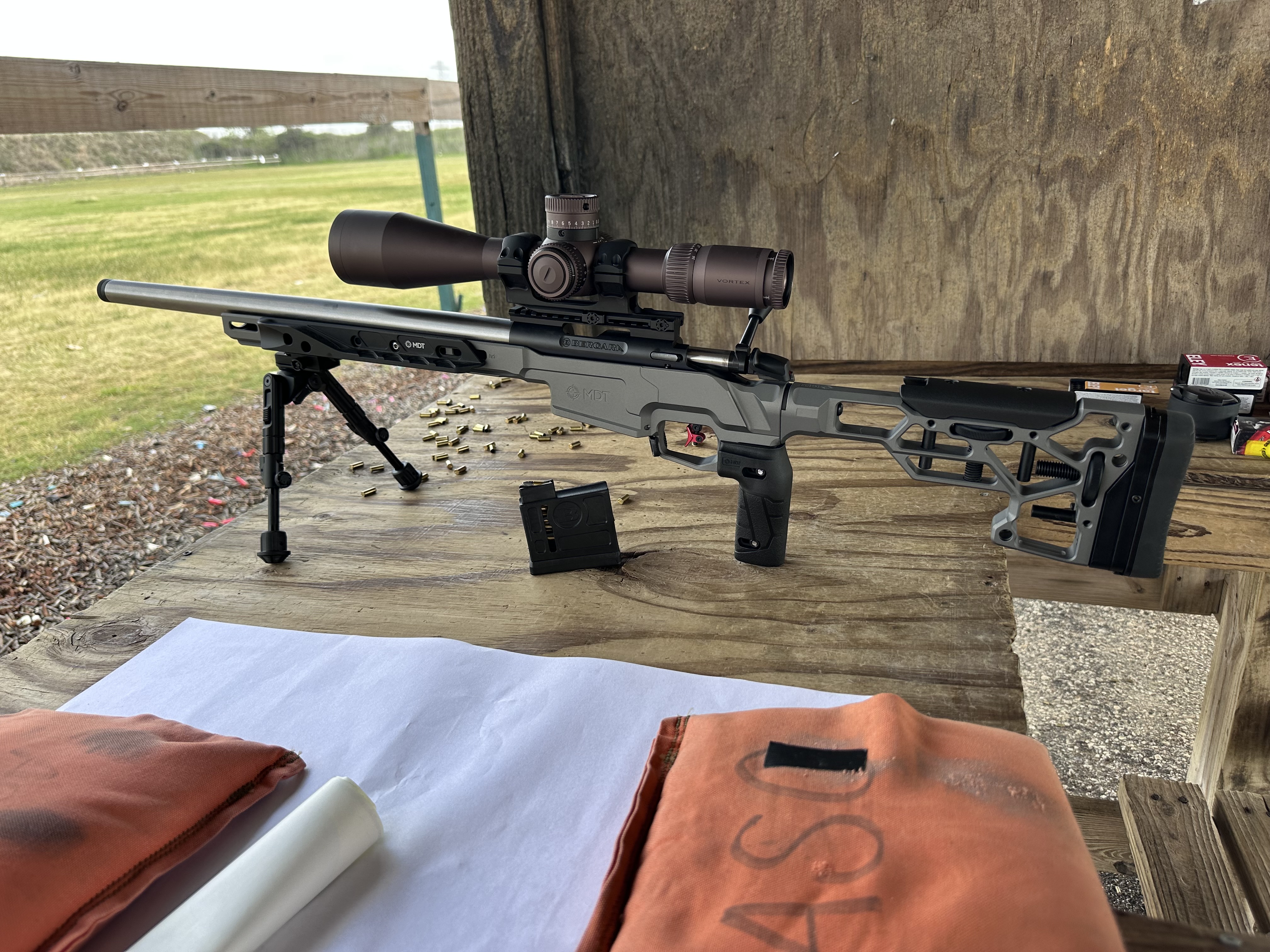

    Friends have the MDT ACC Gen 2, know of 3(2 with 20" and 1 with 18" B14R), no feeding issues and balances right around 17-18 lbs at 4" forward of mag well with 20". Still needs weight to do so.

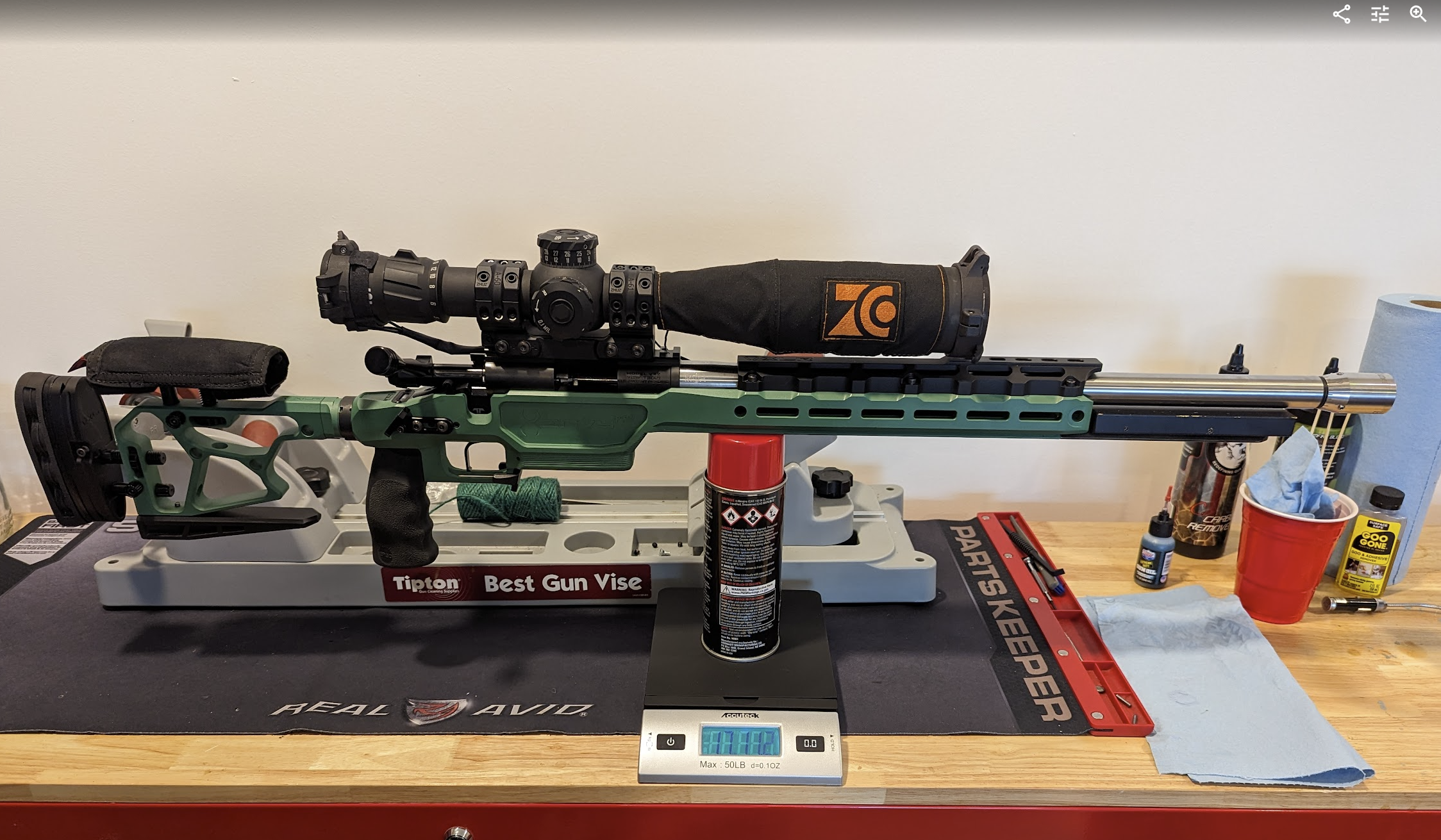

    Has internals in the area where the steel external is. I guess if you went XL weights you could get little more weight up front too.
    This is a 23" 1.2" straight on it.

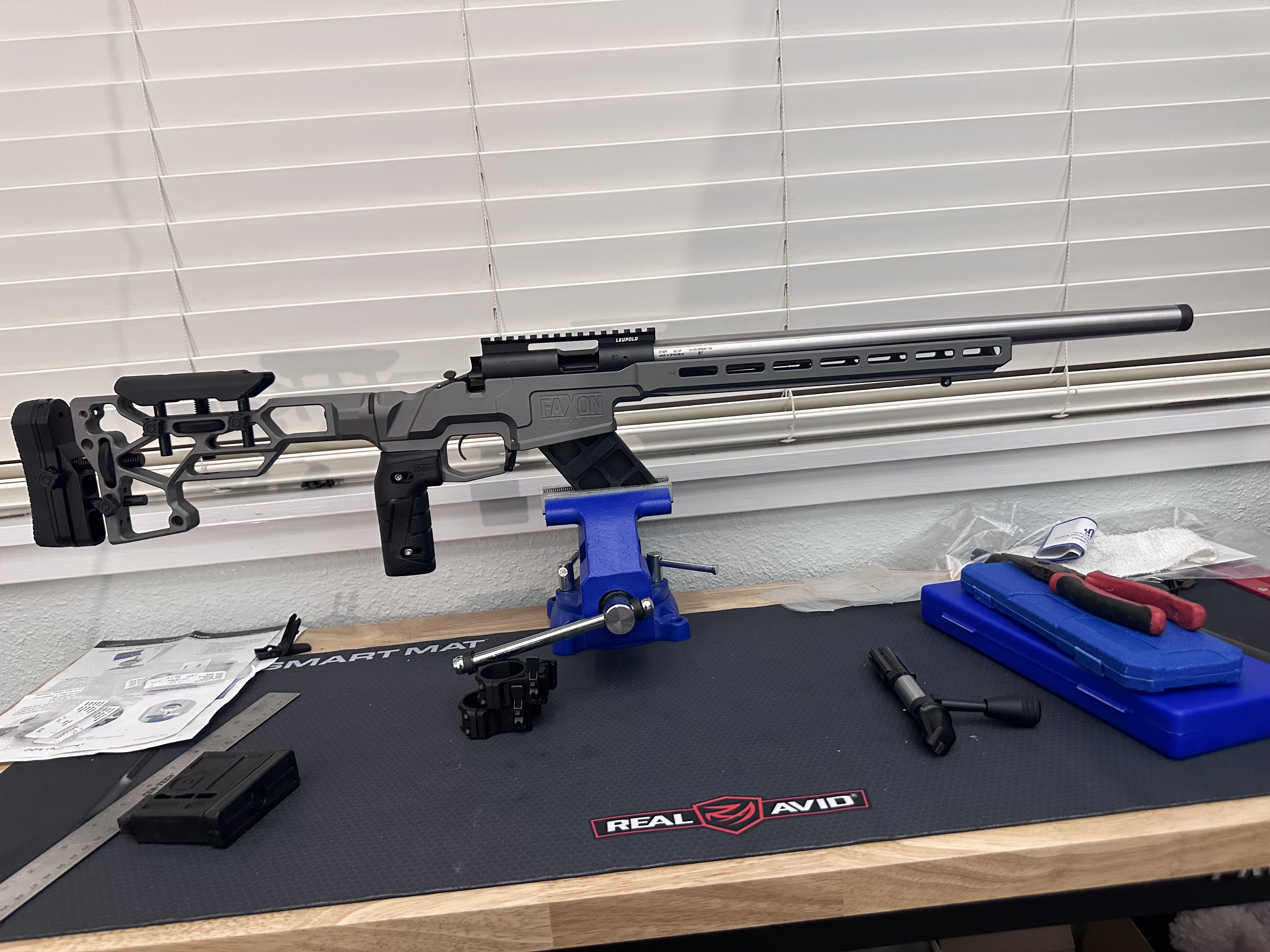

    My 18” in the MPA BA comp with a rear weight is very close to balancing. Has weights In the front internal as well. I think the 20” would balance it perfect so maybe another comp is in my future.

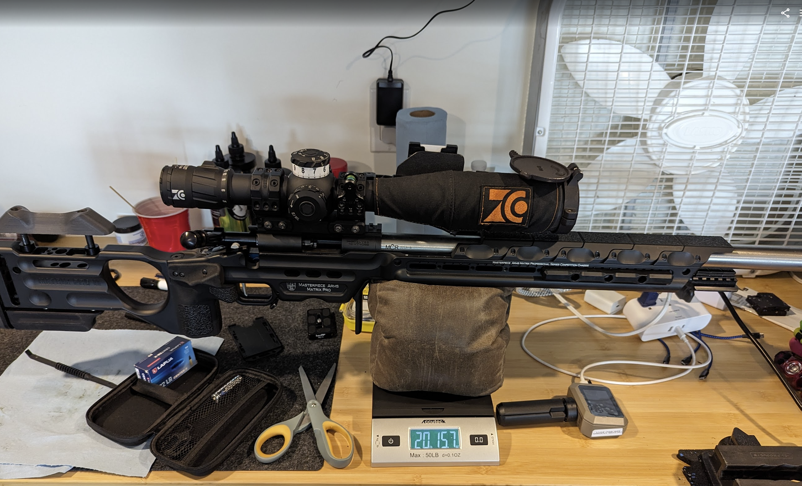

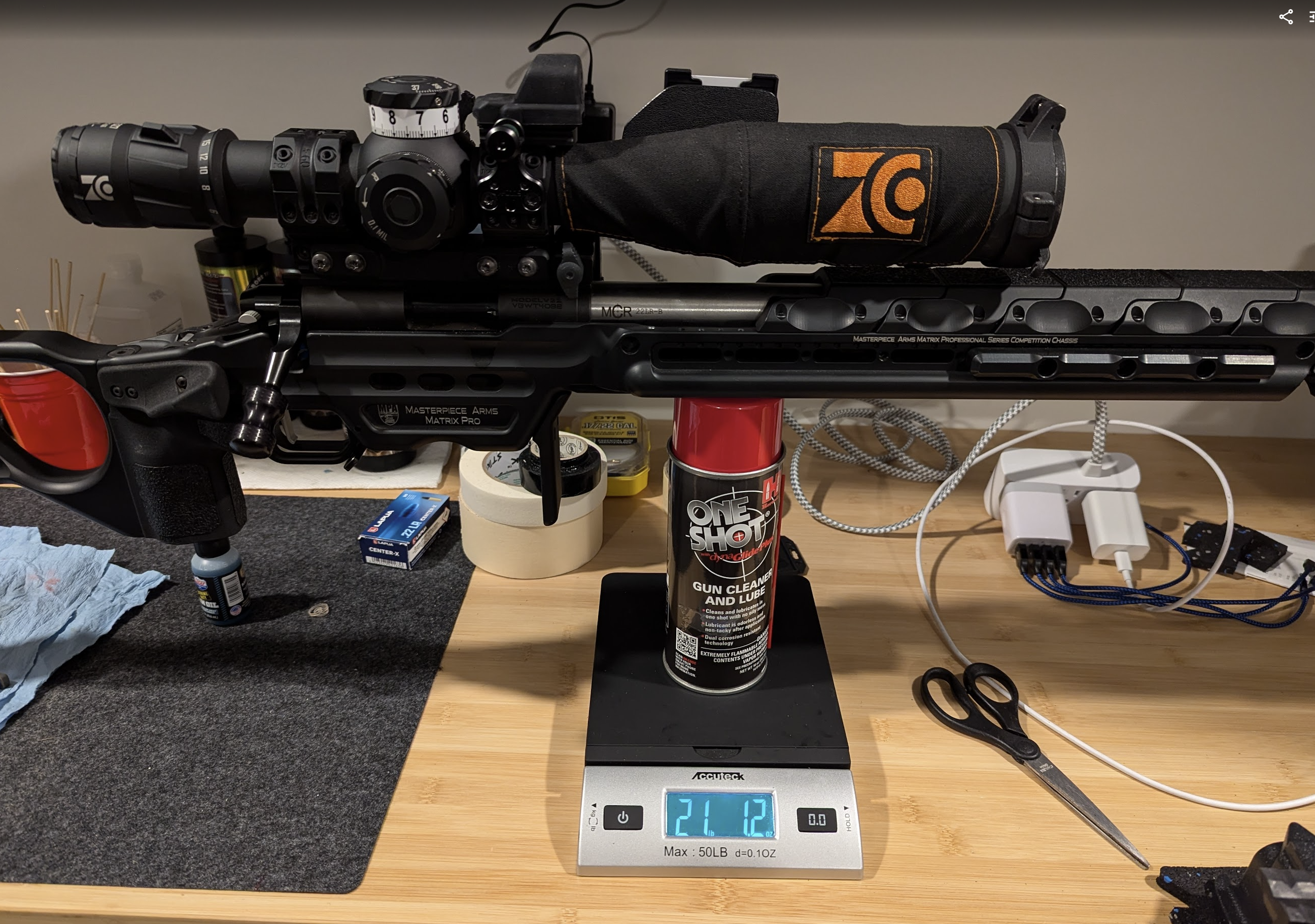

    I love the matrix but would hate to need a 25+ lbs gun to get a balance
    My mdt ACC had two external and full internal weights to balance a 20” Vudoo just in front of the mag well. So that’s still a option as well

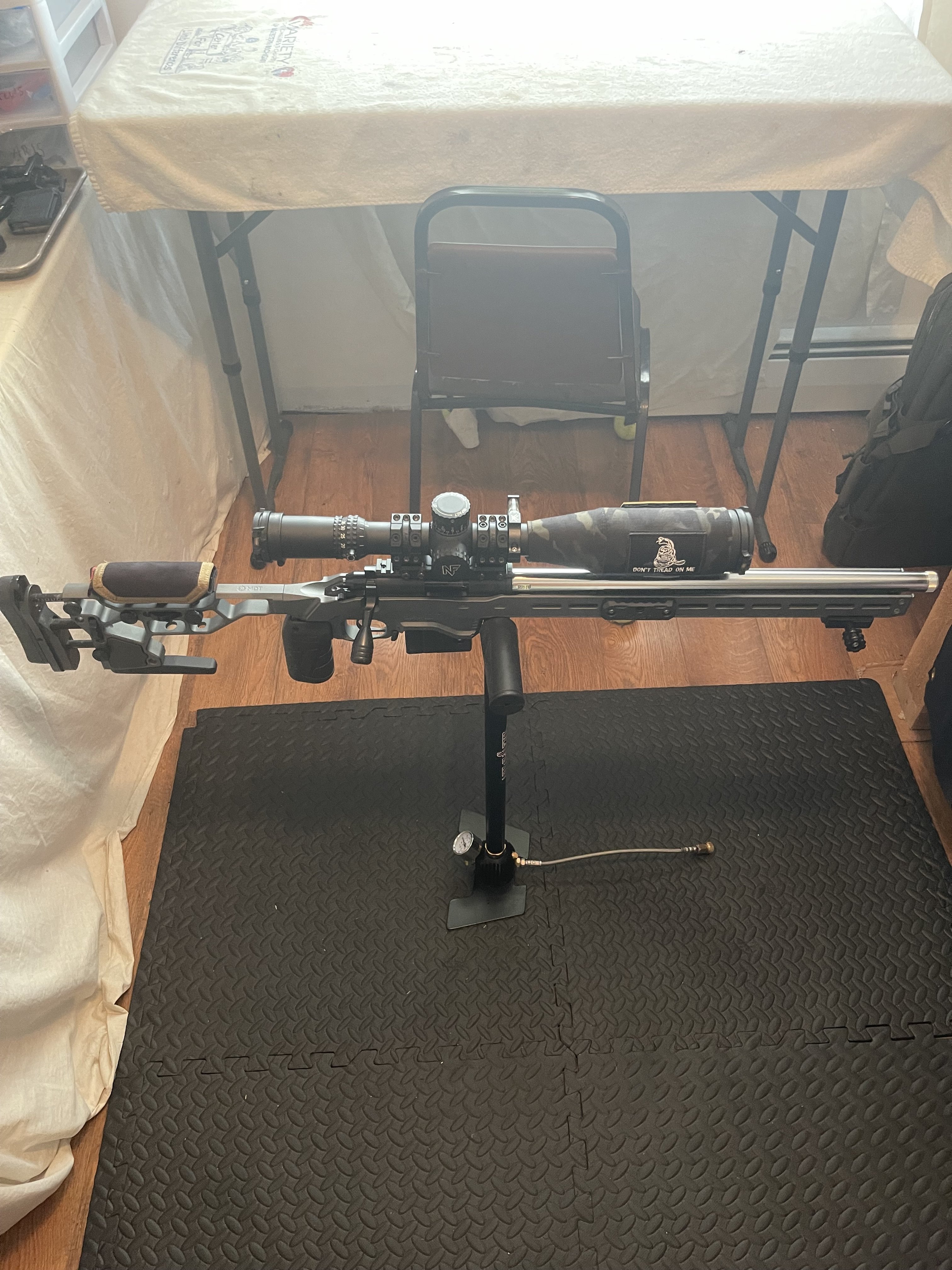

    This is my Vudoo I used to own with a similar 20” profile barrel as what I’ll be using. Balancing in front of mag well on the handle of an air pump
    That MPA came with the weight. I haven’t messed with it. With a bipod on the front it’s a bit rear heavy yet but with my griffin can I was running it balance well.
    I’m going to run without cans as well. But leaving weight on for the balance suppressed. If I get another MPA comp for the second rifle I may just move the weight to that setup as it would match up with a 20” heavy about perfect
