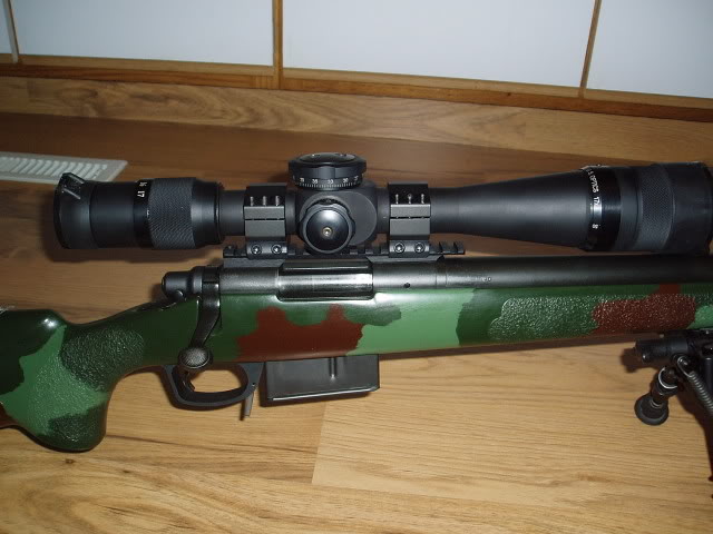

Here is an old pic from probably 20 years ago of a USO SN-3 and I think those are 1" height rings. No issues with it. That is a 20 MOA base but the small distance in height shouldn't be an issue.

Thanks for the assistance Rob. I don't know if it will change your assessment, but the tube on the ST-10 is 30mm, and the Eye Bell part of the scope is where the bolt handle travels, and that is a little less than 44mm. Regardless, from your information, it appears my idea on the 24mm -.94 Low M-Brace Rings will work.
Yeah 30 vs 34 doesn't matter much for that as it's centerline anyways. The ocular area in your scope is no larger than that SN17 scope in the pic as I have had an ST10 also. All those USO oculars were about the same size meaning large. At least the ST10 doesn't have a power ring.
