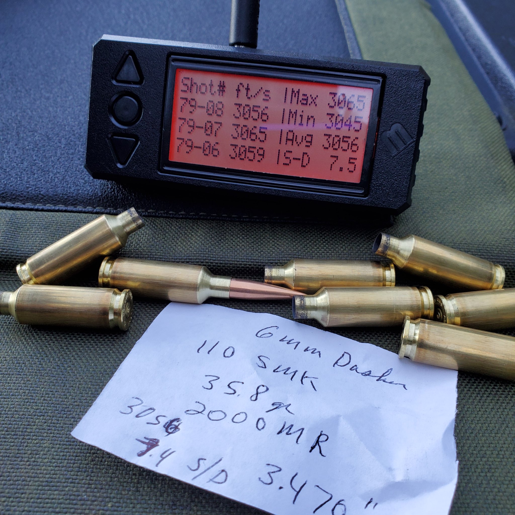

you're saying you got 3085 fps with a 110 smk out of a dasher?
ok what barrel length and reamer specs and powder charge pray tell because that is bonafied creedmoor speed, and you are living dangerously(or lying)
I can *barely* top that with a 28" barrel, my secret squirrel lapua creedmoor reamer, aggressive gain twist bartlein, 13 grains more powder and a high risk tolerance.

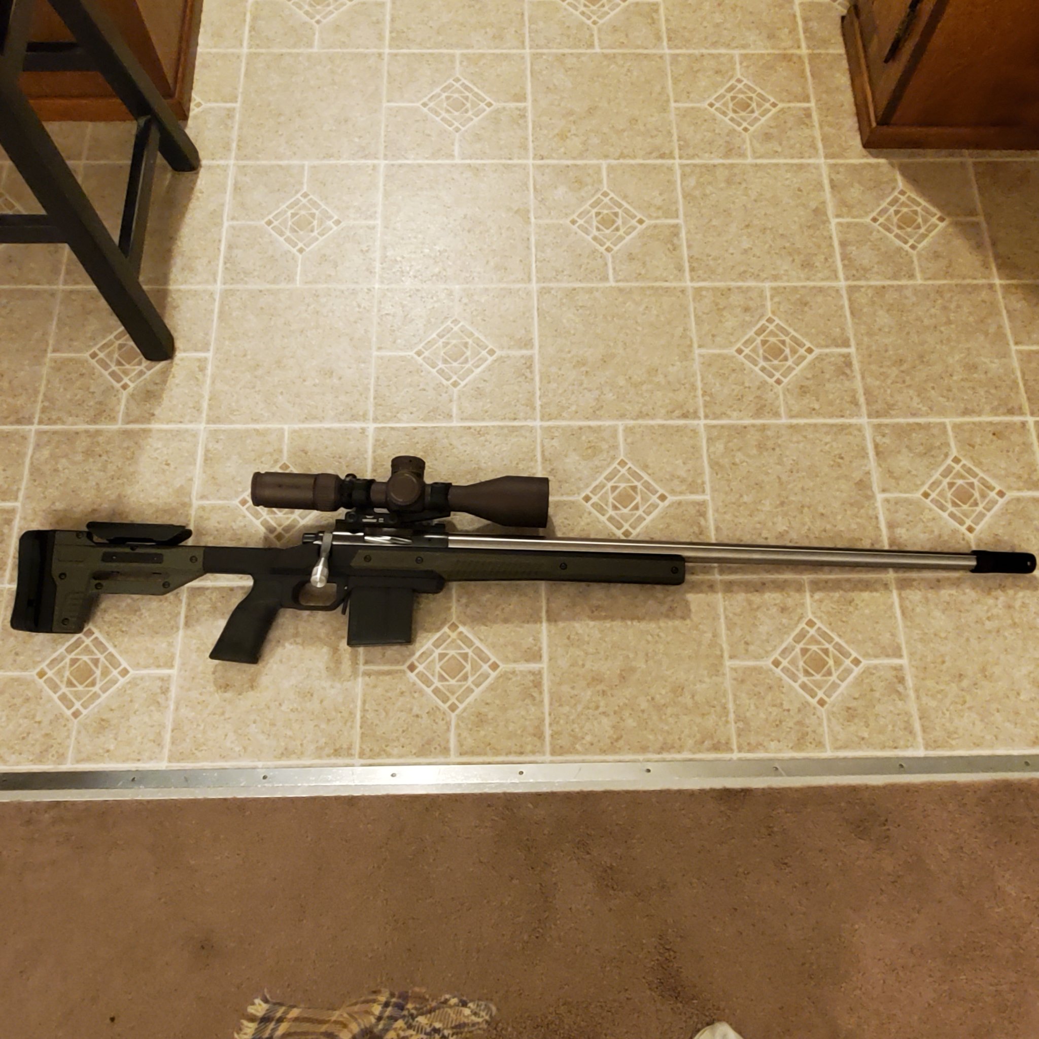

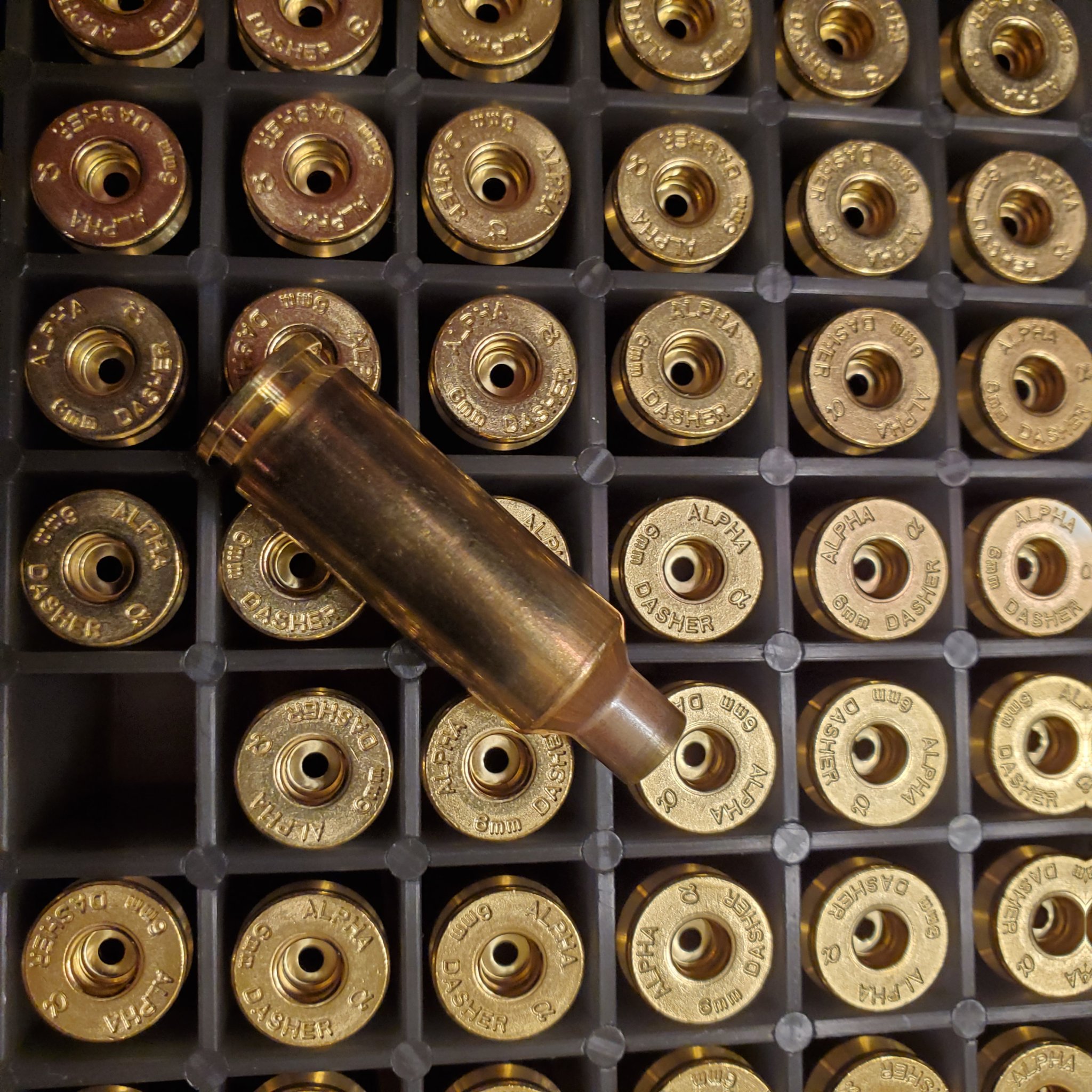

It's a 28" barrel, as one can see the rest on the blank when I chambered it.
It's a standard Orginal 6 Dasher reamer .272" neck 104" Freeborn.
Alpha brass.
It shoots 110 SMK to 3098 fps, and
115 gr DTAC at 3044 fps in ladder tests.
The 110 SMK at 3085 fps is an excellent load.
And 58 Vmax at 4100 fps, for varmints.
Plus the standard Varget and RL 15 loads.
The most accurate rifle I own.
Typical comnent...it's out performing your cartridge with a larger case capacity, so it can't be happening.
The lying comment shows, anger, cartridge prejudice, and character...
Some people may want to learn, others not so much...
The 6 mm Dasher is IMO the most efficient 6 mm case...I could have chosen any case I want, but it's the best for accuracy and performance, combination...IMO.

What powder and charge are you running to hit those speeds? My 26” dasher pushing 112 match burners is flattening primers around mid 2800’s with stabal 6.5
he's running it over 37 grains of fairy dust.
seriously, kids probably using a 20$ chronograph and measured 1 round.
I have no idea but this at the face of it sounds completely made up.

I’m with ya. Just curious what he is using. If it’s legit it’s got to be a fast burning powder way over pressure. At least from my experience.
Probably running 75,000 psi and hard primers to keep it together.
I've seen f class guys run the 6s hot. I have never seen anyone claim 3000fps with a Dasher and 110 class bullets. What's the secrete sauce?

Yes one can shoot 110 past 3050 fps or 107 to 3140 fps in the 6 Dasher...but I also shoot standard loads of 2970 to 3020 fps for my super accurate 108 gr Berger loads.
So a similar load was used in competition for awhile, by a shooter over on Accurate Shooter, a few yrs back with Berger bullets i believe.
It is temrature sensitive and my not be your cup of tea...but it shot a 10 shot ladder test into less than half inch...so here's the load data to the undeserving unbelievers, for that load.
Many just plain asses on this site, yours is always better, no one does that, it's impossible...I present information, from experimentation, what you do with it, is up to you.
Then you show them, they still won't accept any of it, ...must be lots of brain washed democrats, LOL.
So this is for the few who actually want to know, and see if it will work for them, very few,... so it's for them.
I have changed to a less temrature sensitive powder and got even slightly higher velocities, which I'm shooting here, the 110 grs at 3085 fps average.
It's quiet on the heavy steel, have to listen.
All that's left is the jacket base, below the steel. The 6 mm Dasher is so easy, no recoil, super accurate, no misses, even for me. Even a child could learn to shoot a 6 Dasher, very well
Why I recommend it.
I cheat, and chamber my own rifles, so I'm totally unconcerned about barrel life, and built this one, in one day, starting noon, when the blank arrived, from SPR. Chambering, threading, truing the action, bolt knob, extractor fitting, 4 oz trigger...etc and loaded ammo for it, was out shooting it at noon the next day.
So I build every caliber I'm interested in, spend a lot of time and money experimenting with most everything...
Oh, Remington 7 1/2 primers and Alpha brass is what I use exclusively.
The End...

I still don't believe you're not over pressure at 3100fps.
So, I posted one load for those few interested, and you non believers who refuse to believe, even when you see it...
Just as I predicted many would do...that's the kind of folks many of you are, here.
Go up and look at the 4 attachments.l on my post..there is your answer...already posted...for 1 load...110 SMK with empty 6 mm dasher cases and one loaded one,
With average velocity of 3056 fps for the 110 SMK. The 3085 fps load is a different powder for the 110 gr SMK...and goes 3044 for the 115 DTAC.
Ya don't even read it, yet criticize, and throw childish tantrums,... typical.

Excellent factory 6 Dasher brass is available from Alpha Munitions....no fire forming necessarily. That's a thing of the past, and it's capable of taking pressure.
Its what the pros use today.
There is a video on Ultimate Reloader, "Don't Do This At Home." 308 making 300 WM velocity.
They ran the brass with a BAT action to way over pressure several times, something like 96,000 psi...go check it out.
This ain't yesterday, there are new and better options. So ya have good factory brass for the 6 Dasher, just like all the rest, 6 BRA, 6GT, or 6 BR. Your choice...enjoy.
