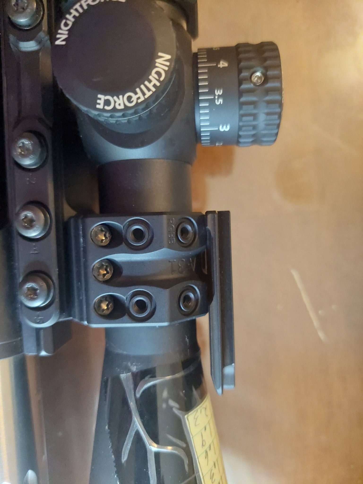

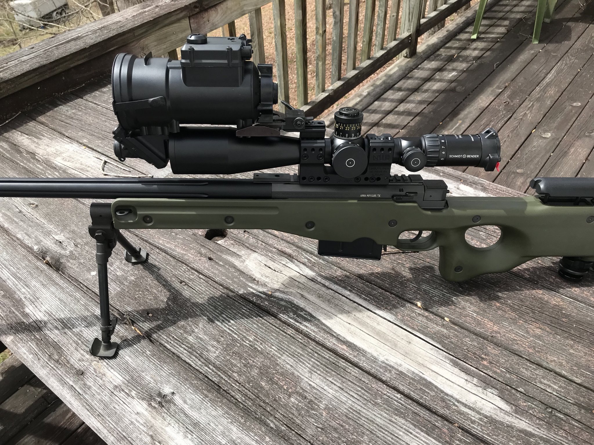

Realistically I'll do 99% of my shooting in daytime, but I want to use my Simrad with this rifle. I strongly believe that glass quality is more important than magnification, so I'm willing to sacrifice on that. I know the easy option would be to get an inline clip on, but I can't justify the expense and my Simrad looks amazing at max magnification through my scope. If I remove the stray light shield I have about 5.3" to work with between the output lens and the latch. I've included some pictures to show what I'm talking about:

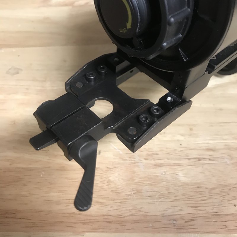

As you can see in the first picture the stray light shield sort of fits. I need to remove it, but there is a tiny stripped allen screw that I haven't gotten around to getting out. In the second picture you can see the shoe that the Simrad mounts to. Ideally I'd like to have as much engagement with this shoe as possible. I shamelessly stole Leupold's scope dimensions diagram- the "F" dimension is what I am concerned with most. I do have a 4mm and 10mm spacer, so a bigger objective diameter is not a concern for me.
