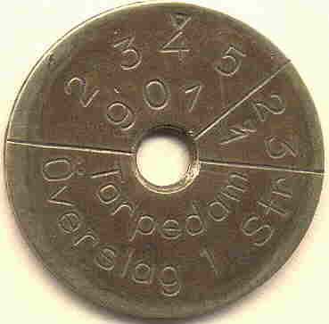

Has the rectangle/U-notch sight; wrist shows a crown and a second crown with what looks like CB under it, which would seem to be Karlsborg Tygstation. Inspector's initials are O.G., for what that may be worth. Bore disc... Little pie slice has the mark over "1", which indicates bore condition was very good once upon a time; big pie slice has the mark over "9", which... indicates the barrel ID is somewhat looser than 6.5mm?
There should be two bore diameter numbers in that sector of the disk...starting with 6,51 and 6,46...I am assuming that it is 6.59. Should still shoot well, especially with M41 ball.

Negative, the 6,51/6,46 are not there. Only (like so, underline instead of triangle tick mark)
Top row: 2 3 4 5
Bottom row: 9 0 1
This style (not my pic, mine has no number in the torpedam oeverslag section either):
Of all the parts I can see, the buttplate, rear sight ladder, and the rear sight adjustment button (but NOT the slider itself) have tilted crowns, which by my understanding would indicate they were replaced with parts from Husqvarna.
That looks like an M38 disk... 6.59
