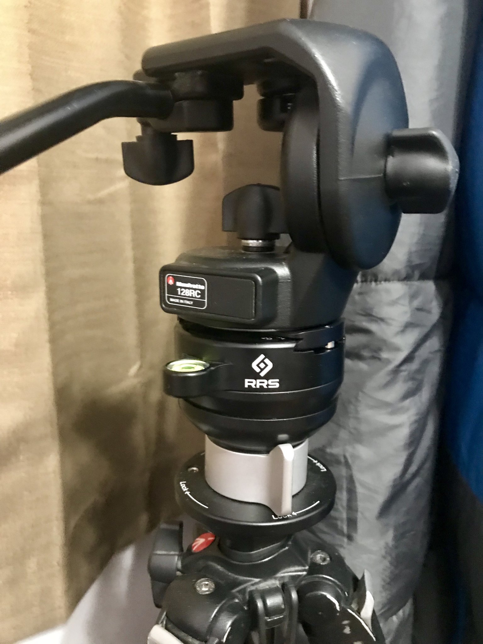

    You can buy a leveling base fro RRS that screws on to your frotto as seen here. I also run a RRS stuff plate on the bottom of my pan head because I prefer to glass in this manner. RRS sales a pic rail adapter that slides right into the leveling base no problem

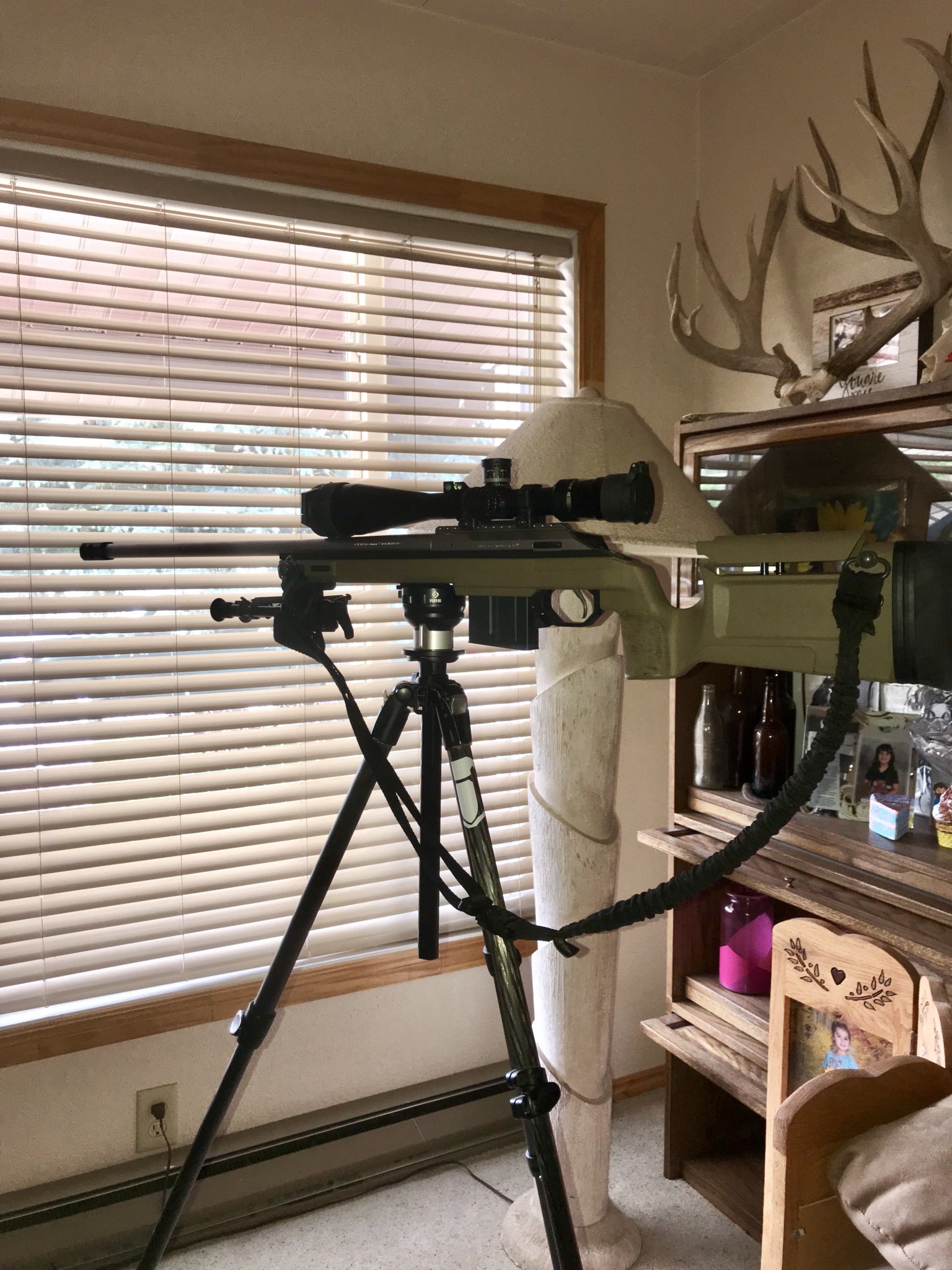

    2. Mounting your rifle is either simple or more complex, depending on your stock. MPA's dovetail rail on their competition chassis drops right into the clamp. For my DTA and AX, I bought the RRS adapter plates, which just bolt on to the chassis and the adapter plate sits in the leveling base clamp. For something like a Manners, you'll need a separate rail drilled into your stock., like this: http://www.area419.com/product/area-419-universal-arca-rail/
