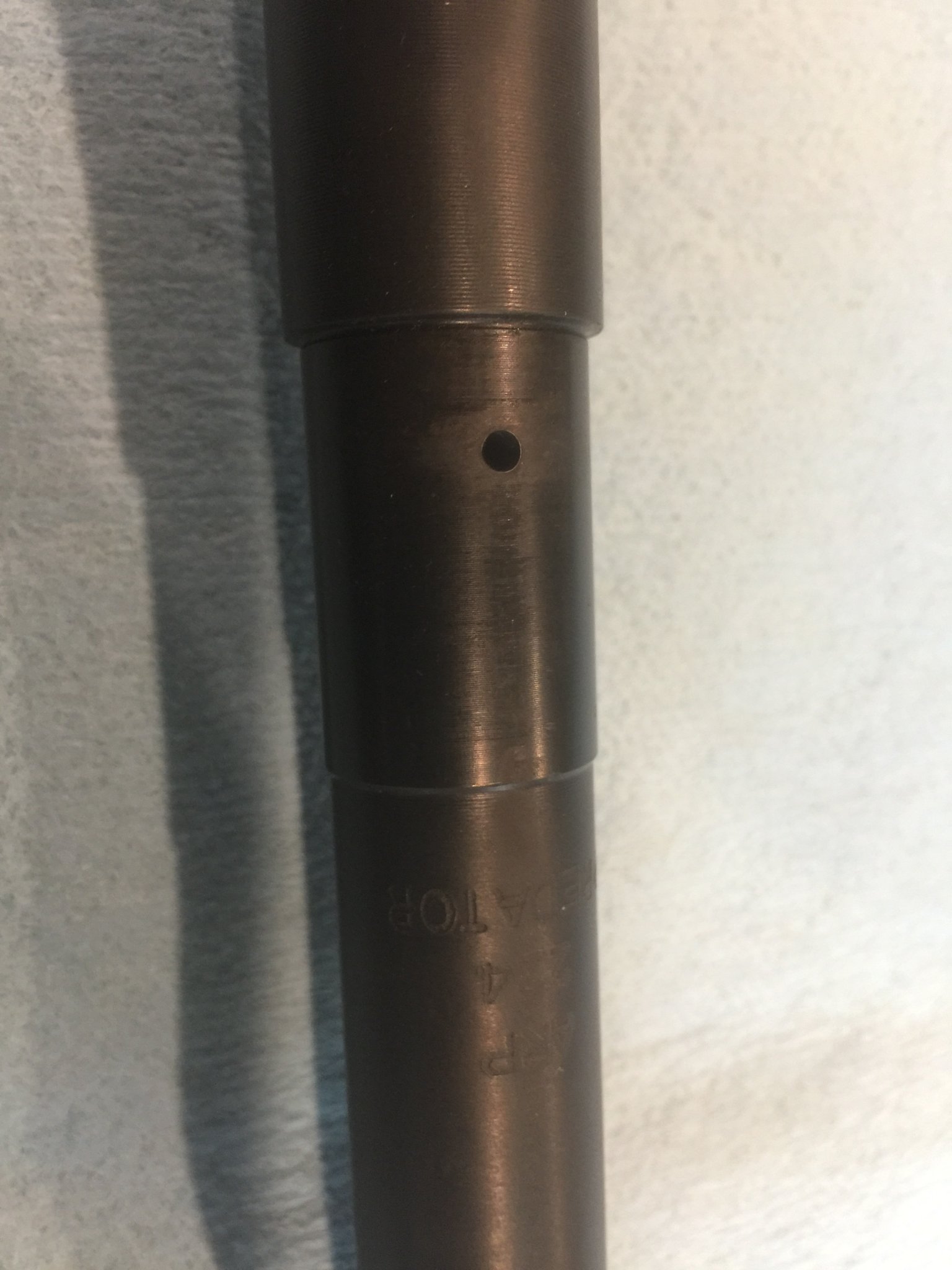

    I took it to the range today for the first time. I had a series of loads made from 26.3 out to past 31 grains of CFE223 behind Hornady 88gr ELDM bullets. With the gas full on, I was getting (nearly) zero happening with the bolt until I got to 28.7gr, where the bolt was moving enough to occasionally eject a case. I never got the rifle to chamber a round, but stopped with a pierced primer (30.2gr). The barrel is melonited so it is a bit difficult to see the carbon from the gas port on the journal, but I am including a picture of it.
    What I hope you can see is carbon at the gas port mostly dispersed laterally and evenly. This would seem to suggest that the block was square over the gas port. What I can also see, but may be difficult in the picture, is a "fan" of carbon that appears to have been sprayed from the adjustment screw on the Odin Works gas block.

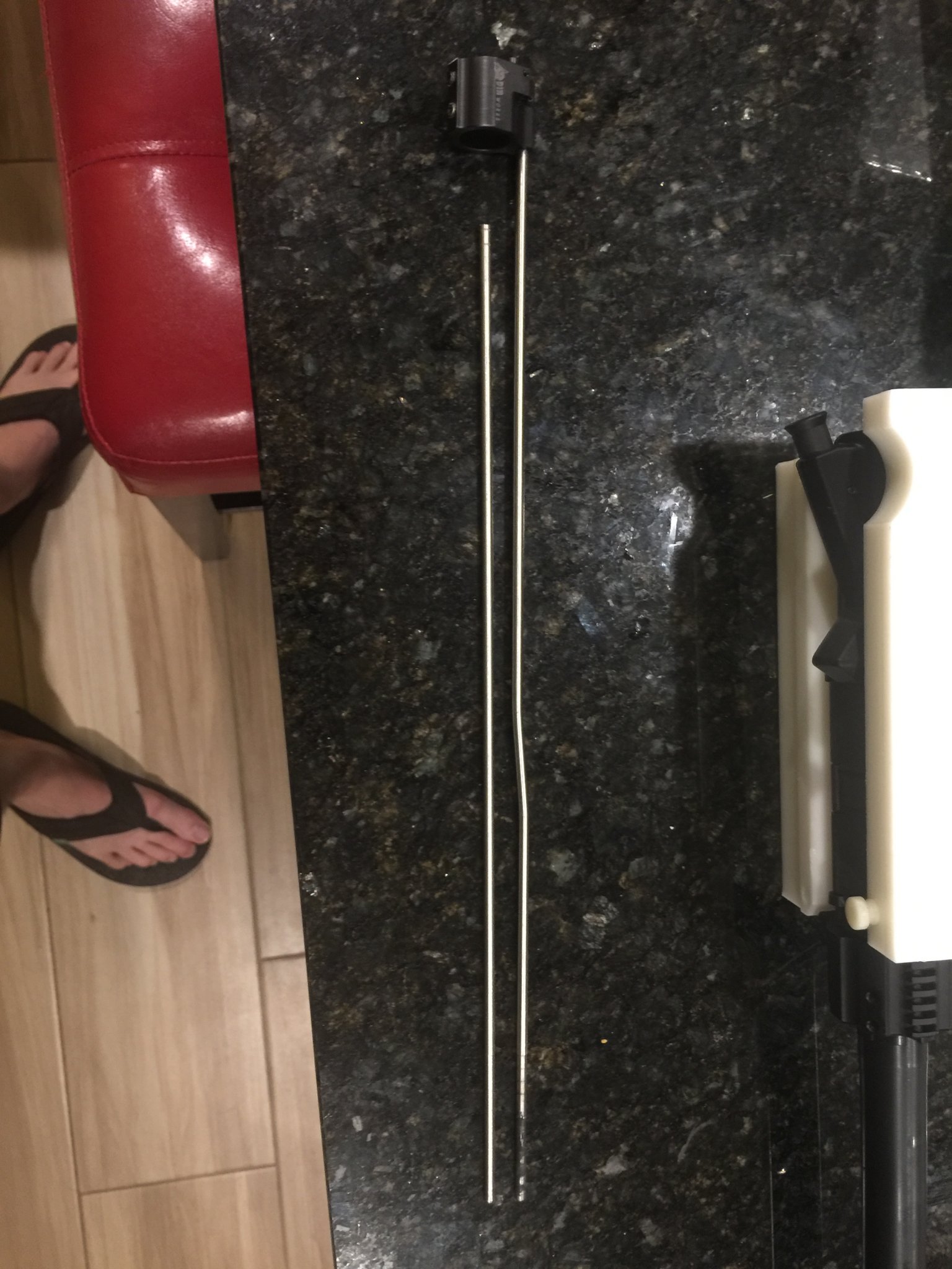

    So if we have that gas block hole over the gas port which from a glance looks good.
    1. Have you used air or pipe cleaner or something to ensure air (gas) can properly pass through that Odin Works gas block to confirm its not faulty inside??
    2. Did you blow air or push a pipe cleaner or something through that +2 gas tube to ensure its not clogged or faulty?
    3. Is it actually a +2 gas tube? or is it too short?
    I don't have a can of compressed air on hand, nor any sufficiently long pipe cleaners. However, I just disassembled the adjustment screw on the gas block. Then I shot some gun scrubber through the gas tube/block assembly. It appears to run freely through both.
    See 1.
    Yes, it is a +2 gas tube. It was packaged with the barrel from AR15 performance. I also have a rifle length tube on hand and it is shorter than the tube on this gun.
    What size is the gas port? It doesn't look wildly undersized in the pic for what thats worth.
    0.096"

    .096 seems plenty sizeable. New BCG? If used I'd check gas key tightness and gas rings. Like padom said check all the various holes for flow.
    0.096" for a +2, 22" should allow for gas adjustment.
